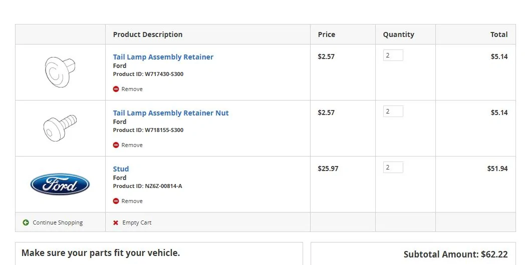

I also found this on Ford OEM parts:
Ford Maverick Tail Light Issue 1746714880556-xj
Comes out to $62.22 per tail light. So over $120 for the set. So still a bit steep. I think I'm going to get a quote from the Dealer/see if its covered in my extended warranty. If not. I'll probably just 3M tape it and call it a day.
$120 still expensive but $488 less than the quote i got from the parts department.
