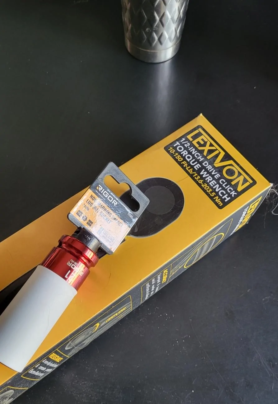

Good reminder, much appreciated. I have been putting this off. It is now on my list. My understanding is the lug nuts torque is 110 pounds?
Nope, its 150 foot-pounds, same as the F150 with the same size studs.

RE: 150 ft lb = THX and OMG, that is even worse than I thought. No wonder people are writing that the pathetic lug wrench included with the truck is unsuitable.

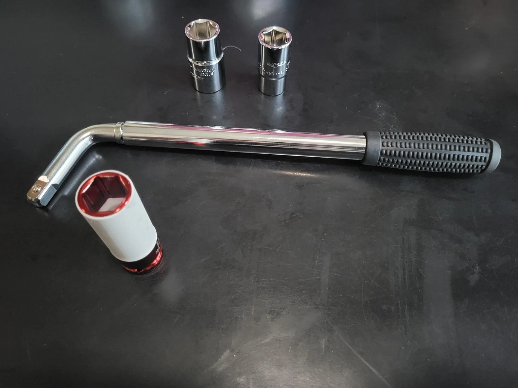

Having gone thru this scenario of learning the spare tire removal process prior to an actual tire failure. Decided to utilize the large plastic bag to store the failed tire/rim rather than damage the finish on the rim by cranking it under the bed.
The provided scissor type jack is adequate for most surfaces, but recommend a short length of 2x6 to serve as a jack platform on soft surfaces. Ensure the jack slots into the body flange to avoid damage.
Definitely obtain a folding, traditional lug nut wrench or better yet a dedicated socket and breaker bar with a 6” extension for the lug nuts. The provided lug wrench may provide an unneeded challenge to some folks.

More great advice especially about having a breaker bar for the lug nuts. Easy to forget that most shops use an air impact wrench on those lug nuts and they can be hard to loosen with a conventional lug nut wrench.
