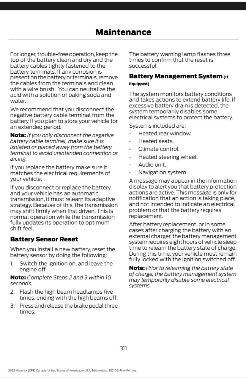

In the mean time I charged my battery with a trickle charger, bypassing the BCM (directly on the posts; I know this is NOT recommended) and then reset the BCM following the procedures in the manual. Ignition on with engine off, flash high beams 5 times and then press brake pedal 3 times within 2 minutes. Saw the battery light flash on the dash confirming BCM reset. Time will tell how much, if any that helps.
Do you flash 5 times or high to low 5 times, ending in low? Just flashing is like a warning to other drivers or low high low high 5 times? Confusing!
I flashed 5 times, like warning to other drivers. I have attached the process directly from the owners manual for clarification.
I should have been more clear on the steps.
But # 2 says ‘ending in off’, if you just flash it automatically goes to off, doesn’t stay on high. 😩
