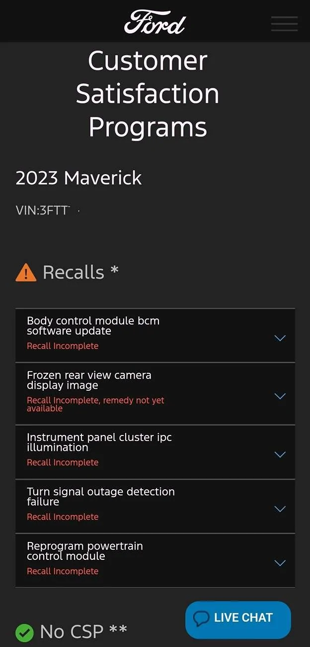

Either my 2023 hybrid isn't included in this recall or it hasn't been loaded to the Ford recall page yet:
Ford Maverick Recall: 25S02 12V BATTERY INSPECTION Screenshot_20250123_090619_Brave~2
I've already replaced the battery with a Diehard Gold in June 2024. I got tired of the seemingly random battery saver events and dead battery. I wasn't going to wait for Ford to keep the truck for a few days, "fix" it (ie., charge the crappy Motorcraft battery and reset the BMS), then give it back just so it continues to happen. I don't have time to play their ridiculous dealer games.
And yes, I know I haven't had any of the recalls performed. All the issues people had after the PCM reprogram gave me pause as I had an 80 mile per day commute and I didn't want the truck dying on the 80mph interstate. I'll get them performed eventually.
