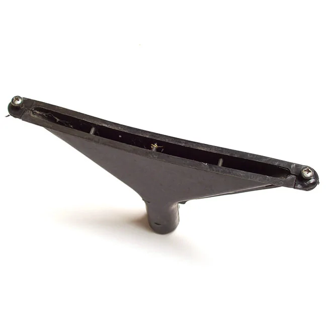

My dash noise may be coming from the front windshield defroster vent. It is noticeable when going over bumps. If I put my fingers in the vent outlet, it seems to stabilize the vent and the noise quits. It probably looks like this.

I brought to the dealer and did basically nothing. Said no issue and can't repeat. sigh I have recording of everytime this happens.
Took my wife out and she said that it's not so much as a rattle like a bean in the dash but more like vibration of metal/plastic or metal/metal or something.. Maybe it's true that there should be some something soft between in the dash or somewhere to minimize the vibration. ahh driving me crazy
