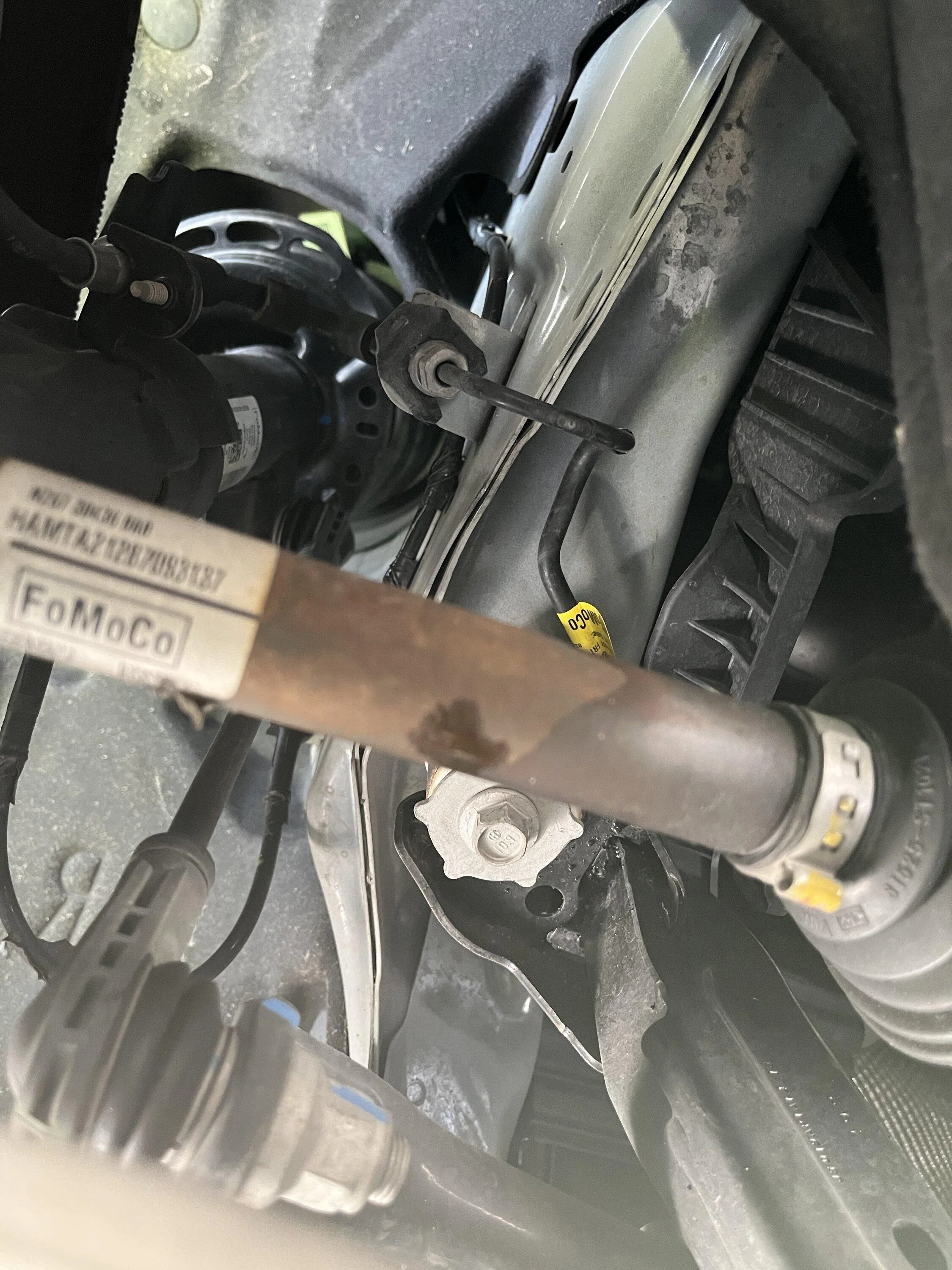

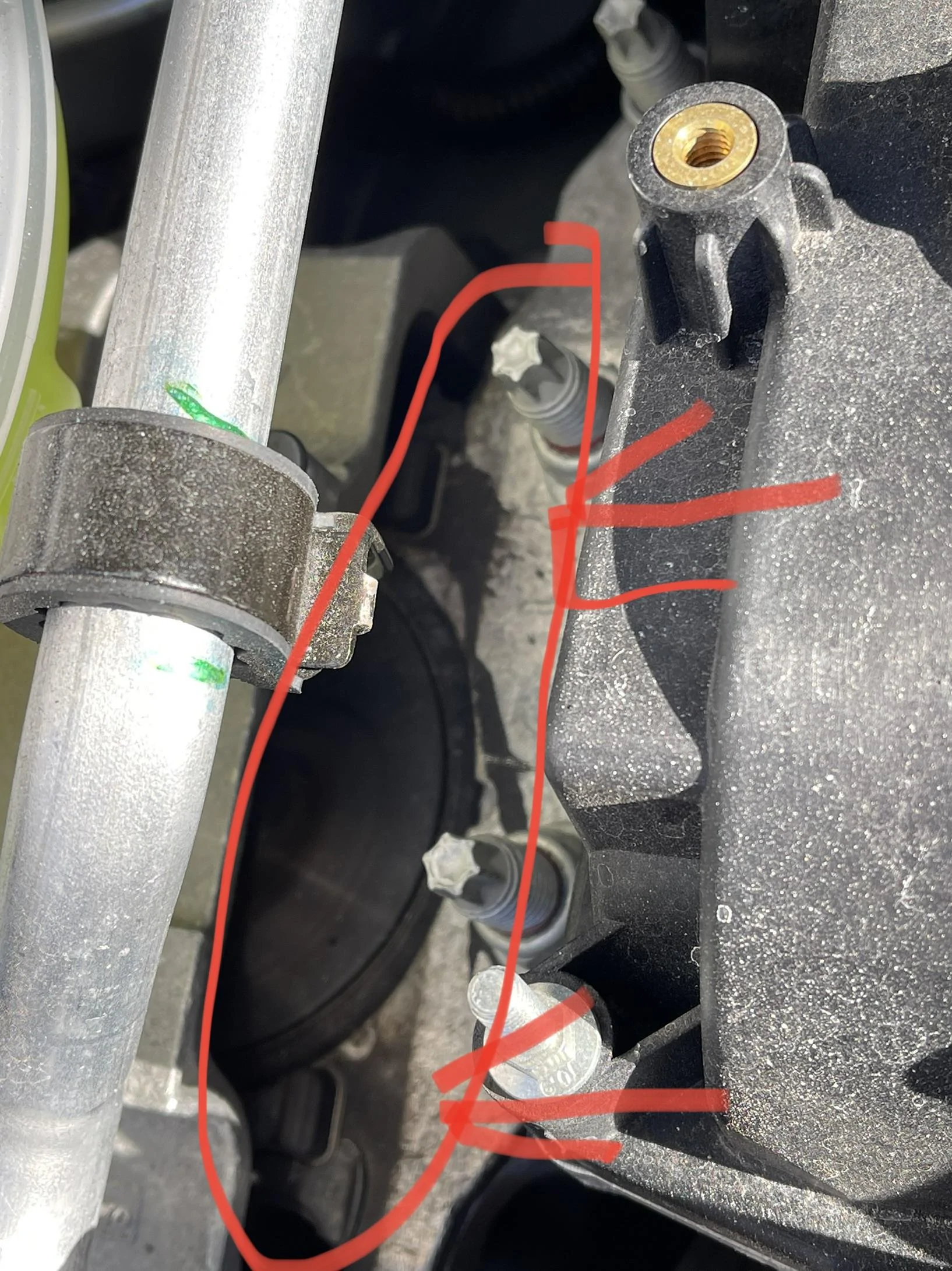

Agreed!! Also, I will try to post my one engine mount! They said back when I bought it, it’s fine, just monitor. But my one mount looks bad !! Just a few pics of issues… however it’s hard to see in the mount picture. But it’s got all kind of gunk all over the rubber and metal area(s) who knows.
Ford Maverick Rattle in the dash (a minor yet major annoyance) D53F17C8-0D20-41CD-8631-4DE98ED0B12E
Ford Maverick Rattle in the dash (a minor yet major annoyance) 2F55F5AF-2B75-4C15-A282-07EDA0D9E1C1
Ford Maverick Rattle in the dash (a minor yet major annoyance) E18E341E-A839-4CA5-9F3E-6FCE0A8FEE44
Ford Maverick Rattle in the dash (a minor yet major annoyance) E91DD0EB-C390-4800-995D-326FEB7F4F43
