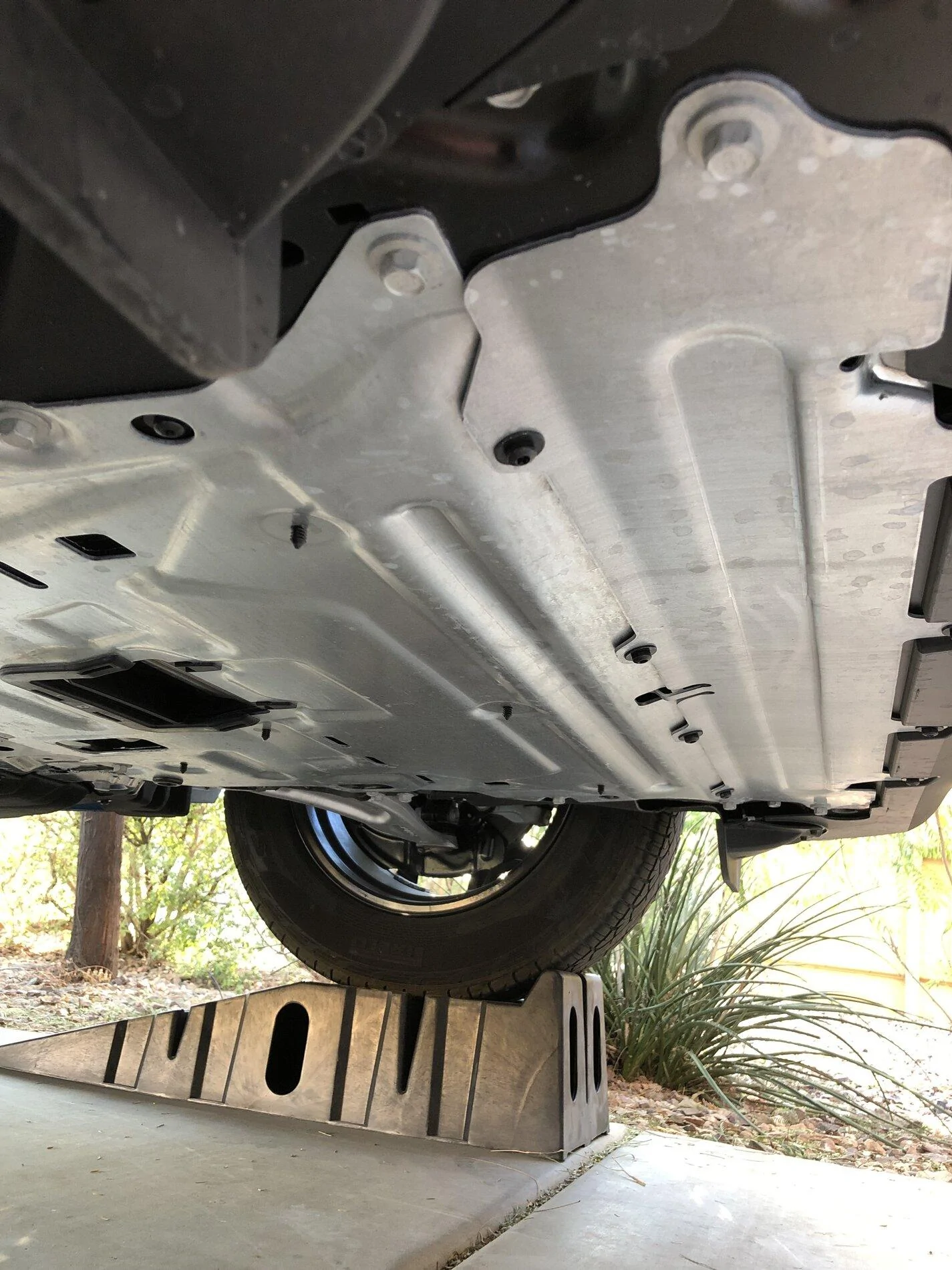

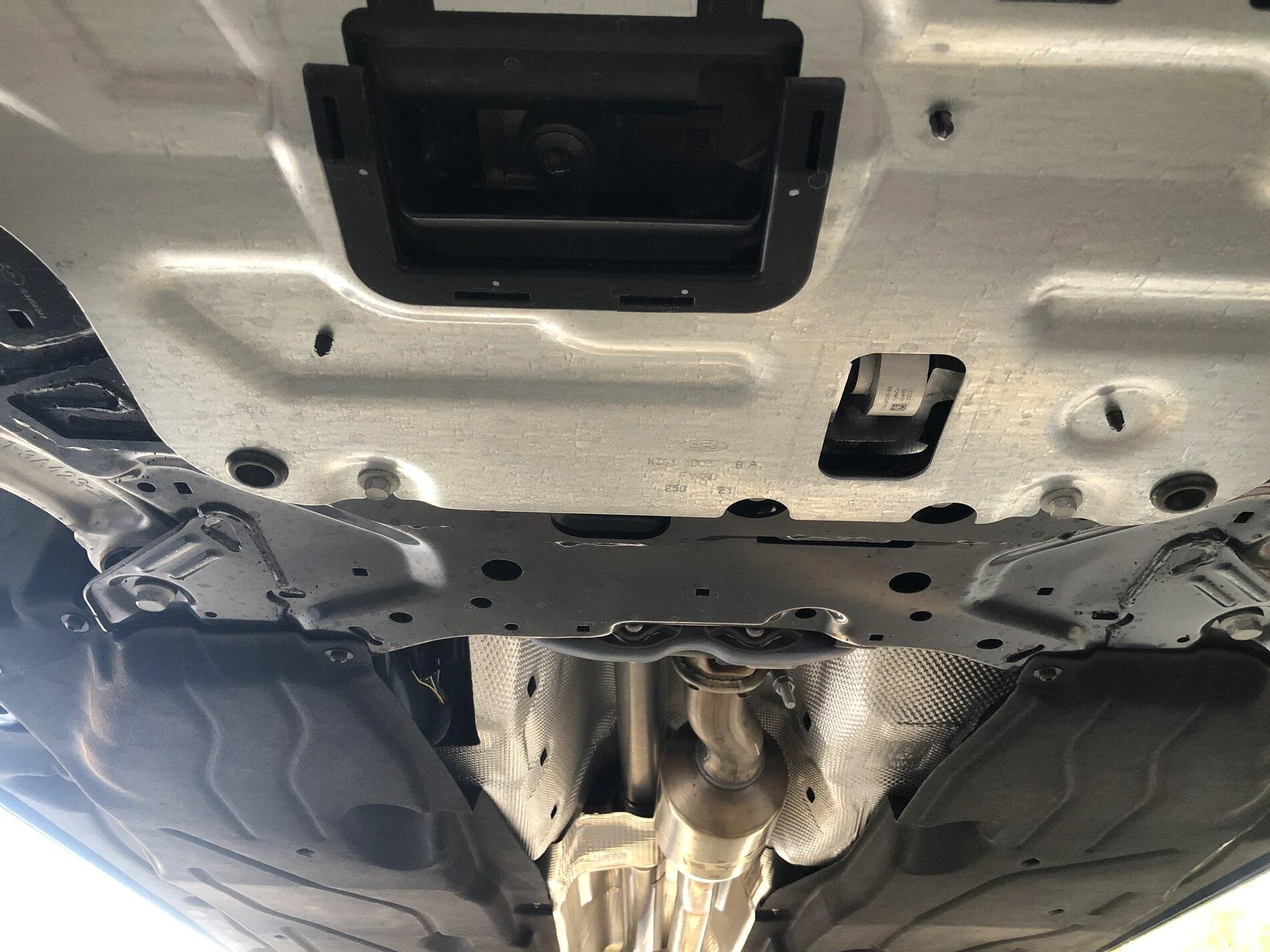

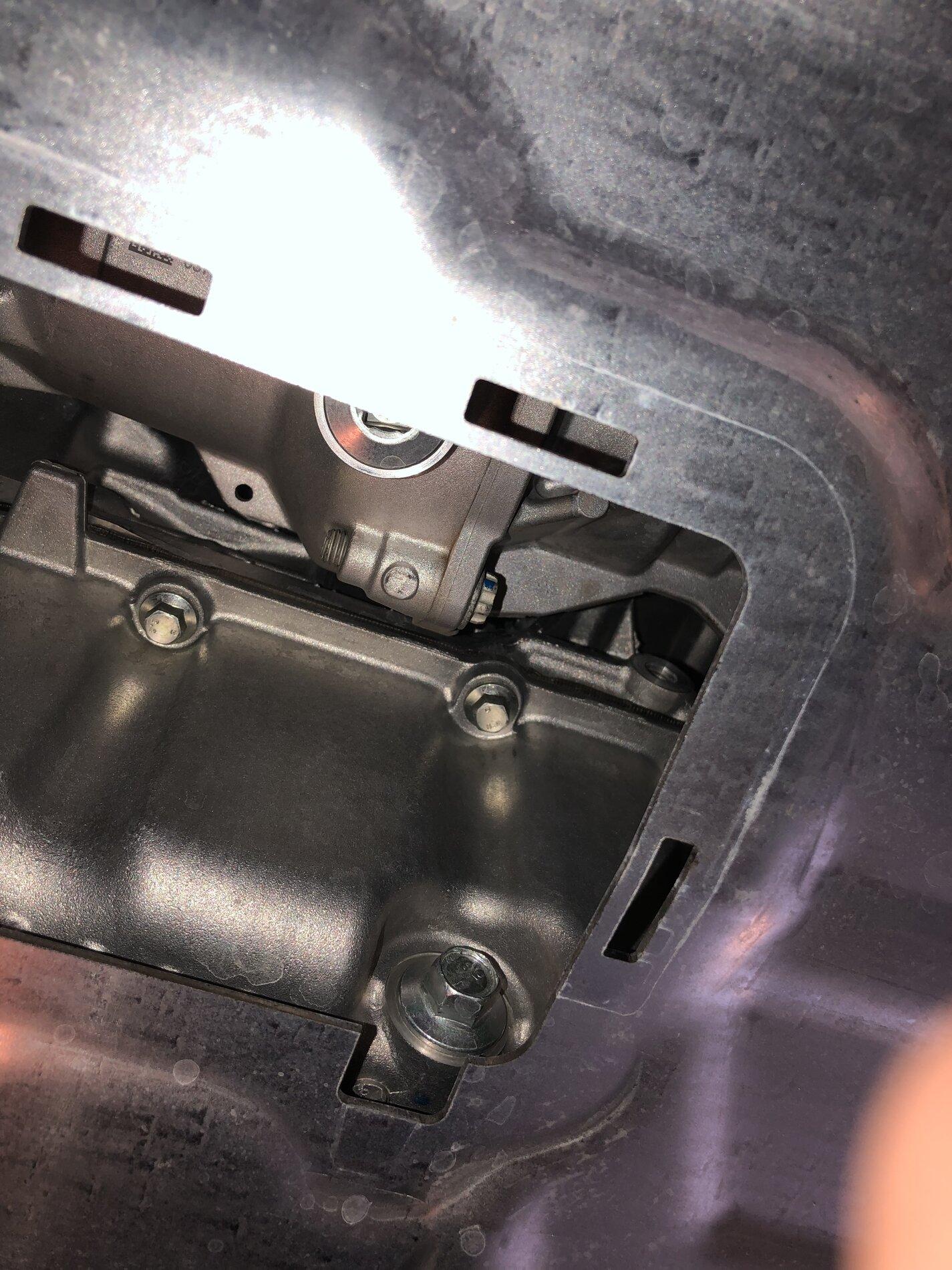

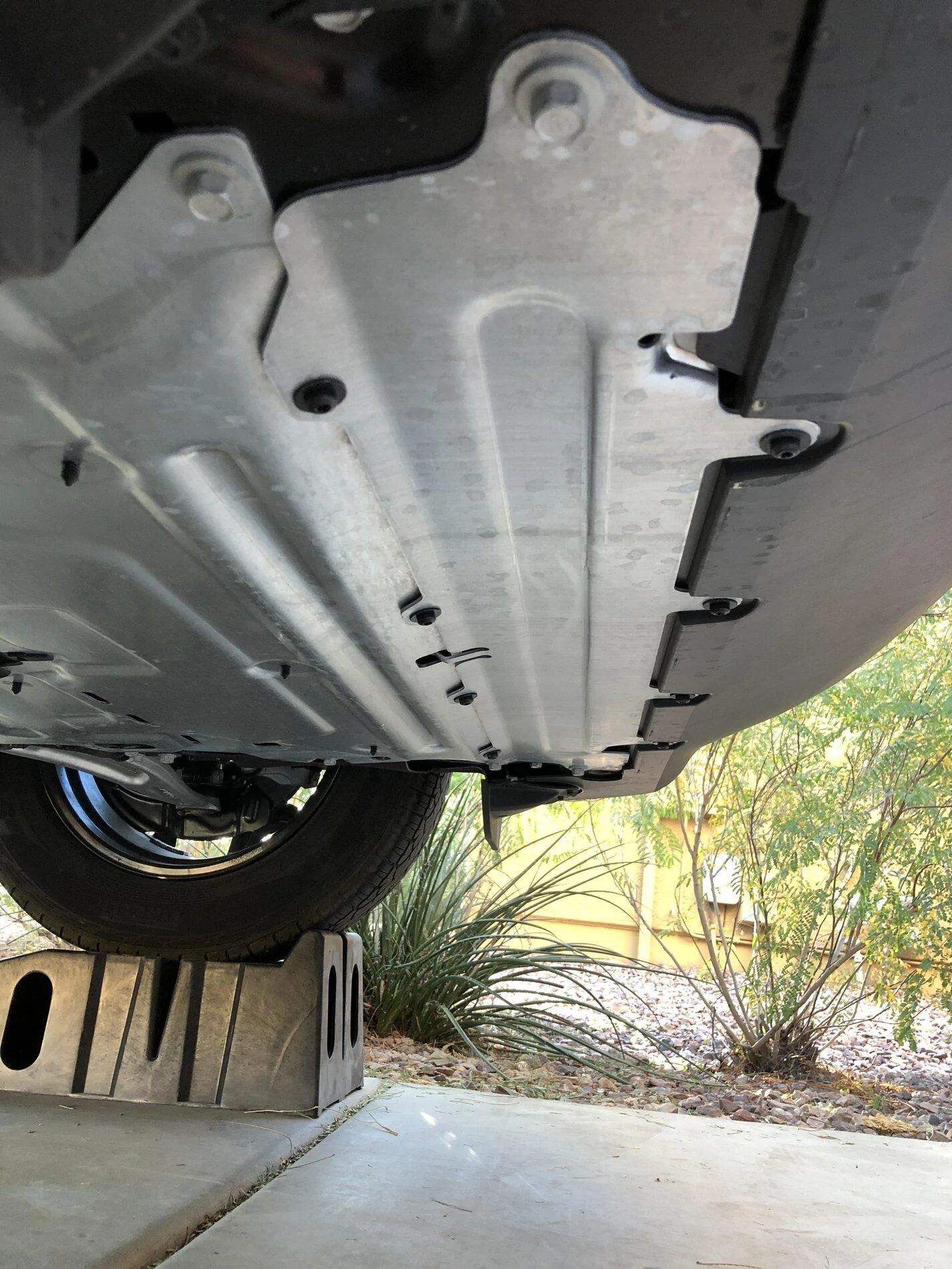

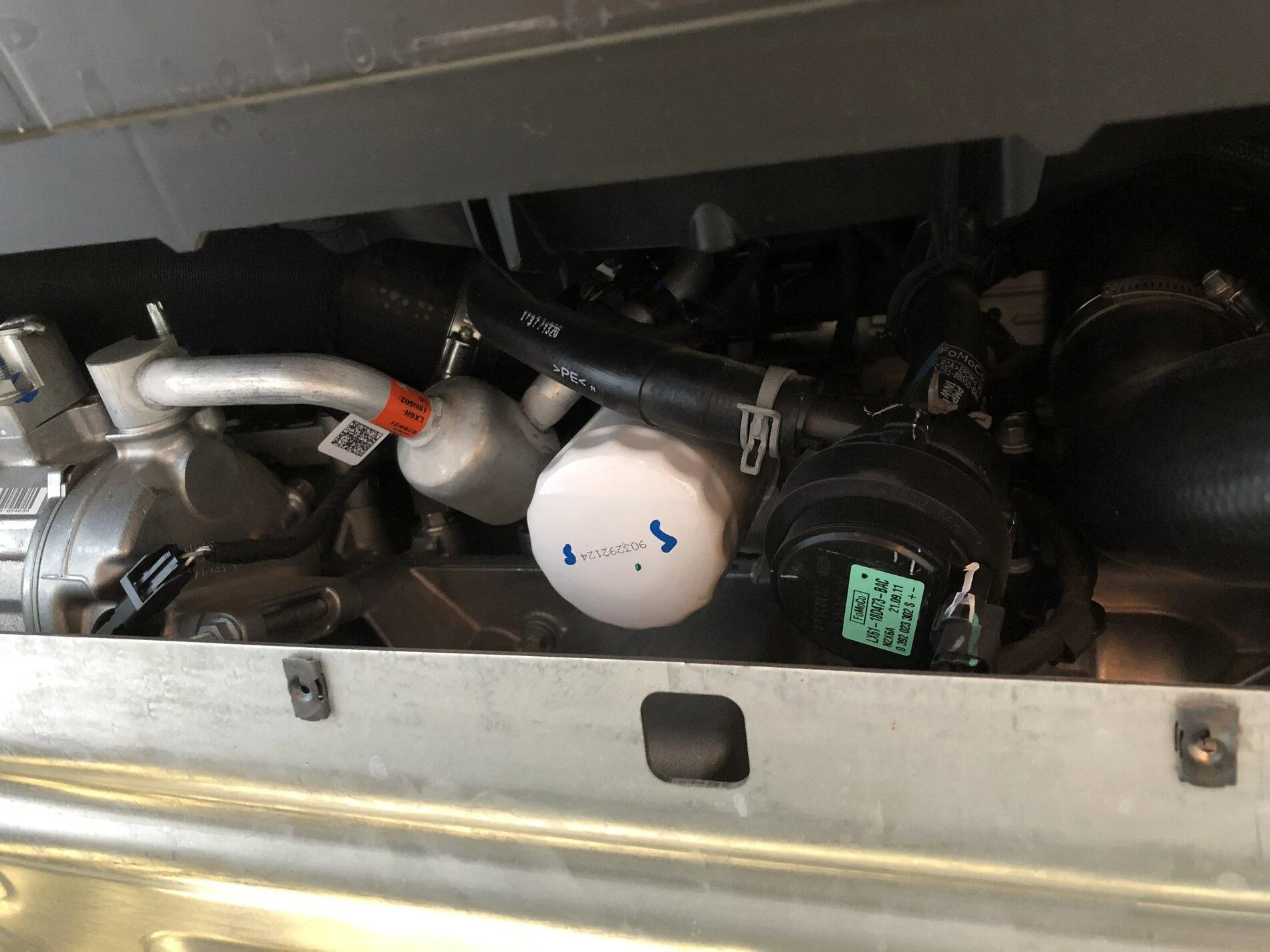

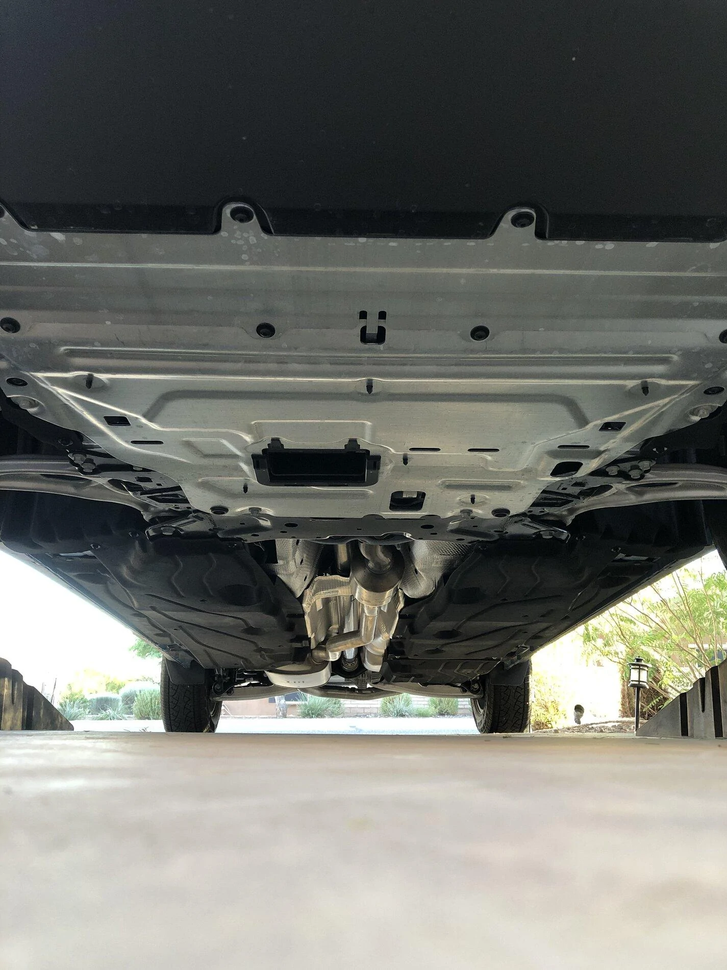

Updated with photos of skid plates that need removal for an oil change - posted by @thunaman (link to post)
Ok Gents, I have taken delivery of my FX4 Maverick today, I can confirm you will need to remove a panel that runs the full width of the truck, and about 6-8” “deep” from the bumper to the main skid plate. The rest of the skid plate is a single piece that covers the rest of the engine bay -- see photos below.
As you can see there is a large panel on the front you need to remove to get to the filter. and a small plastic air scoop (transmission cooling?) in the middle you need to remove to get to the drain plug
All in it took me about 10 min to remove, take pix and replace.
