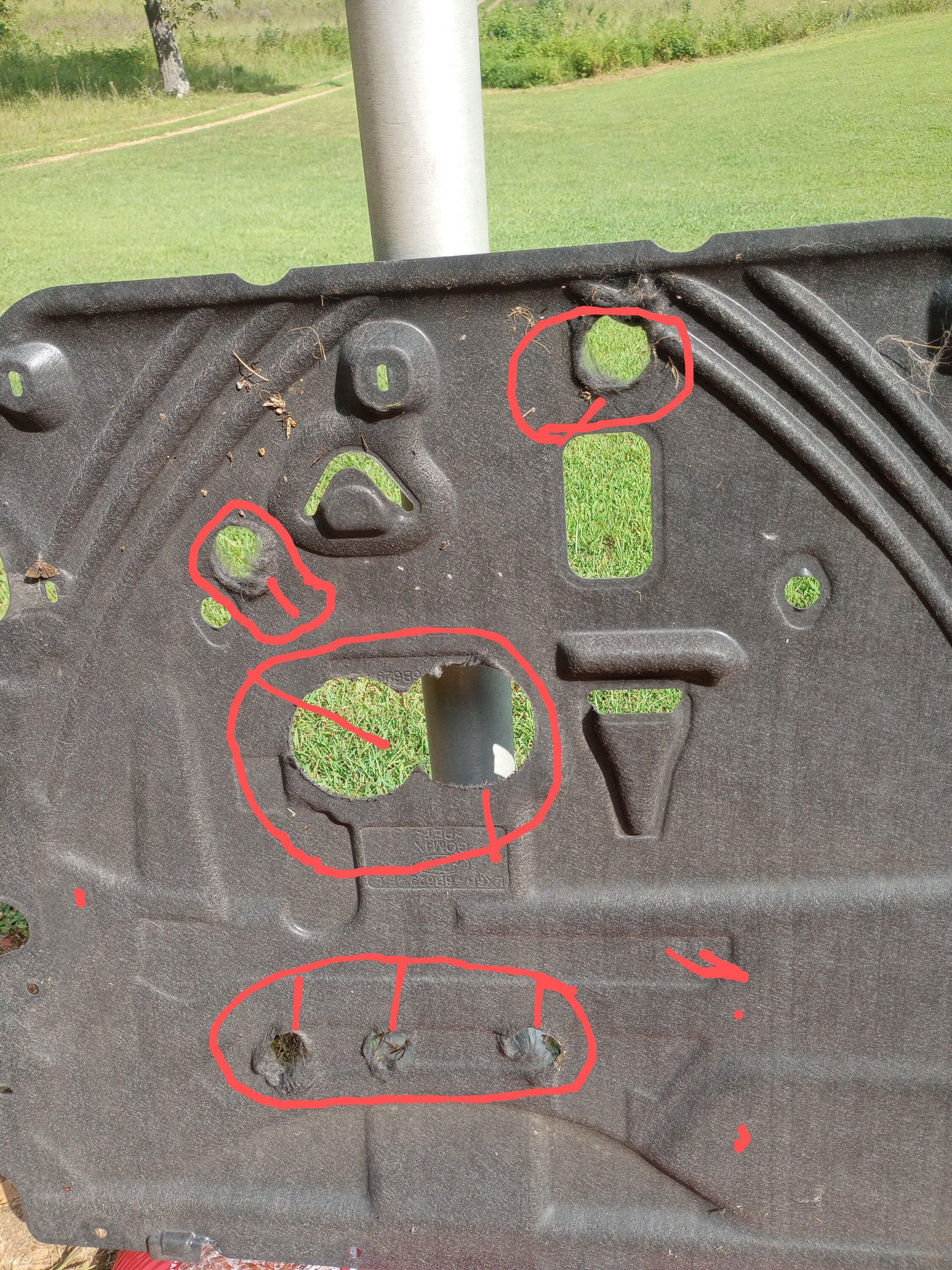

It's just a cover and made out of some kind of fiber and burns very easy . My MacBook was one of the recalls for heat and fire problem. The butcher my cover how to clean it up myself cut out some pieces bad places clean out a bunch of weeds that one on the top of it very very poor job of this recall. Is very easy to take off just unlocked of screws. See pics also do you have to remove it to change your oil filter and oil.
