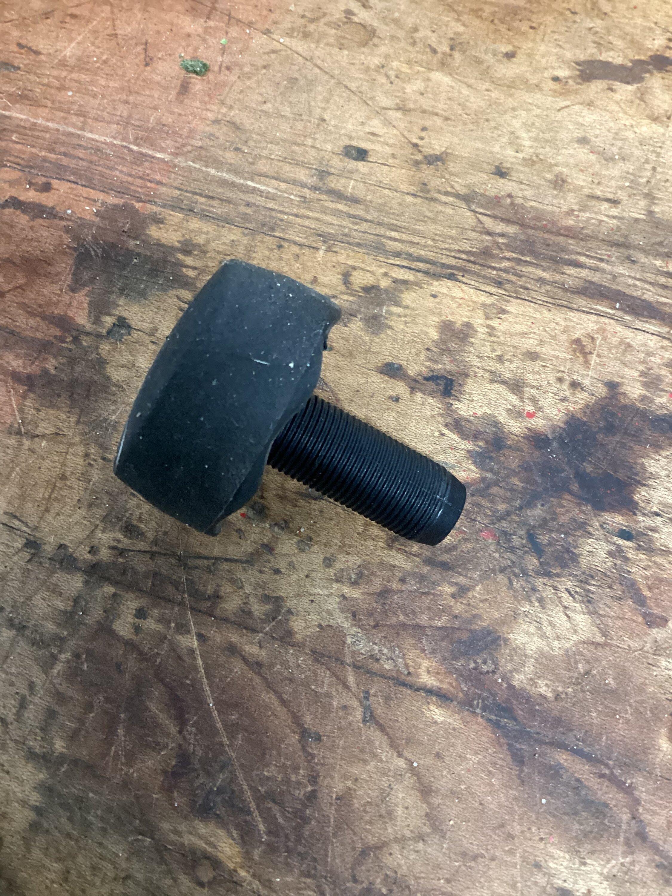

I agree with the OP. I changed the oil and filter today and after taking o
the front skid plate off and looking at the filter, I decided it would be easier and cleaner to take out a few more bolts and remove the whole skid plate. It was much easier to change both oil and filter. I also found a hood adjuster loose on top of the skid plate that I had no idea was on it.
Ford Maverick Oil change on FX4 REALLY requires skid plate removal (heed the PSA!) 2A401EFE-BFB0-4B93-BF17-545DD895CF49
BTW I have 2033 miles on my first oil change and plan on changing at 5000 miles in the future.
