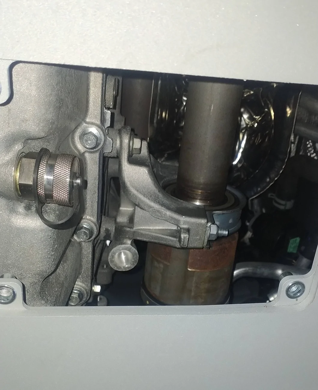

At the time of my first oil change, I installed the Valvo max drain plug system and the Rival skid plate.

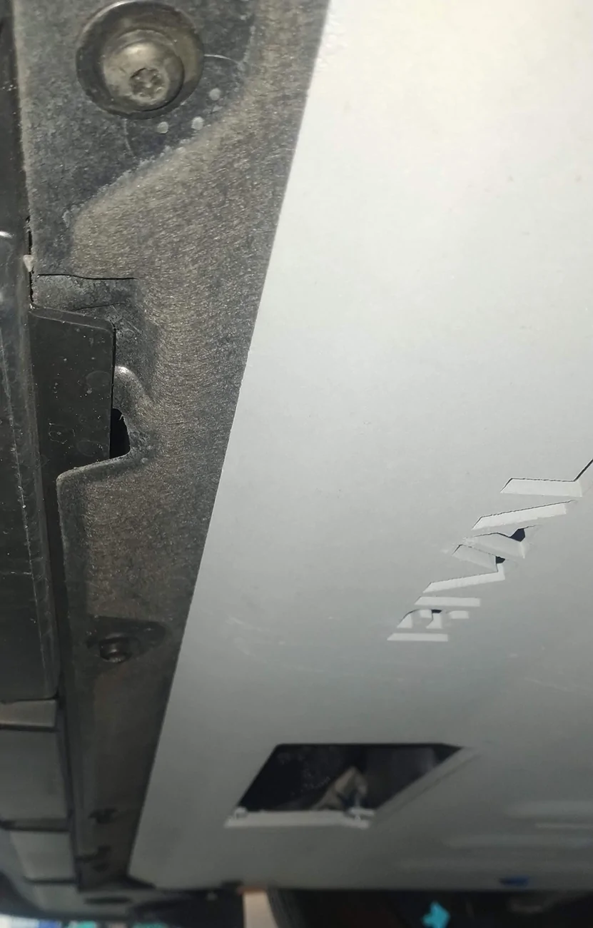

I didn't like the way the front of the Rival left an open area, and the 4 screws looked odd not being used.
I cut a section from the front of the factory panel, and installed it to cover that opening.

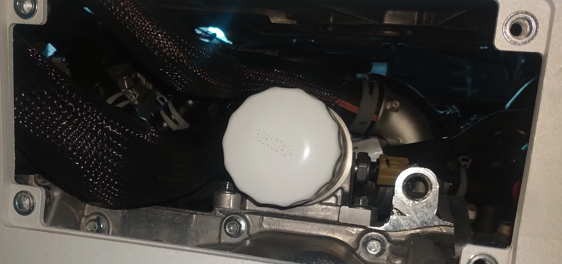

The openings in the Rival plate leaves a lot of room to access the oil filter and the drain valve.

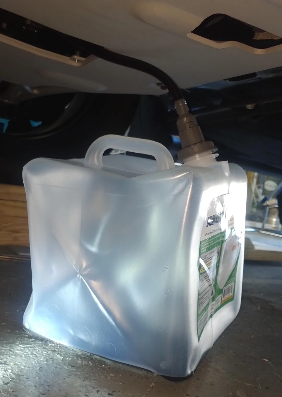

First time using the plastic container to drain the oil in, worked good.
I can dispose of the oil at work.
Made the oil change relatively easy, with no mess.
Used the 'red solo cup' method for the oil filter, and put it in a cut open milk jug for the trip to work .
