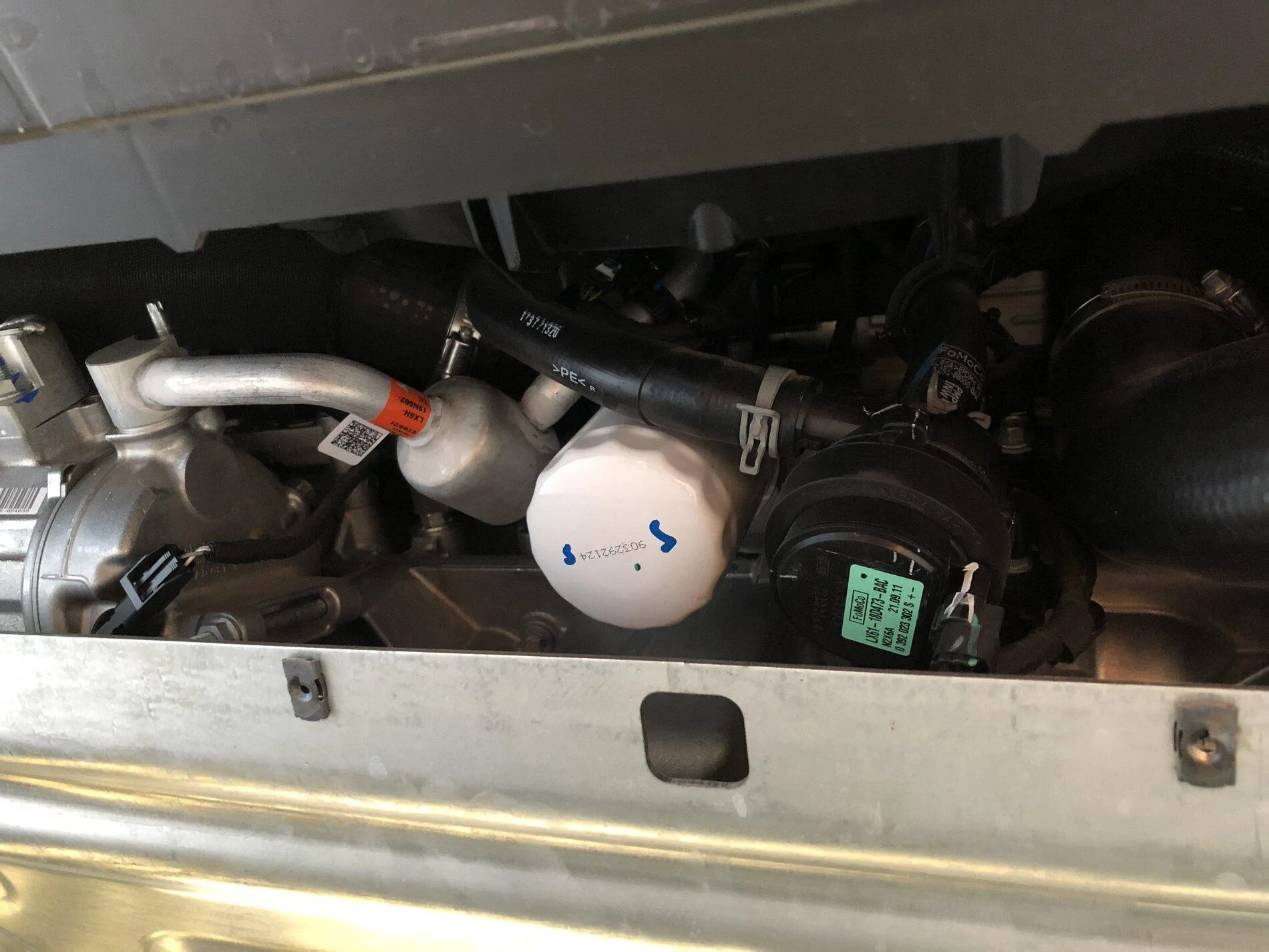

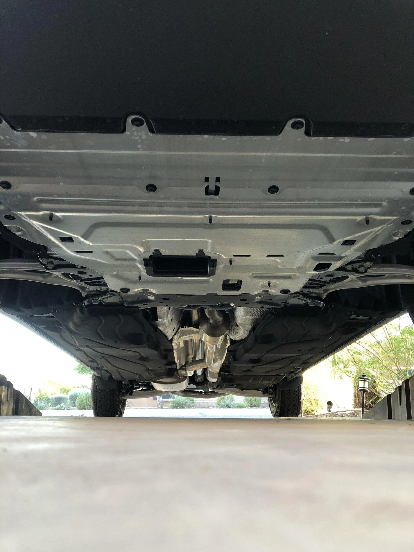

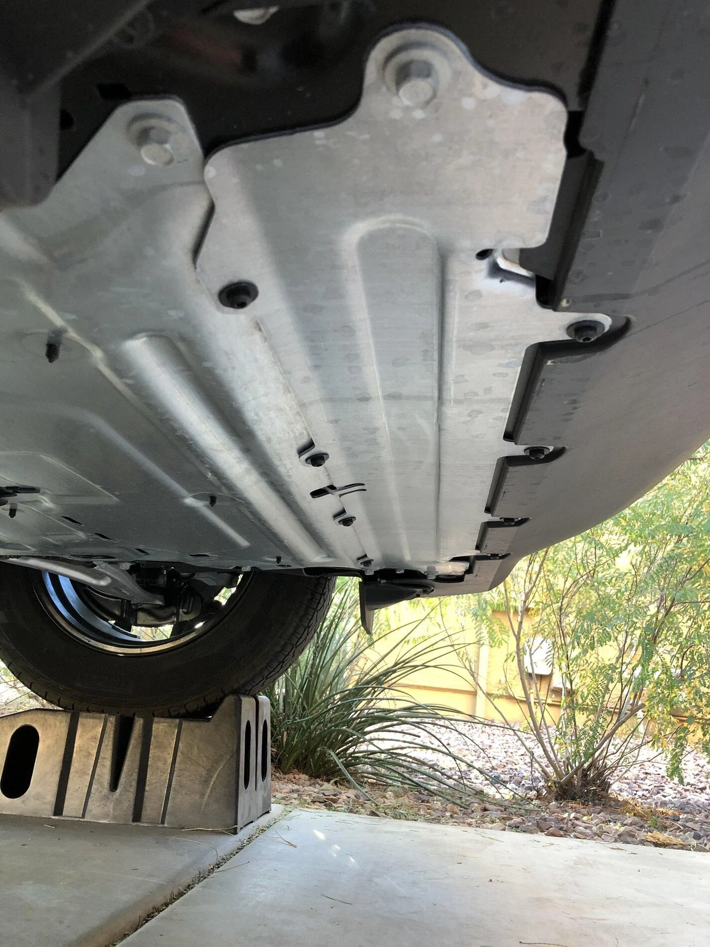

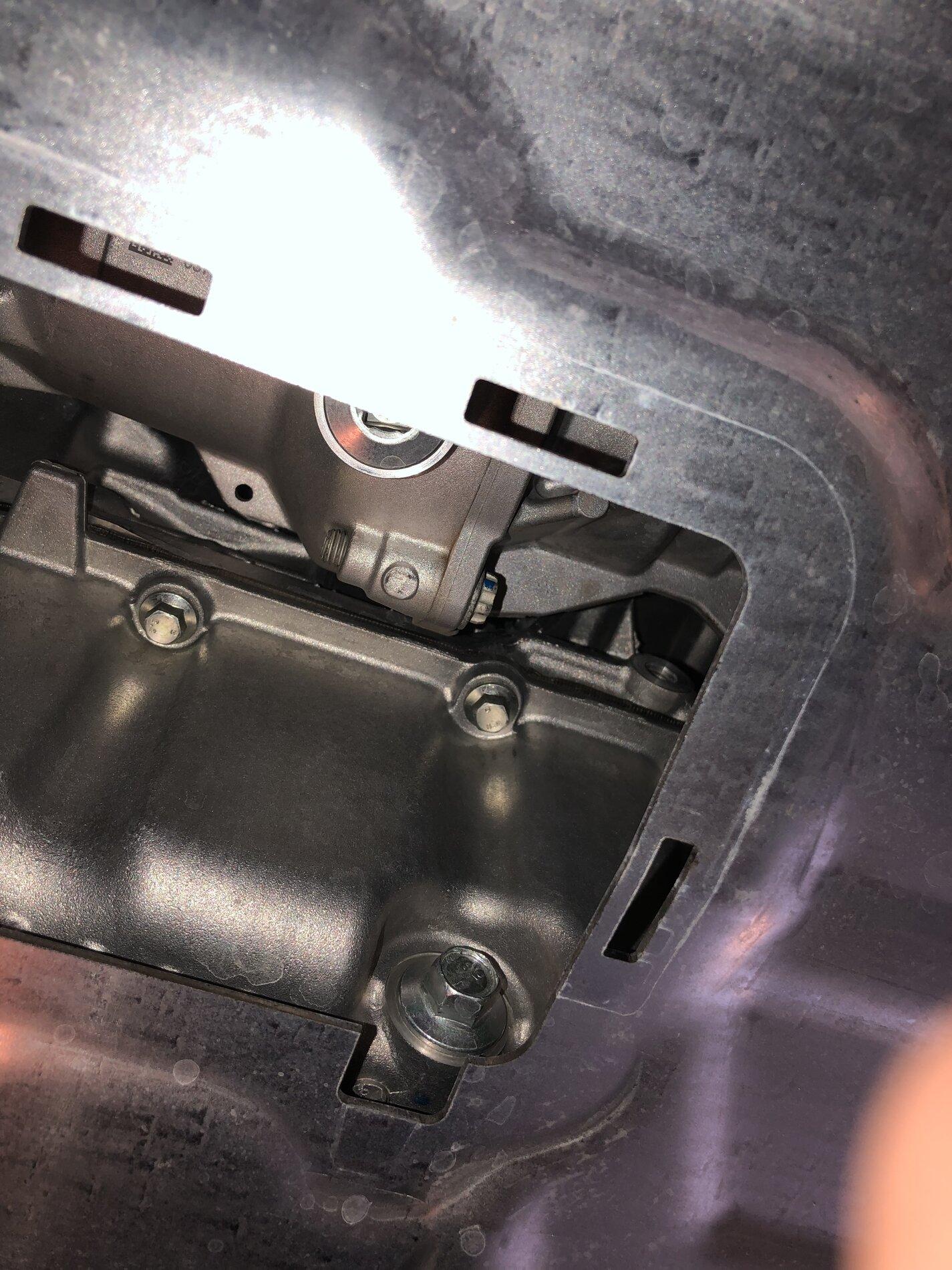

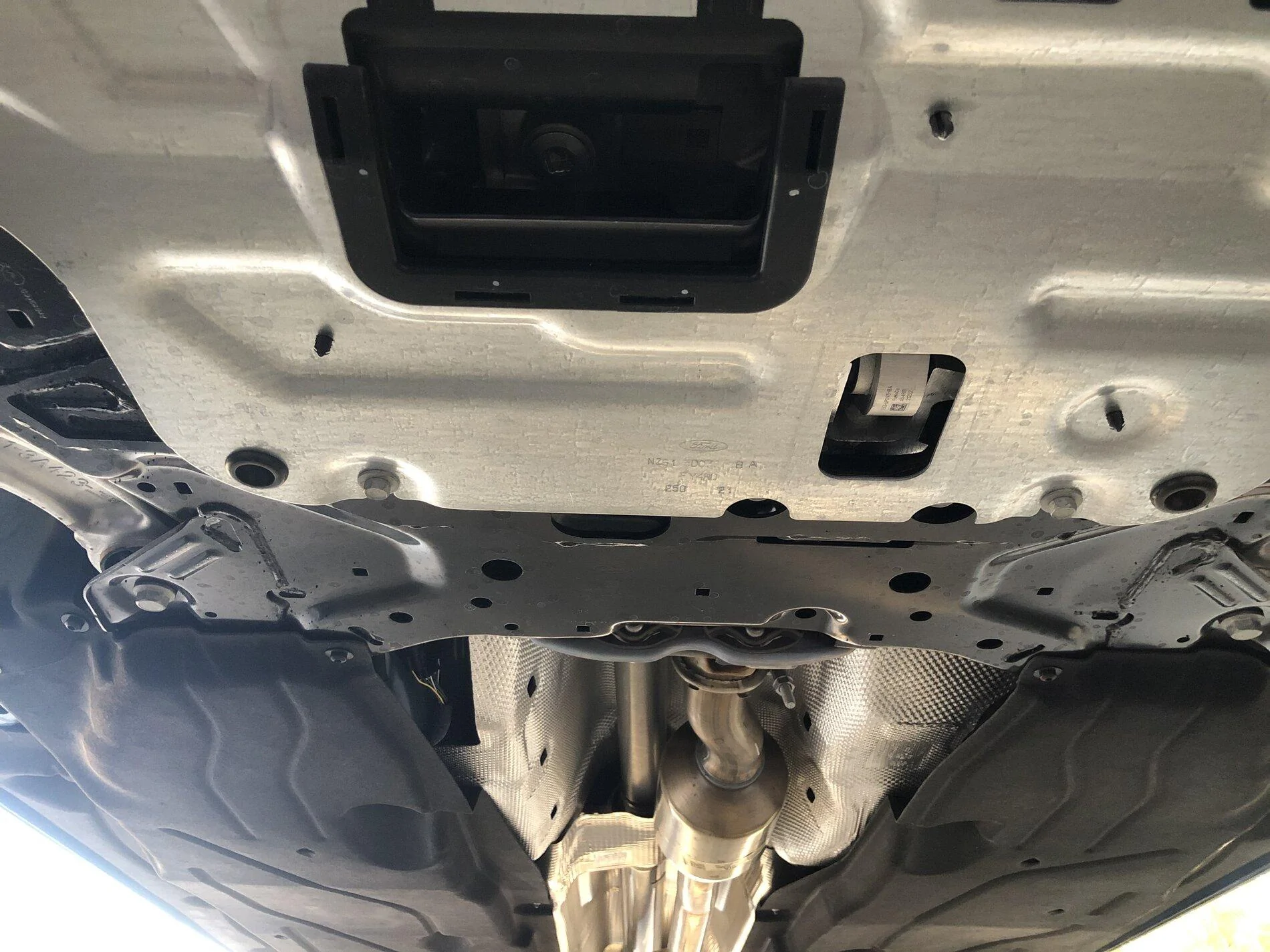

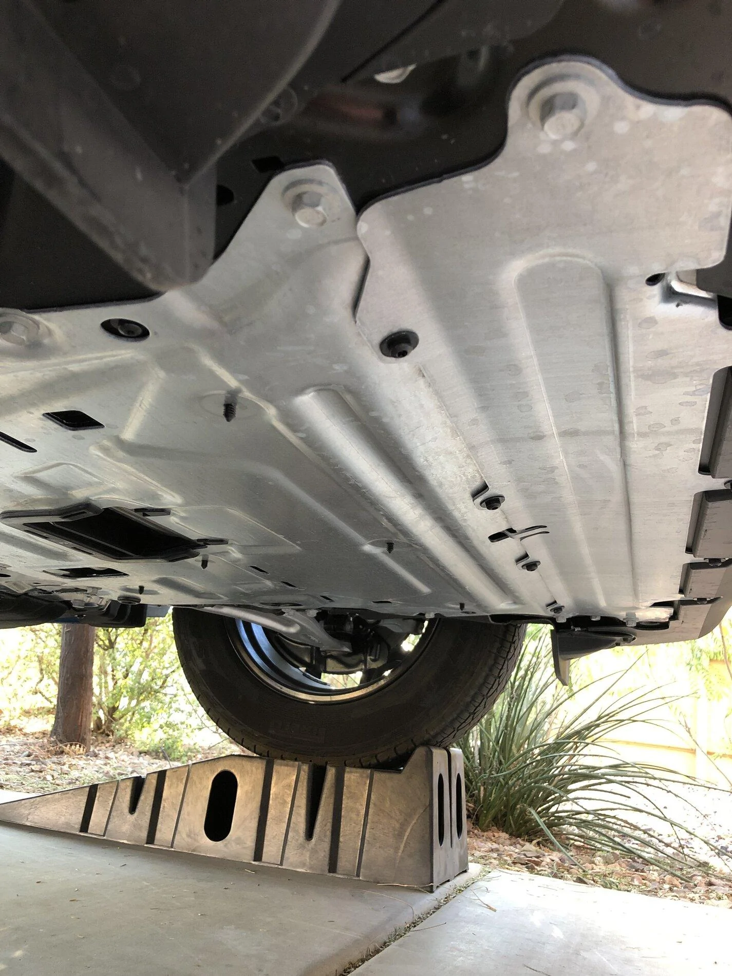

Here are the pictures I promised! Sorry for the wait. I had to lift the truck up to fit my fat a$$ under it! LOL
as you can see there is a large panel on the front you need to remove to get to the filter. and a small plastic air scoop (transmission cooling?) in the middle you need to remove to get to the drain plug
all in it took me about 10 min to remove, take pix and replace.

I don’t mind removing the panels for access, but that oil drain plugs location relative to the skid plate makes me cringe and I hope it’s just an optical illusion. I can already see the oil draining onto the skid plate then dripping down into my drain pan. Please tell me I’m wrong 😑

i wish I could tell youit’s an illusion, but no, it’s that close!
