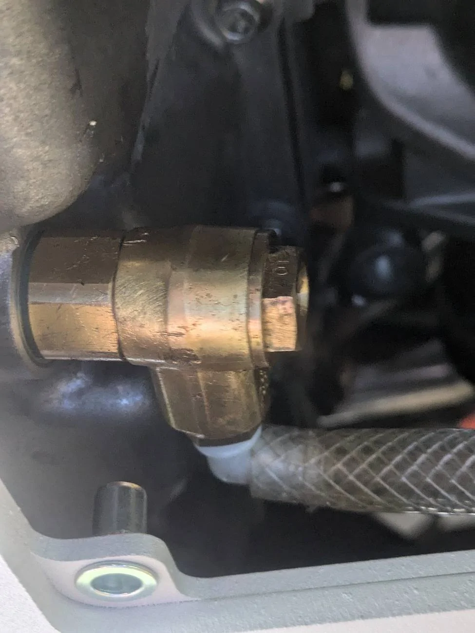

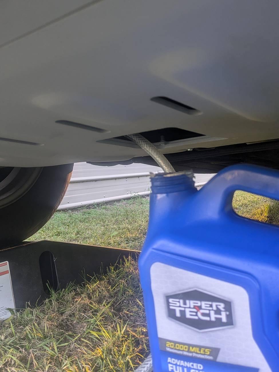

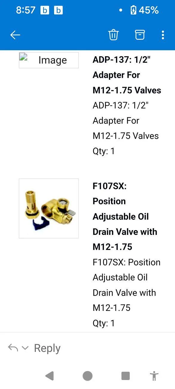

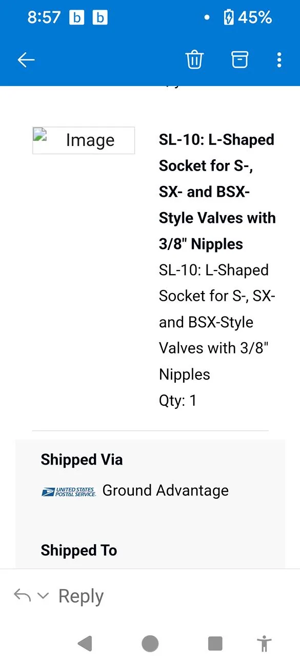

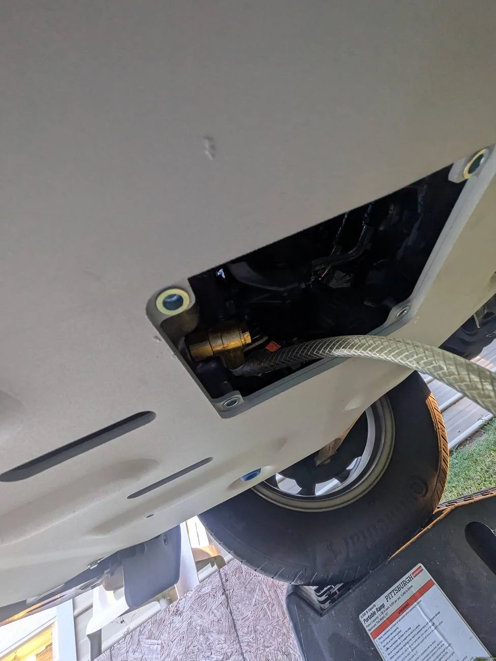

Sorry about your nightmare but thanks for preparing me. Installed my Fumoto valve and Rival skid plate at same tine today. Next oil change will be a breeze. Parts #s in
