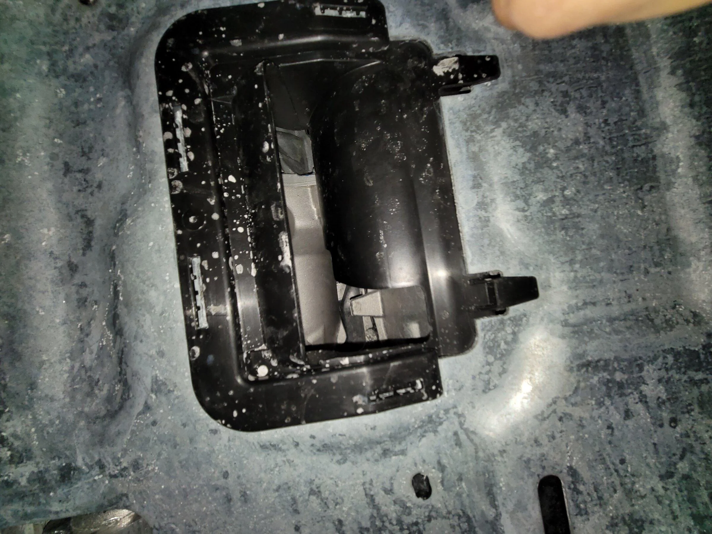

How do i remove this ? Anyone can help ? Thanks
Ford Maverick PSA: oil change on FX4 Maverick requires skid plate panels removal 20220122_135358

The skid plate on FX4 is only tough the first time, because of Loctite on the six 13 mm bolts from the factory. No need for Loctite when replacing those bolts. After the first time you can just zip them out with an impact driver and the four T27 screws in about 60 seconds. I just finished doing it today.
