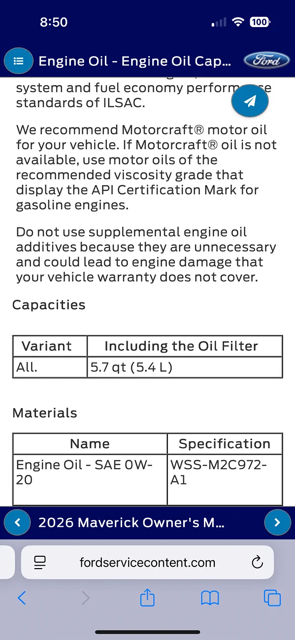

Just in case some of you were not aware, Ford changed the spec for required oil on the 2026 Hybrid.
Does this mean they disapprove of the snake oil salesmen like Amsoil?

Recommended ≠ Required.
Example:
I recommend you don't eat raw fish.
But you can if you want.
Of course Ford "recommends" a Motorcraft product. Got to keep the product sales revenue in the family if possible. And they also "recommend" a Motorcraft oil filter.
And they "recommend" 0W-20. Does that mean other grades/specs are "acceptable" too?
0W-15? or 0W-30? 5W-20?
"Recommended," not "required?"
You're reading that incorrectly. It recommends Motorcraft oil and filter. It requires the use of 0W20 full-synthetic oil (other brands can be used, but only if they meet the specifications listed).
