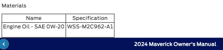

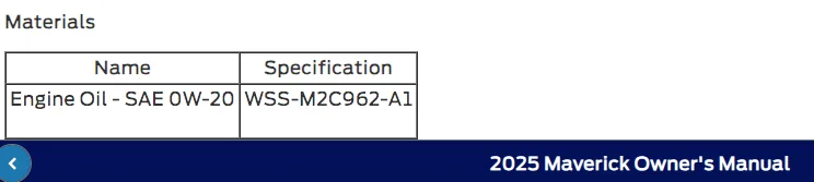

Ford has used fuel analysis in the past to deny diesel engine warranty claims where the failure was in the high pressure fuel system. This happened to a member of Ford Truck Enthusiasts forum a number of years ago When he had a Biocide in his truck Due to extended storage durations (months).
I just merely brought up the fact that Ford had change the spec from WSS-M2C962-A1 for 2025 to WSS-M2C972-A1 for 2026 Maverick Hybrids.
I’m going to be using the Ford spec oils - but you do whatever you want to do At the drain intervals that you like and can afford.

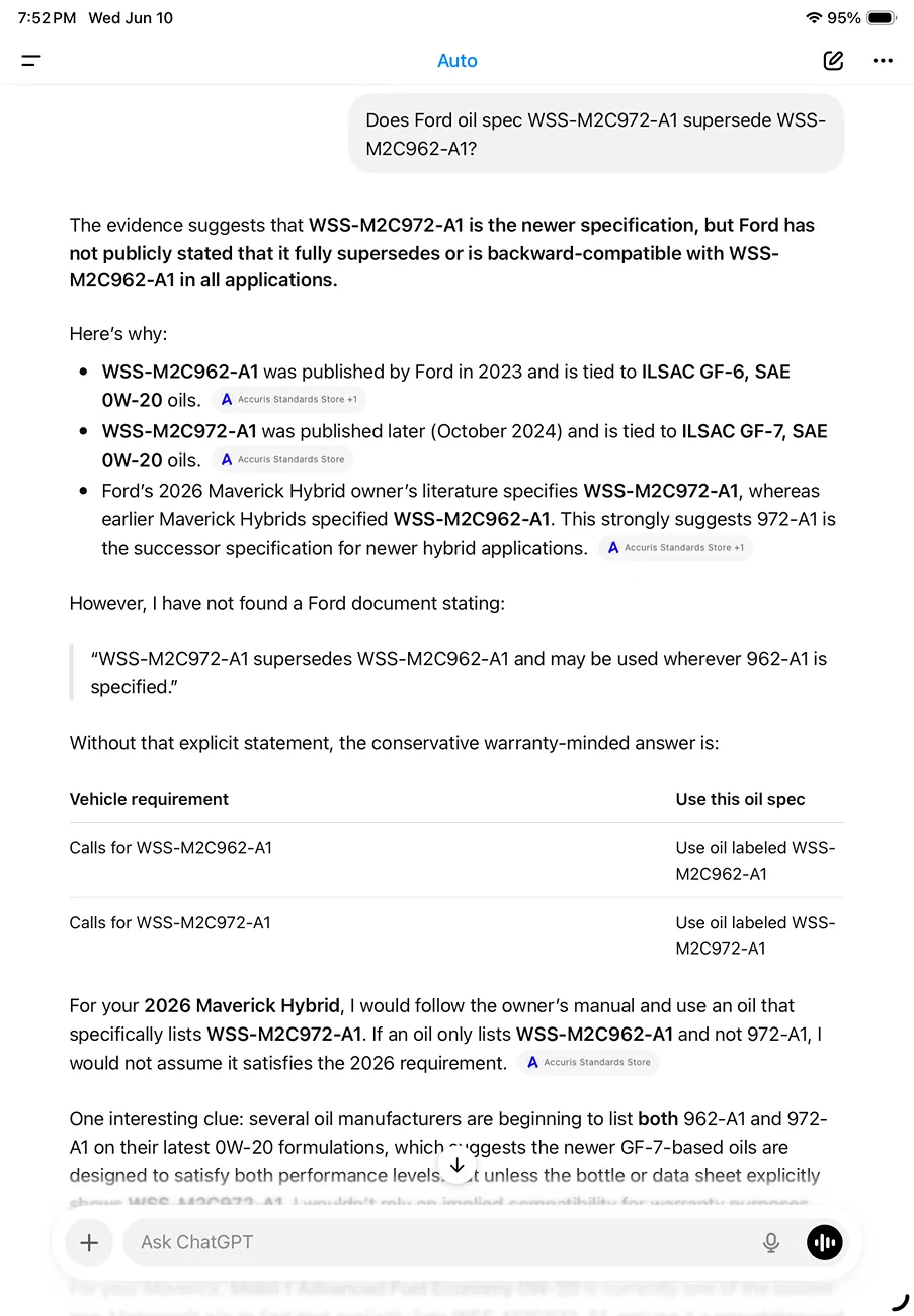

Just in case some of you were not aware, Ford changed the spec for required oil on the 2026 Hybrid.
Interesting. Probably backwards compatible. Once we run thru our hopefully pre-bought oil-shortage increased-prices purchases.

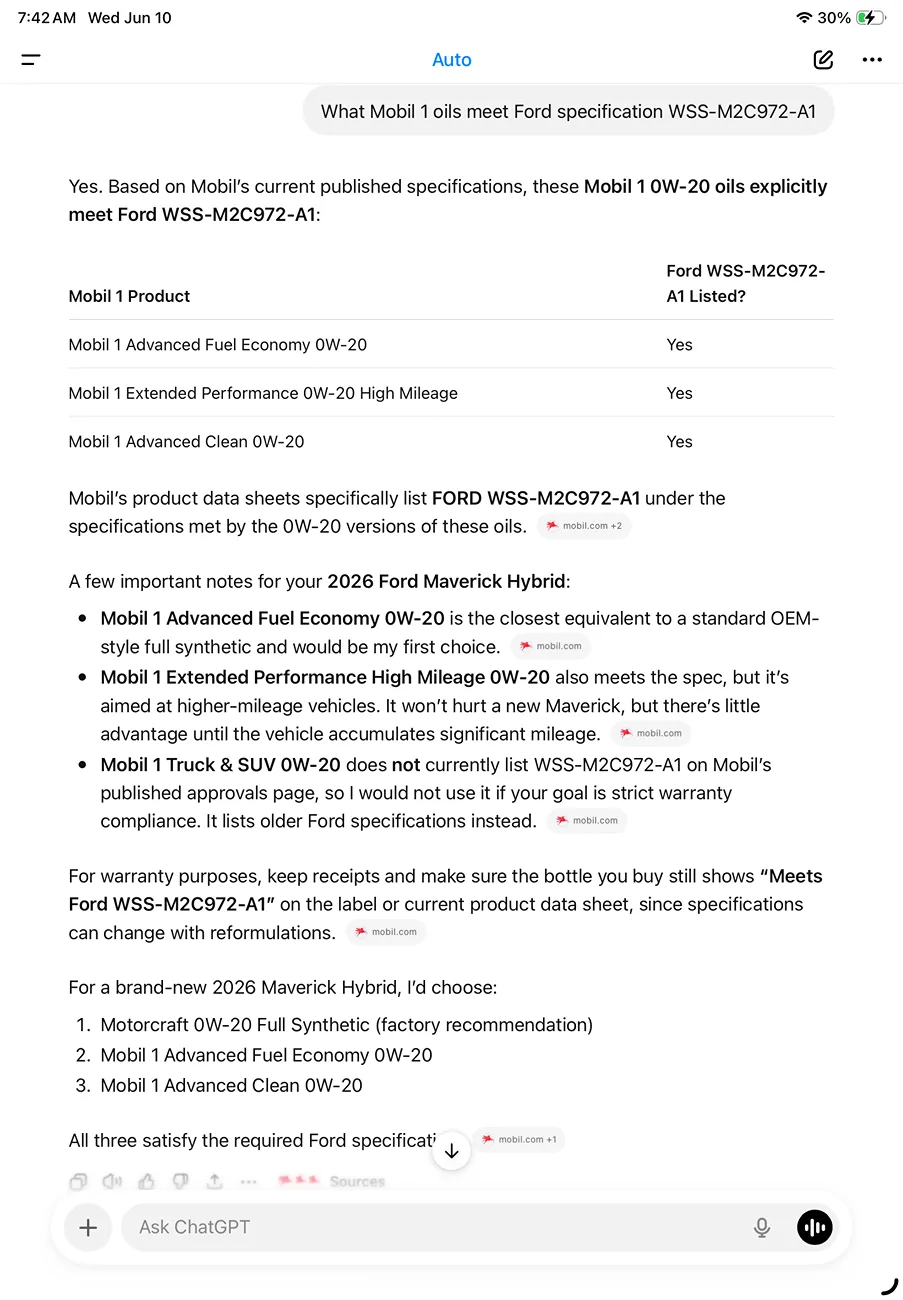

Could be that the new spec supersedes the previous - I haven’t read that anywhere..
asking ChatGPT (which is still only a somewhat educated guess)
Survey Says! ((Nope))

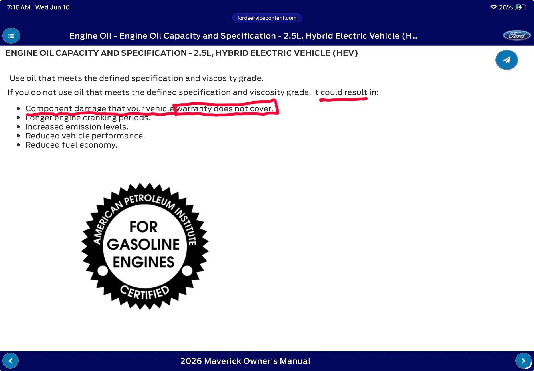

Is this recommend or required?
(recommend is in the sentence for Motorcraft brand)
ENGINE OIL CAPACITY AND SPECIFICATION - 2.5L, HYBRID ELECTRIC VEHICLE (HEV)
Use oil that meets the defined specification and viscosity grade.
If you do not use oil that meets the defined specification and viscosity grade, it could result in:
  • Component damage that your vehicle warranty does not cover.
  • Longer engine cranking periods.
  • Increased emission levels.
  • Reduced vehicle performance.
  • Reduced fuel economy.
I would never use any oil that does not meet or exceed the "recommended" specs. I'm just perplexed that Ford doesn't say "required."

Ford has specific required specifications for oil and other fluids. If another non-Ford manufactured product meets those specifications then they are fine. The specifications are not suggestions or recommendations, they are requirements.
"Use"
With implications given for non-use.
One being warranty - if they so desired to go after that angle.
They can't force you - but can inform you of possible consequences.
