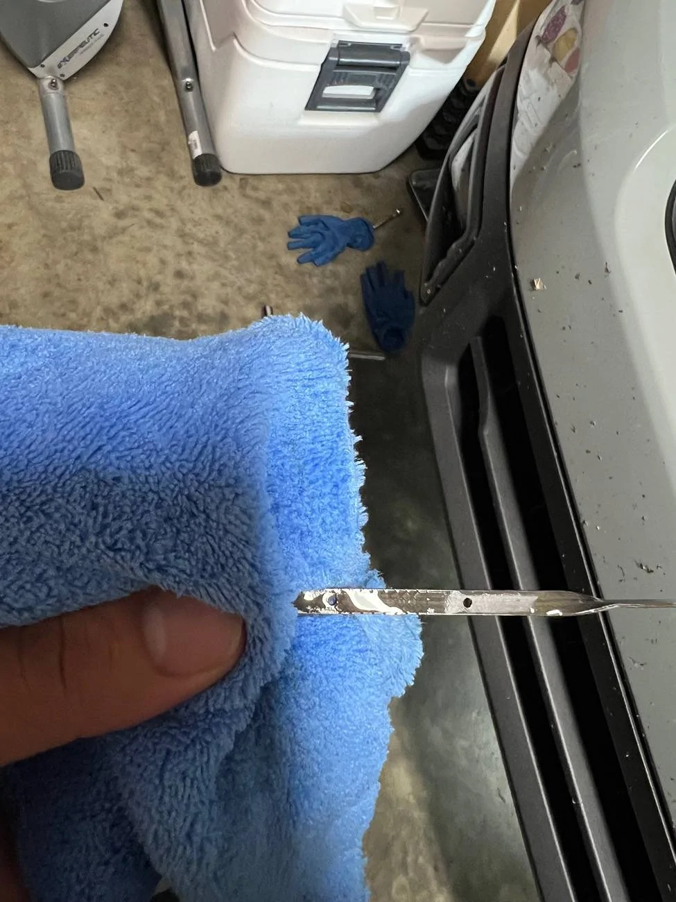

Hey y’all, I f***ed up
Doing my oil change on my hybrid. Pre-filled new filter to about 80% capacity (just under where the threads start) and forgot to account for this when adding oil up top. Added about 5.6 qts of new oil (by eyeing the markings on side of oil containers) and realized too late I hadn’t subtracted the amount of oil in filter. Haven’t started the truck and still on ramps, but here’s what the dip stick is showing. Wondering if I should be ok, or I should remove some. If so, how. Loosen filter to let some drain?
After checking dipstick, wipe clean on a microfiber towel. Repeat & wipe. Repeat & wipe again. Repeat until microfiber towel is sopping wet. Oil level should be just about right.

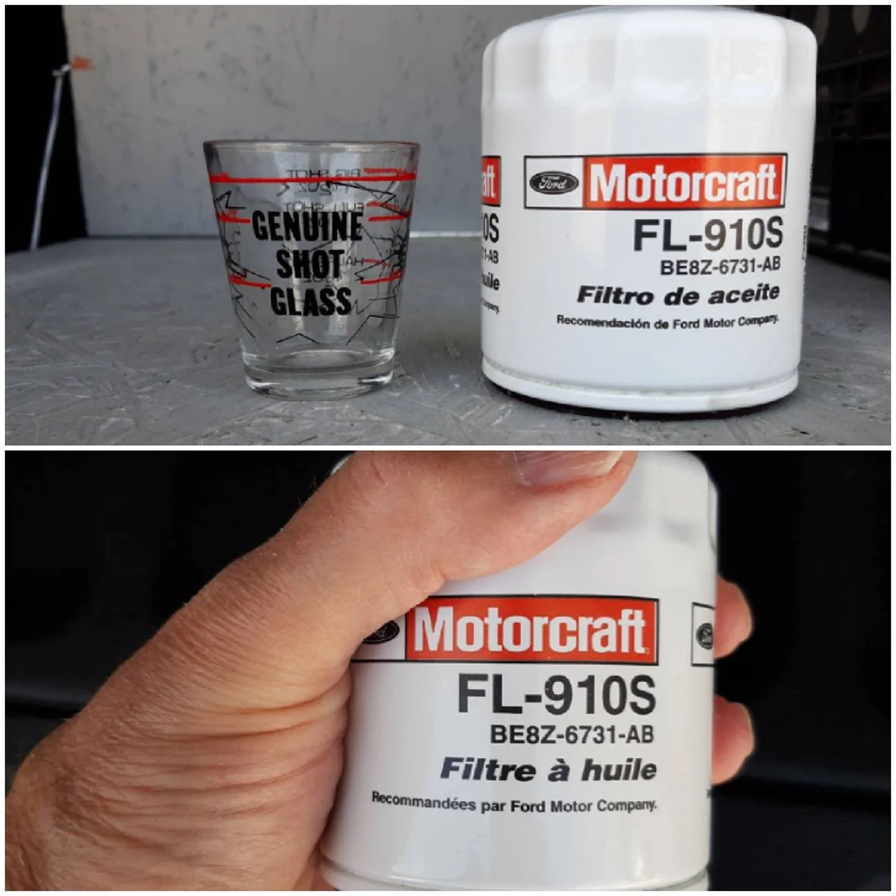

No reason to prefill filters.
The amount in the filter is a few ounces, no way that would cause an 'overfill'.
