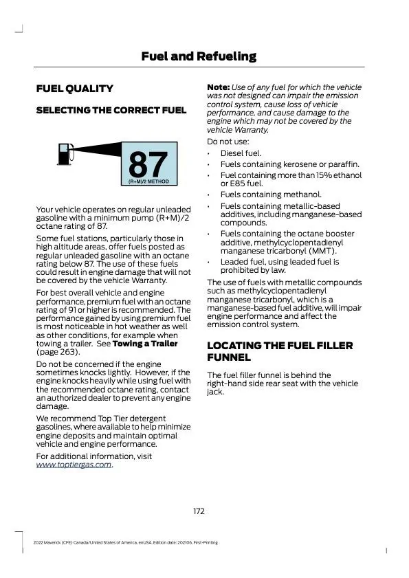

Here's the whole fuel page from the manual...
Ford Maverick Octane vs MPG, 87 vs 93, anyone compared? 2022-Ford-Maverick-P758-Owners-Manual-version-1_om_EN-US_07_2021
Ford Maverick Octane vs MPG, 87 vs 93, anyone compared? 1671660108981
