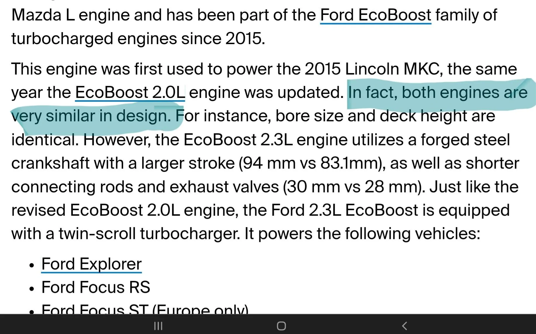

So the displacement is similar but the Mustang engine puts out much more power than the Maverick. That means there's a significant difference between the two engines design.
What is the significant difference between these engines? The 2.3 is built from the 2.0 engine

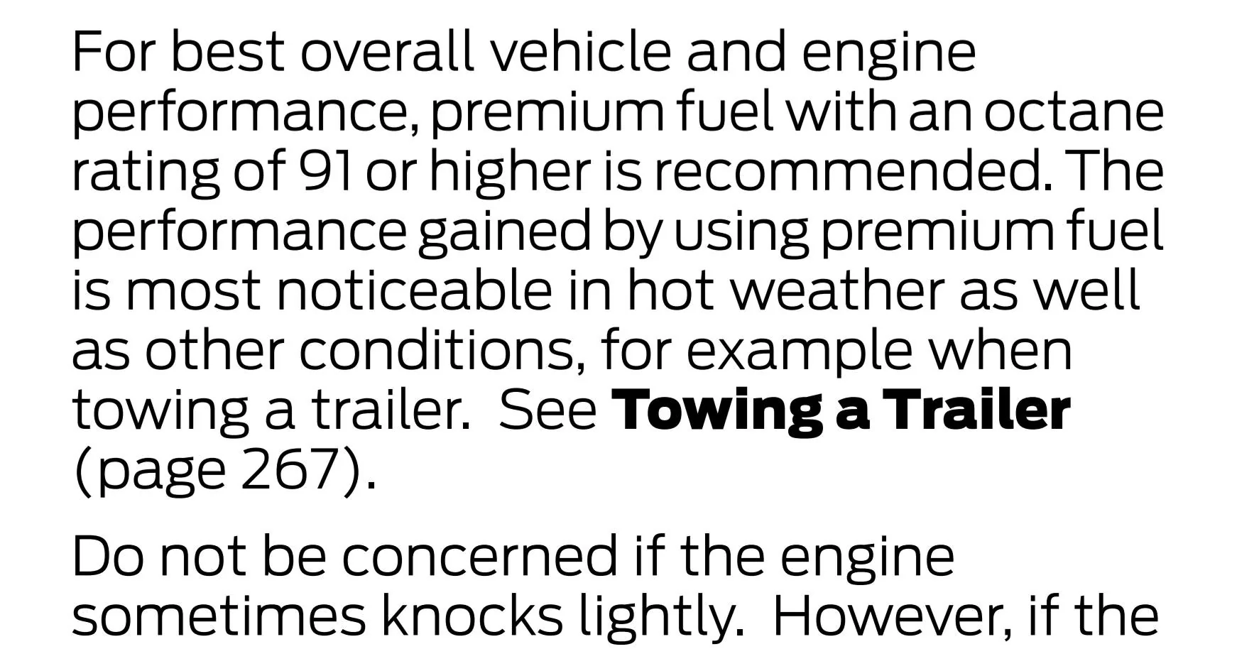

Even the owners manual states better engine performance with higher octane fuel.
Ford Maverick Octane vs MPG, 87 vs 93, anyone compared? Screenshot_20221221-113644_Driv
Ford Maverick Octane vs MPG, 87 vs 93, anyone compared? Screenshot_20221221-113048_Edg
