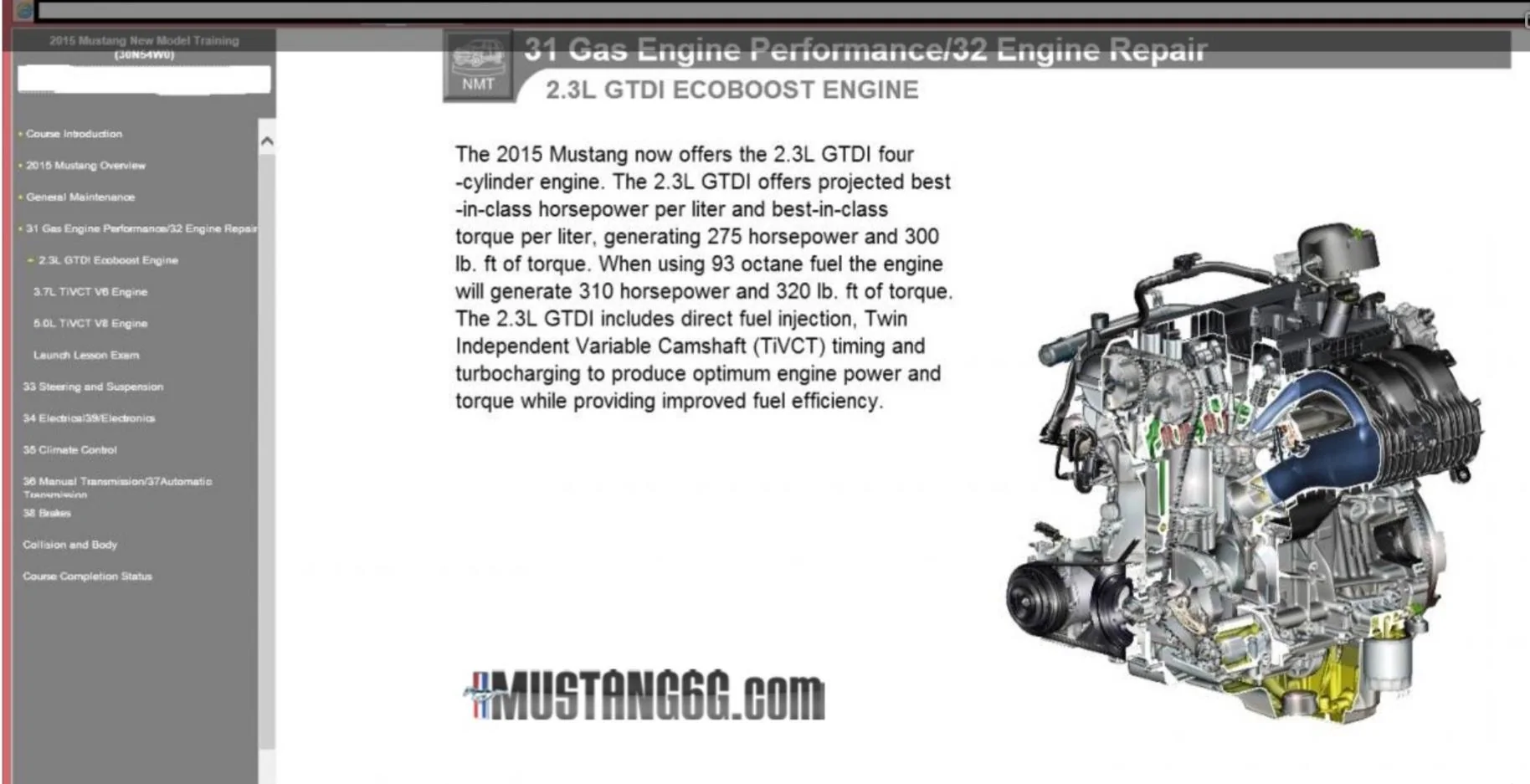

Ford admitted there is a loss of HP in the Mustang 2.3 Ecoboost using lower octane fuel. Someone obtained a copy of their Mustang training manual. It was a drop of 35HP from 310 to 275 when using 87 octane.What crystal ball and gypsy woman did you consult to determine this? On the average car with no other changes, changing octane make approximately ZERO difference in HP. Or, are you just trolling this dude and me? LOL
