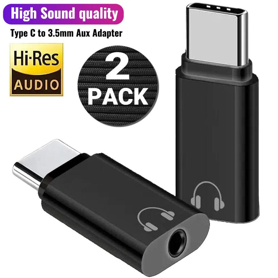

Has anyone tried this cheap Ebay adapter in their Maverick? I wonder how well it works. Two of these for $4.99.
Ford Maverick No "Aux" 3.5mm input for audio system? s-l960 here is the ebay link

Most of those USB-C/3.5mm adapters are unidirectional; they're designed to plug headphones into a phone. So typically they don't work for this use case of converting analog to USB.

Try a USB C to 1/8 TRS cable. Sweetwater has this one....https://www.sweetwater.com/store/detail/SRC2001--saramonic-sr-c2001-3.5mm-male-trs-to-usb-c-adapter
Thanks. Had know idea this type of adapter cable was available. Very useful.
