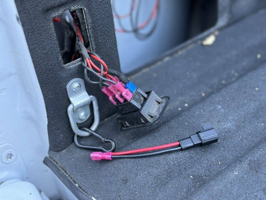

I use the truck as a workstation so I hooked up bed lights and light pods to the 12V Flexbed (E-DIY). For the hybrid, it's especially satisfying to be able to power things for an hour on end without the truck having the idle. The primary downside is that only works with the keys in the ignition or it would drain the 12v battery, which is less than ideal when I'm constantly stepping away or camping in the bed. Here's what I did to (safely) add an aux power input, which enabled me to power everything from the truck OR an external power bank.
Ford Maverick How To - Adding Aux Power Input for Flexbed (w/ Photos) 9B4658B8-439E-4B21-84FB-74CB2295E1B9_1_105_c
1. Installed a Fuse Block

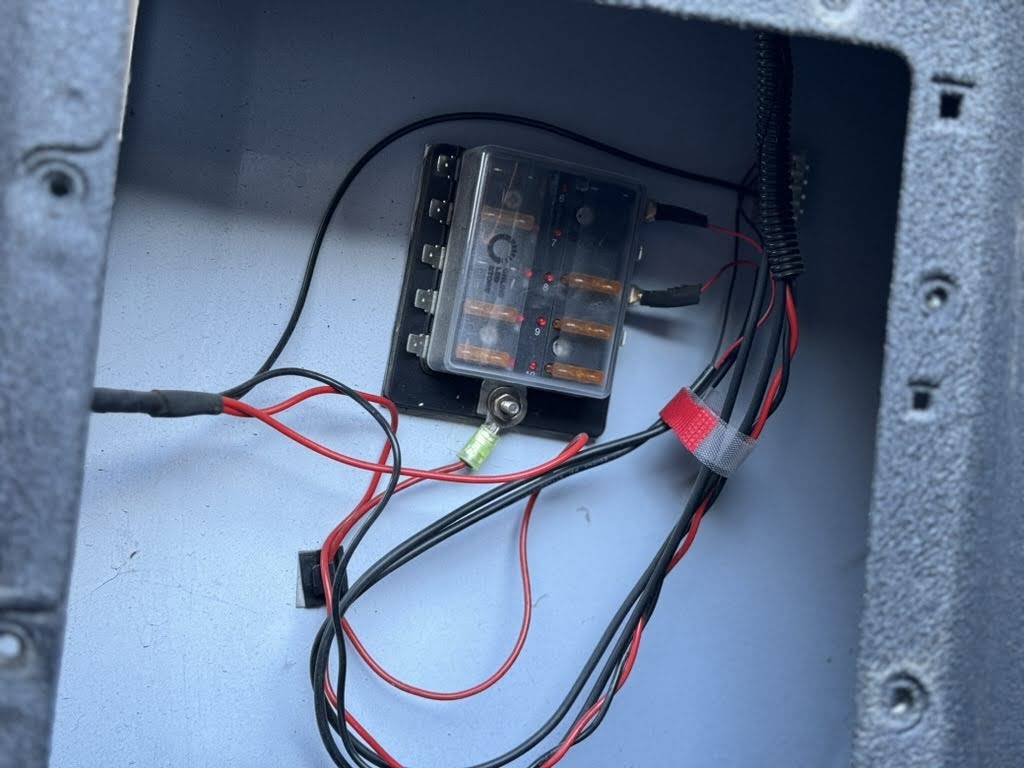

Ford Maverick How To - Adding Aux Power Input for Flexbed (w/ Photos) A02EE14D-D3EE-430C-9493-4FCC8E92C216_1_105_c
a. I mounted a fuse block with a strip of VHB to the panel behind the upper portion of the cubby cutout. The positioning is important, if it's installed high enough then there's no interference with the storage cubby (see photo below).​
Ford Maverick How To - Adding Aux Power Input for Flexbed (w/ Photos) 96EE8CE1-FEA1-4924-B8F4-1B2EA0E84435_1_105_c
b. You can see the outline of the storage cubby. There's just enough space that it doesn't interfere with the wires or the fuse block itself.​

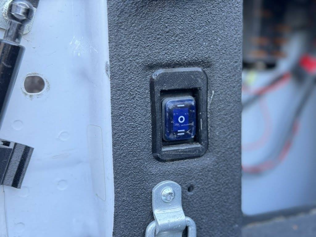

2. Wiring DPDT switch

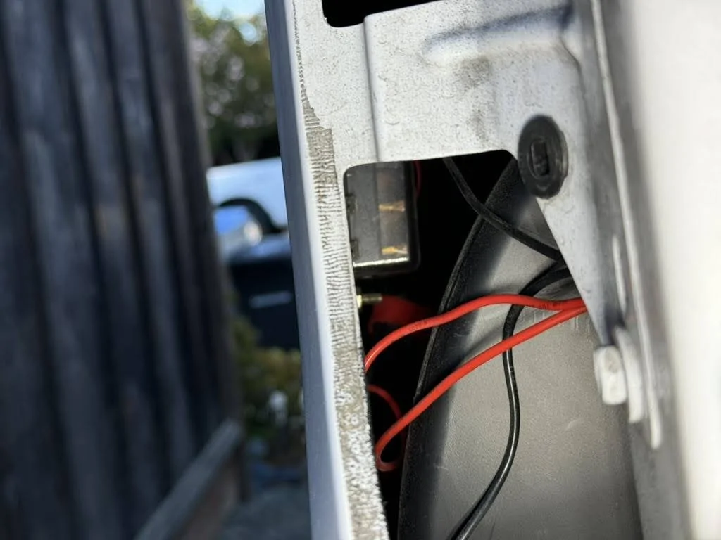

Ford Maverick How To - Adding Aux Power Input for Flexbed (w/ Photos) 92980792-C431-45AD-9A28-9080A5021A67_1_105_c
Ford Maverick How To - Adding Aux Power Input for Flexbed (w/ Photos) 37D4BB4F-F22C-49B7-AA77-AC4B20AB5E94_1_105_c
a. I ran a 16 AWG power wire from the fuse box to the bed pillar where the Flexbed connector was stored. I made a mounting bracket for the switch that would sit flush, so it was out of the way but still easy to access.​

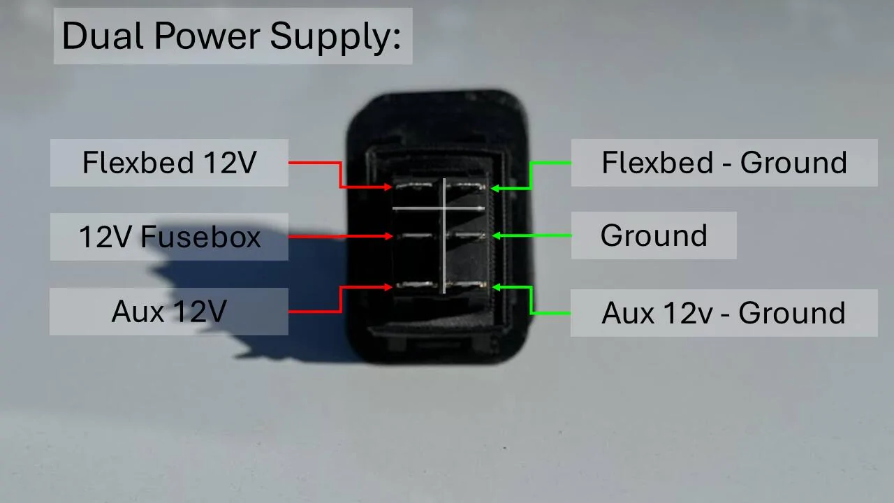

Ford Maverick How To - Adding Aux Power Input for Flexbed (w/ Photos) Dual Power Supply Config
b. From there I wired up a DPDT (double-pole, double-throw) switch. It's a fancy way of saying it's a switch with three states (0, 1, or 2) rather than the normal on/off. The left and right sides of the switch are separate, so I wired one for the power and one for the ground. State 0, the middle row is connected to nothing. In State 1, the middle and bottom rows are connected. In State 2, the middle and top rows are connected. This way, there is never any voltage cross (since the Flexbed normally goes up to 14.6V when the truck is running while power banks normally stay at 12V).​
3. Add aux power input

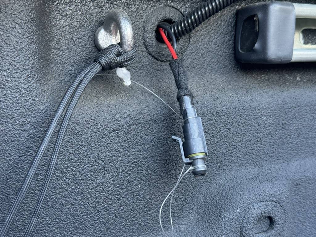

Ford Maverick How To - Adding Aux Power Input for Flexbed (w/ Photos) 7A5FCA75-9866-4BF2-84F9-BE65D04B4413_1_105_c
a. I ran additional 16 AWG wire up up to one of the gromets and connected it to a waterproof connector. Since I had some generic TE connectors, that's what I used. I then terminated it to the DPDT switch before closing everything up.​

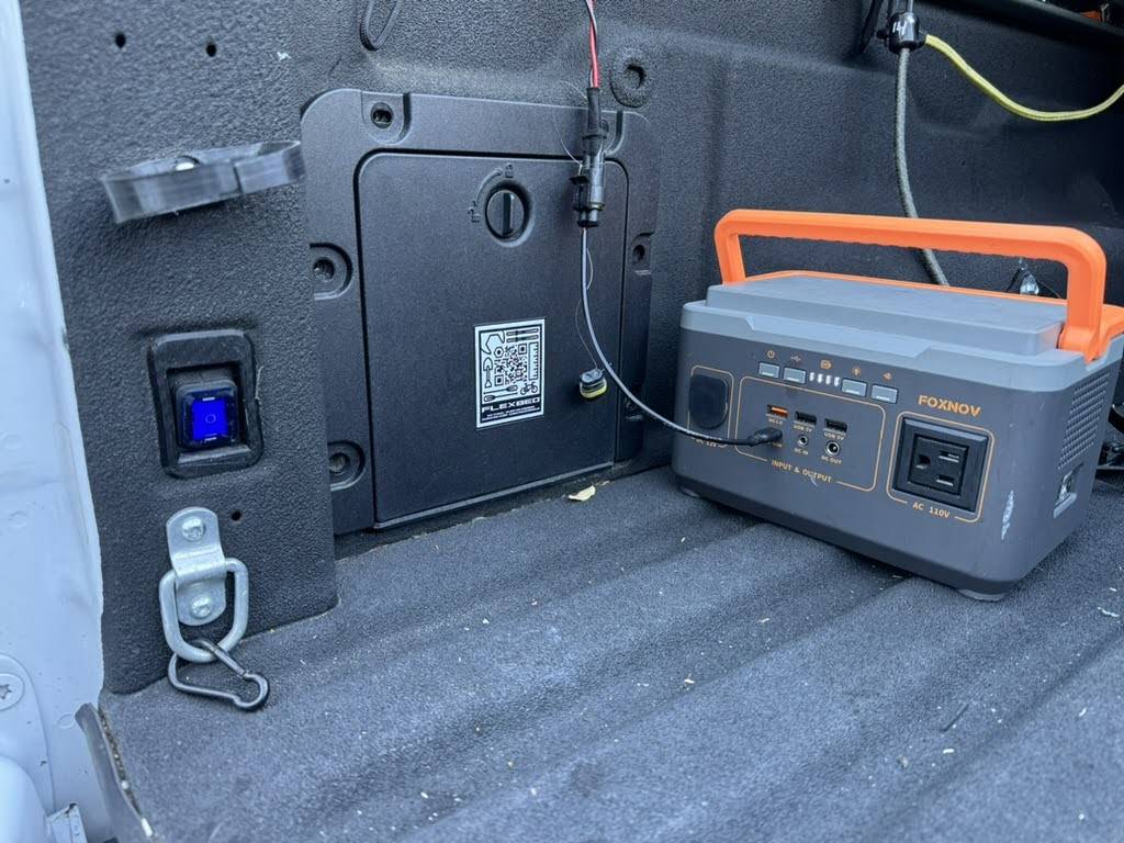

4. Final Notes
a. I got a USB-C (PD)-to-12v cord so I can run things off the power bank or my phone charger (lasts about 1-2 hours). The user experience is the same as using a normal switch, just with the added convenience of being able to connect external power. Since I installed it, I have considered mounting the aux power input all the way to the underbench storage instead. I've also considered running a split on the Flexbed power to the input jack of the power bank (or jump starter in my case), so the power bank could charge as it's stored but still available to run accessories off of.​
I hope this helps anyone interested in doing the same! I also put together a switch kit on my shop (includes switch, mounting bracket, and Flexbed connector) for people who want to implement something similar.​
