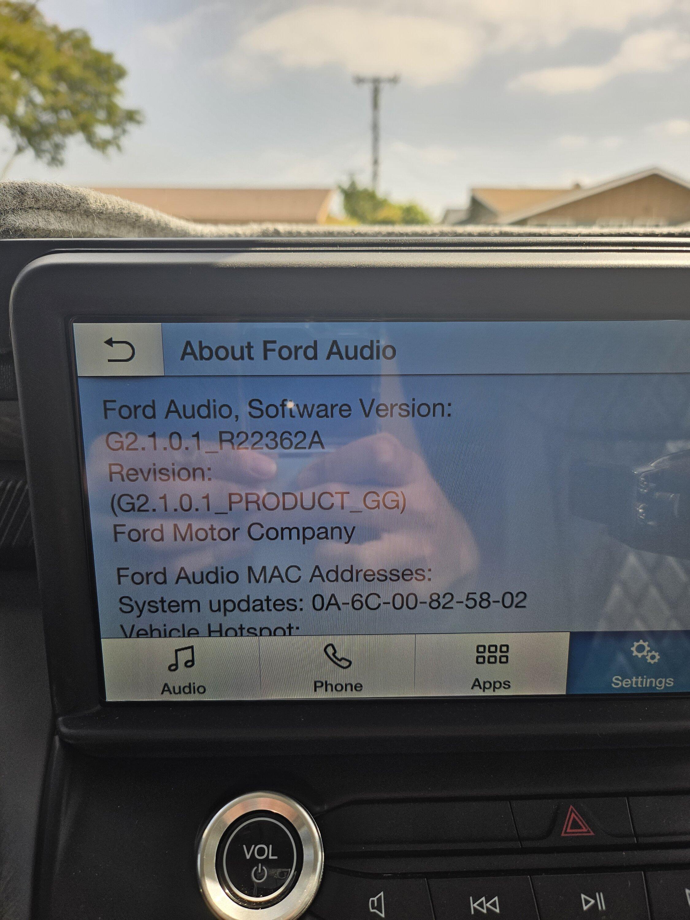

What was the Software Version before the update started?
What is the Software Version that you are downloading?
I just checked for updates and there are no updates available.
I just got my MY2023 Maverick on 9/22/2023 and this is the Software Version currently installed:
Ford Audio Software Version: G2.1.0.1_R22362A
Revision: G.2.1.0.1_Product_GG
This is the firmware that was released Feb 8, 2023.
See here: New Radio Software Update G2.1.0.1_R22362A
When the update completes let us know if the update version is newer than G2.1.0.1_R22362A
Thanks!

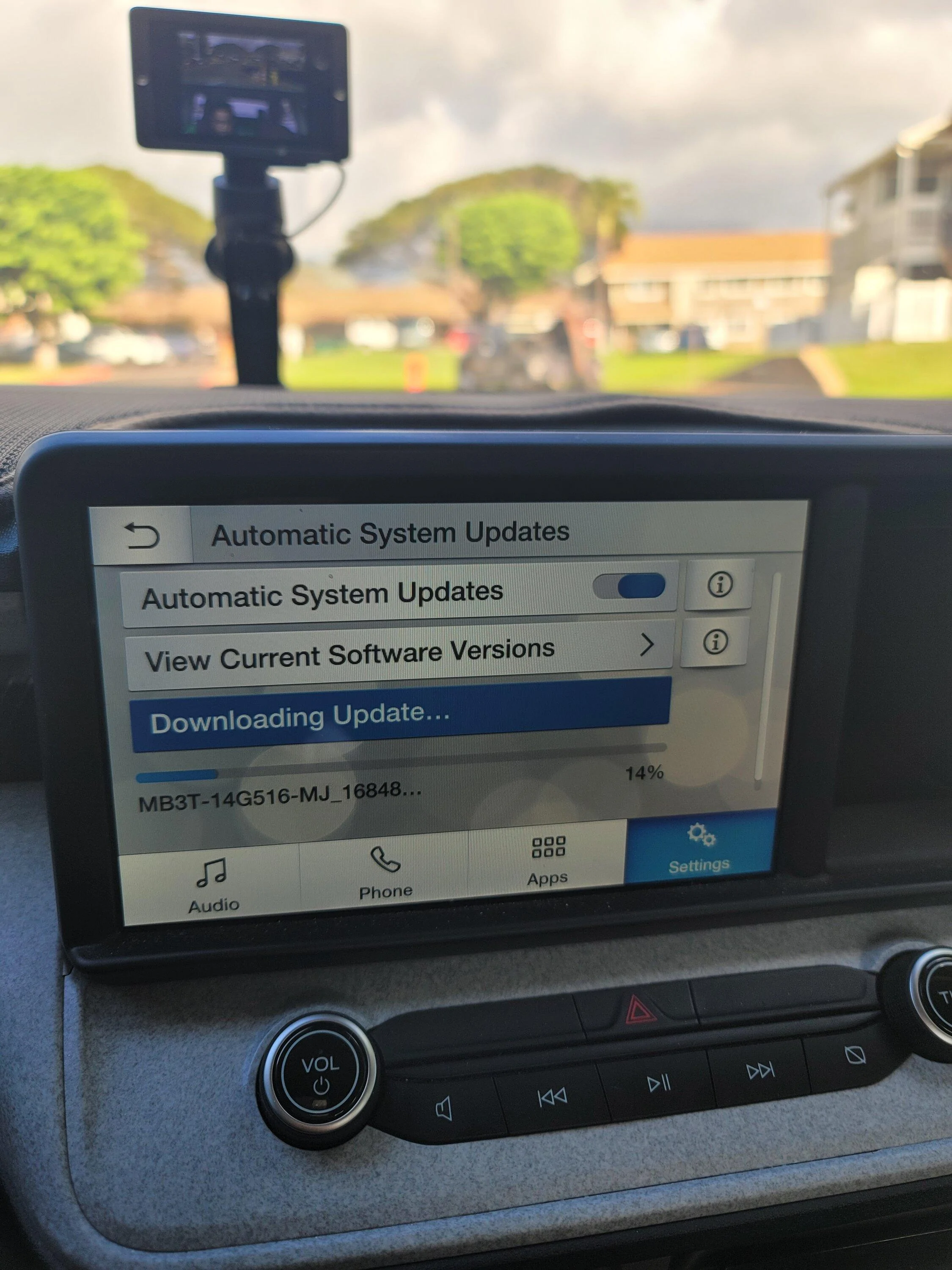

Apparently it's been a while since I updated. Mine took about 15 minutes to update from 1.9 -> 2.2, and I received an audio confirmation after cycling the key and waiting a minute.

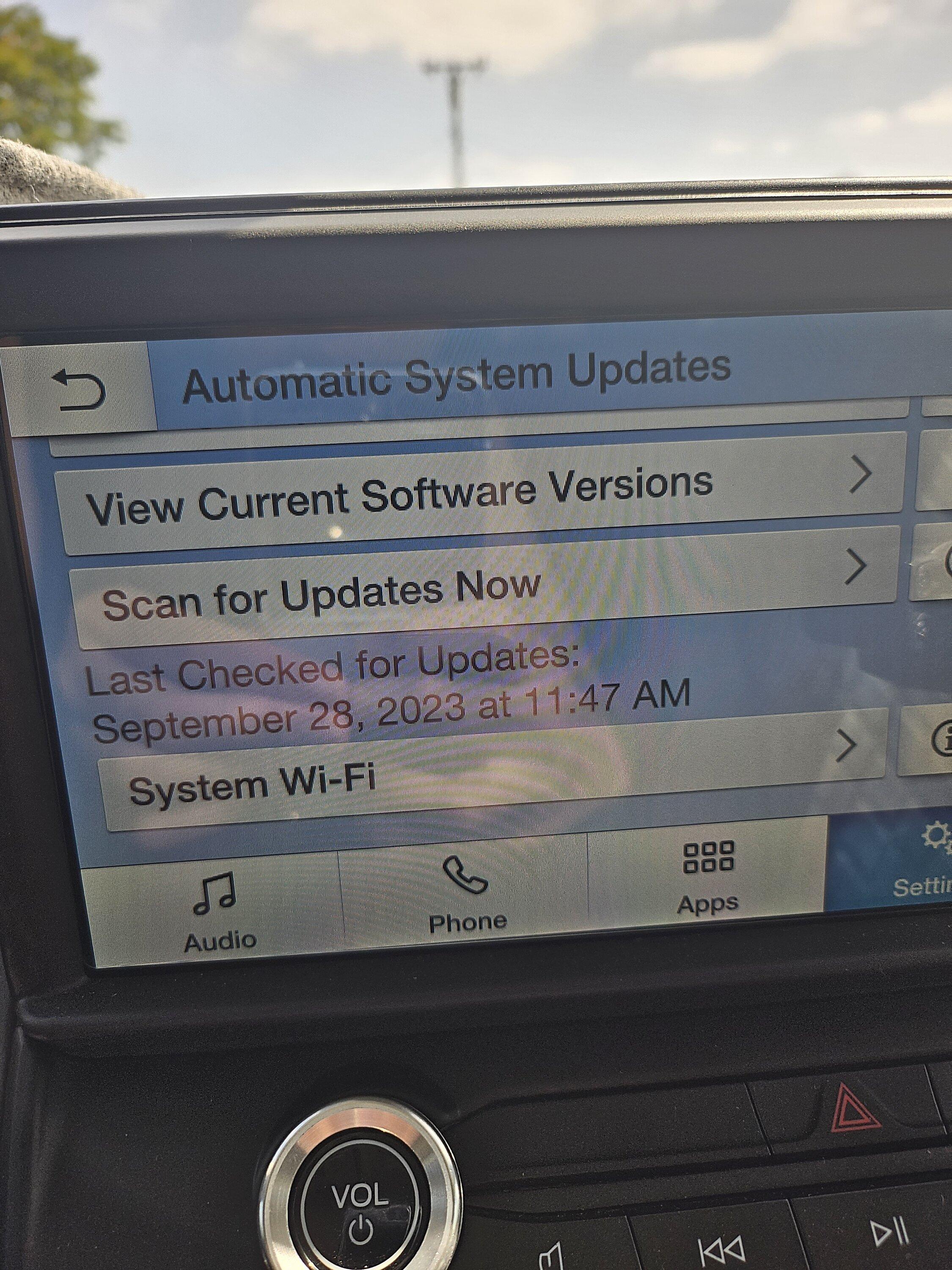

Hey all,
I've been trying to do the firmware update on my truck, but it could not find the update, no matter how many times I pressed the "Scan For Updates Now" button. Does anyone happens to run into the same issue as me?
Attached below is the software version on my 2023 Maverick XL Hybrid, connected to my mobile hotspot (2.4GHz):
Ford Maverick New stereo firmware update available! 1000005578
Ford Maverick New stereo firmware update available! 1000005579

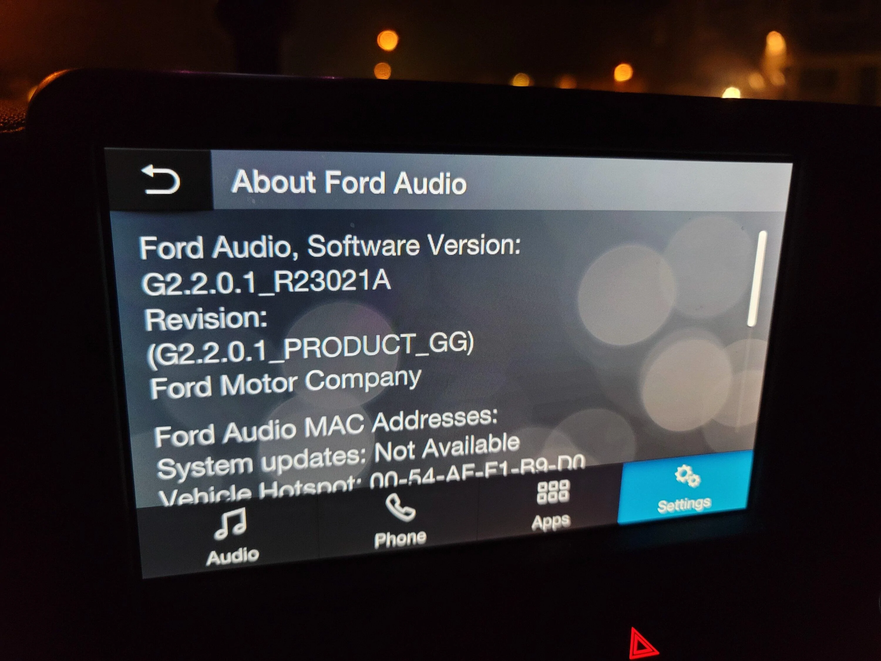

I just updated my '22 XLT to 2.2.0.1. Went pretty quick. When done I received an audio confirmation that the update had completed, I don't recall hearing that on prior updates.
I have a ‘22 Lariat, was there anything different you noticed on the updates?

Downloading as of making the post, hopefully fixes the random Bluetooth disconnections.

Mine would not update with either my home WiFi or using my phone hotspot. I decided to try hooking up my eero WiFi extender, which I hadn’t used since moving earlier this year. It connected and immediately started downloading. Took about 15 minutes in total. Go figure.
