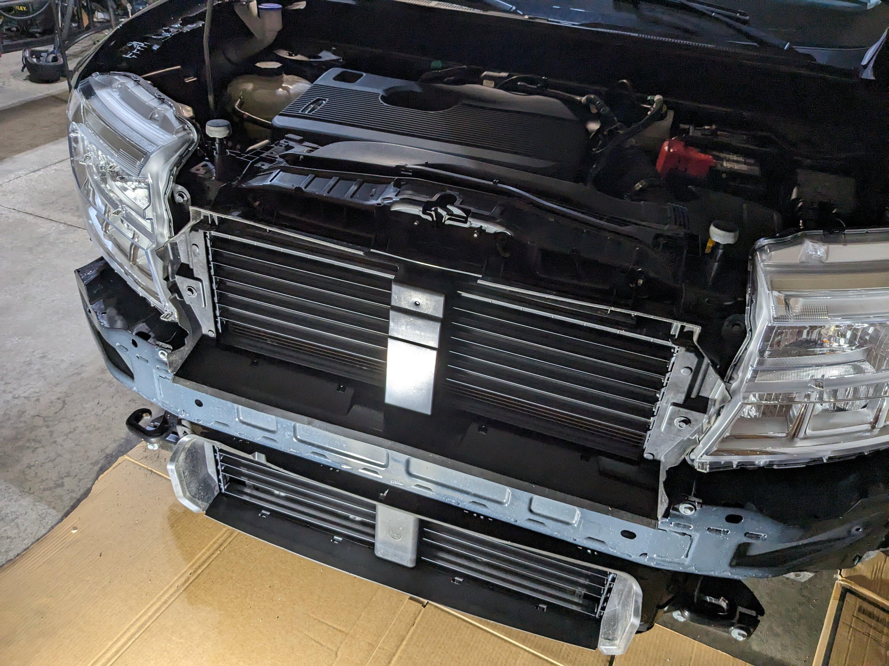

The biggest job by far was the raptor grille. I took my time over a couple days but it is doable with basic tools and about 8 hours. Trickiest part is the three bumper bolts on each side forward of the wheel well. Not enough space to get a cordless ratchet in there.

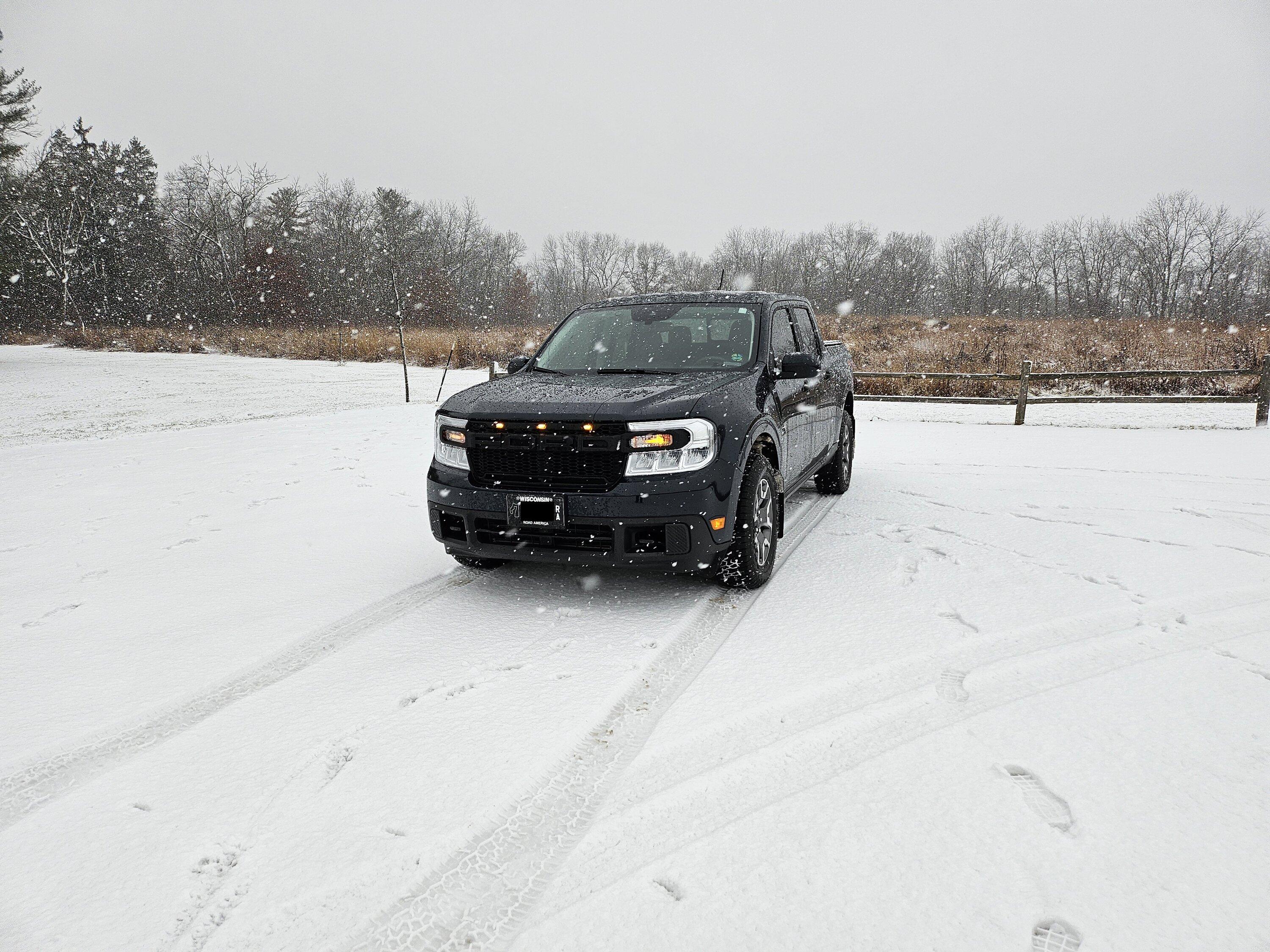

Raptor style grille | http://testdriven.tv/2023/03/ford-maverick-raptor-style-grille-installation/ |

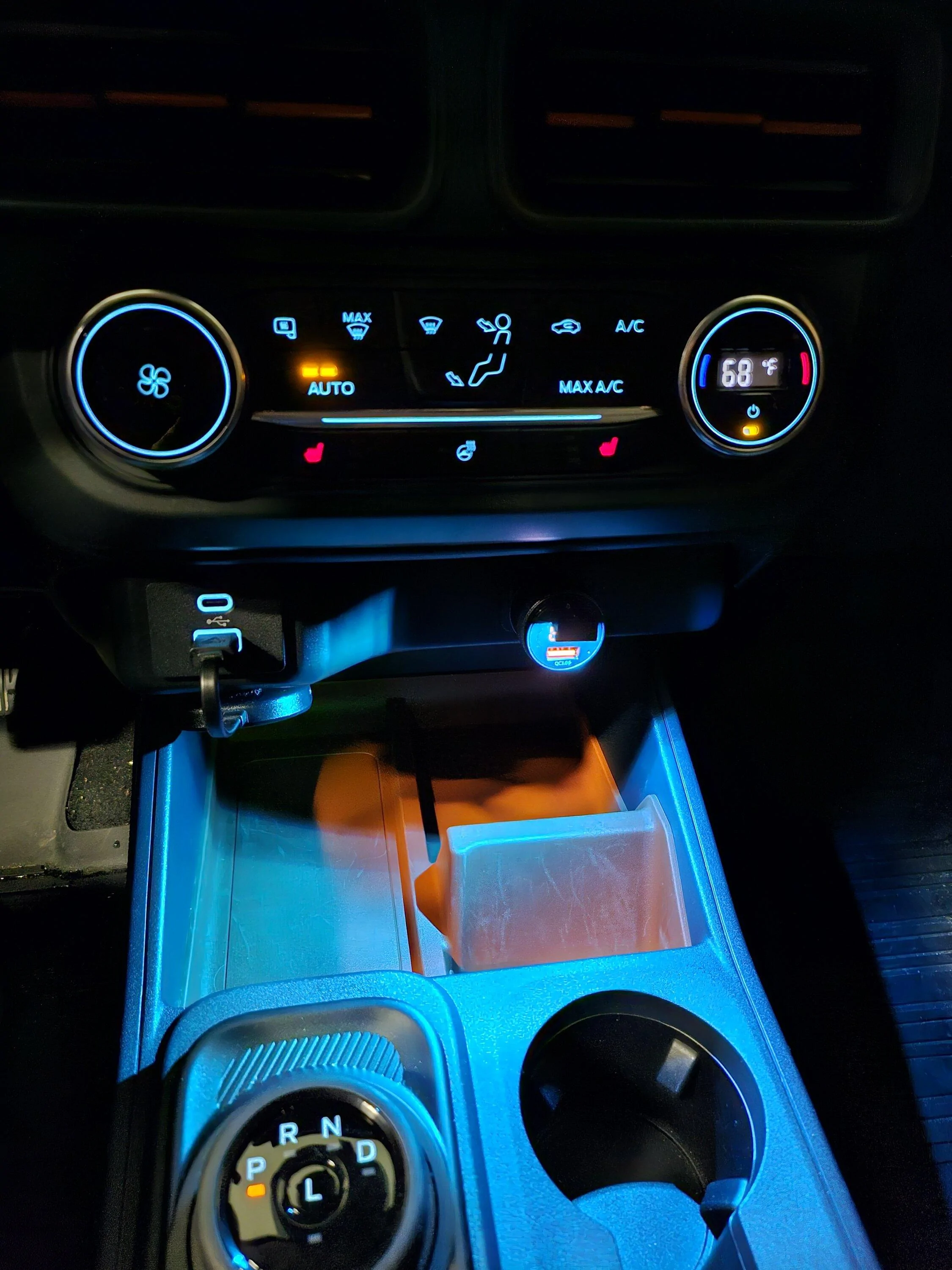

Swapped in climate control unit w/ digital readout | Look for one on ebay from 2020ish Escape |
