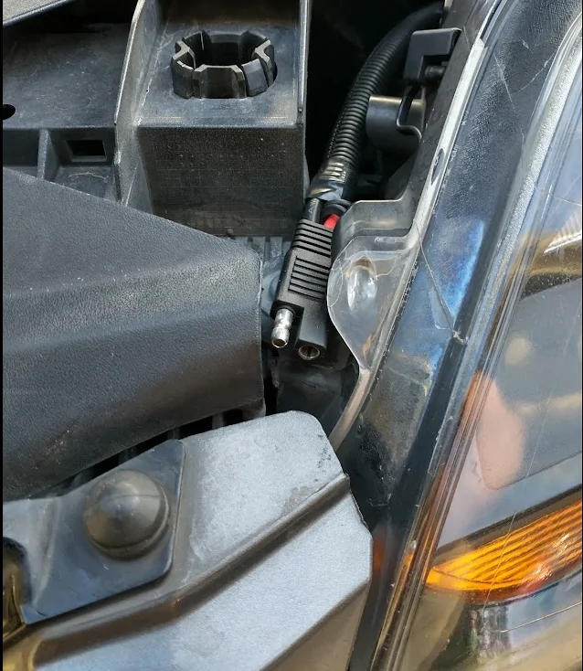

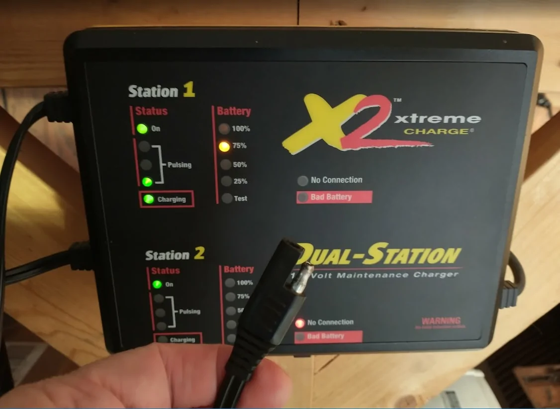

If you use a smart charger/maintainer like Noco or Pulsetech brands, the more the merrier. I use my Pulsetech 2-4 times a month and more in the winter, and I regularly get 8+ years out of a battery. I have a 2012 Focus that has basically the same charge strategy as the Maverick on its second battery, replaced in 2020. If you're going through a battery every 2 years, an investment like this is a no-brainer, IMO.
Here's my setup, with a 2-channel charger mounted on the workbench in front of the 2 vehicles in the garage. I just pop the hood and plug them in on the weekends or overnight during the week whenever I think about it.

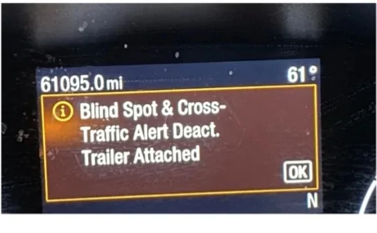

I'll keep the Lithium battery in mind for when this one craps out in 2028. In the meantime, please walk me through the trailer clip fix, or direct me to where I can read more about it? Thanks.
If you decide to go with the trailer plug.
Be advised that it will eliminate your
Blind Spot Information System
(BLIS) with Cross-Traffic ...
BLIS can alert you when a vehicle enters the blind spot zone. When changing lanes.
Cross-Traffic Alert warns of traffic approaching from the sides when the vehicle is in Reverse.
If your Maverick has BLIS. I don't know if it's something you'd be willing to give up.🤷‍♂️

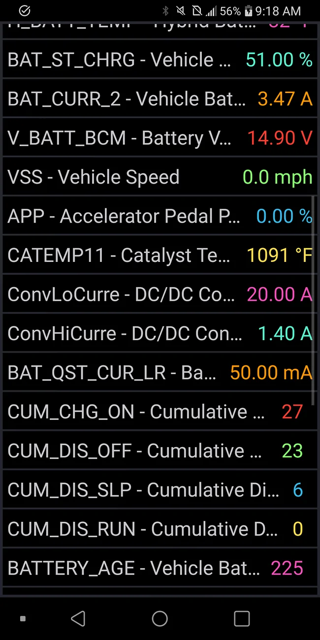

Do you have the means to have Forscan looking at some PIDs while you drive, and someone looking at them?
Actually - sitting in the driveway would be good enough.
For the hybrid all years (so no software change), it was discovered that for an AGM battery, the BMS stops charging at 92% Ford SOC, and allows the battery to then supply the 12V system and drain to mid-80's SOC before it applies charge again.
And above 80% SOC it's normally a float charge - so 1A or below. So it drains a whole lot faster than charges.
But it was also found that the following settings caused the BMS to go ahead and output charging level amps at 92% to 100% SOC. But the battery had to be high enough charge already to be at that higher end of mid-80%'s to get that effect.
1 - turn fan speed to 6 or above.
2 - turn headlights on, (ETA: correction - DRL is not the same).
3 - plug in a hitch light so trailer system thinks something is there (this may also disable some sensors depending on year/trim).
So it would be interesting to know if the EB does the same thing.
Since new battery at 12.5 resting - maybe high enough already.
But perhaps a charge up to be complete.
Did you follow the manual instructions for new battery - BMS reset and relearn?
Watch the 3 PID's here regarding the 12V battery.
If really starting at 100%, should see an Amp negative drain while running with Volts 12.8, down to 92% SOC.
Anywhere during that time - do one of the 3 things, see what happens to your Volts and Amps.

Oh, that is definitely a trade-off to keep in mind. I don't suppose there is a way to keep it enabled through a Forscan adjustment, is there?
I have a NOCO Genius 5 now.
OK then, you can't "over-maintain" an AGM or flooded lead-acid battery with a Genius 5 or any other "smart" charger. There is no risk to leaving it connected 100% of the time. So, my recommendation is to connect it as frequently as is convenient for you. However, I don't believe the "repair" function on a Genius 5 is supposed to be used at all on AGM batteries, only flooded lead-acid.
