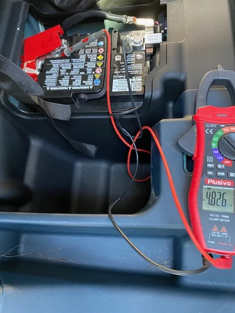

Vehicle built date May 2025. Vehicle not sitting for long times.
Oct 29-25, & Nov 1-25,Vehicle in battery saver mode. And of course, the best part is it tells you to start the truck to charge the battery.
Will not start no lights or anything , called roadside assistance and they came out & jumped with one of those little USB / battery jumpers. Took it to the dealer, they could not find anything wrong, they said they did a software update, but I could not find anywhere in the app that showed it was updated.
Nov -26-25, Nov-28-25, same as above. Put my voltmeter on the battery =4.6+/- but the second I put (my harbor freight VIKING 1000 Peak Amp Jump Starter and Power Bank on the battery,,
(NOTE: DIDNT EVEN TURN IT ON) The voltage jump up to 14.6 +/-. Had the Ford dealer tow it to the dealership, as of 12-2-25 have heard nothing from them!
The vehicle has a battery protection system (BMS) that should cut the power off to the battery when the voltage gets lower than 12+/-, but that don’t seem to be working.
Is it time to start a recall petition? just say'n
The battery saver functions could be messed up - since it's computer controlled - and we know what can happen with computers.

" Did remote unlock work" (no) the first & second time it happened the doors were unlocked. (I normally lock it just out of habit)
#3 & #4 it happened the key fob did nothing I had to use the physical key & manually unlock it.
You called yesterday and left a message have not heard anything back yet I am still using their loaner vehicle.
Dec-4 still sitting at the Ford dealer, has not moved in two days according to the Ford Pass app.
Hopefully, final update dealer installed new battery, under warranty at no charge to me.
When I drove off the lot the battery was at 75% state of charge, by the time I got back to the office, 5.4 miles it was up to 78% ¯\_(ツ)_/¯….
13+/-miles from office to home got it up to 81%.
Got to the office this morning 12-5-23 battery was approximately 81% but wait there's more,, passenger front window decided to stop working, up an inch weight,, up an inch weight.. etc.
Called my local dealer manager at 7:31 AM and have not received a call back yet as of 12:00 PM.

Truck left in Accessory mode.
Battery Saver will turn truck off, as if you turned key to Off - not turn battery off.
Any normal micro-drains remain that occur when truck goes to sleep after max 75 min. Probably normal drains during the 75 min too.
Same response as if you leave cabin light on or door ajar leaves it on - eventually battery saver will turn it off.
Battery Saver is also the term given when cabin lights are turned off sooner and sooner on entry/exit.
With remote unlock disabled - you had a drain to bad low levels.
They must have recharged it though - if remote access is possible and no Deep Sleep Mode was enabled (another battery saver step) and alerted in Fordpass.
They are probably seeking advice from Ford as to where to start troubleshooting a parasitic drain.
The underhood fuse box is interesting - you cannot open it for access to the fuses and test to see what is causing a high draw when it should be asleep - the act of opening that box disconnects it from the 12V system and disconnects everything.
