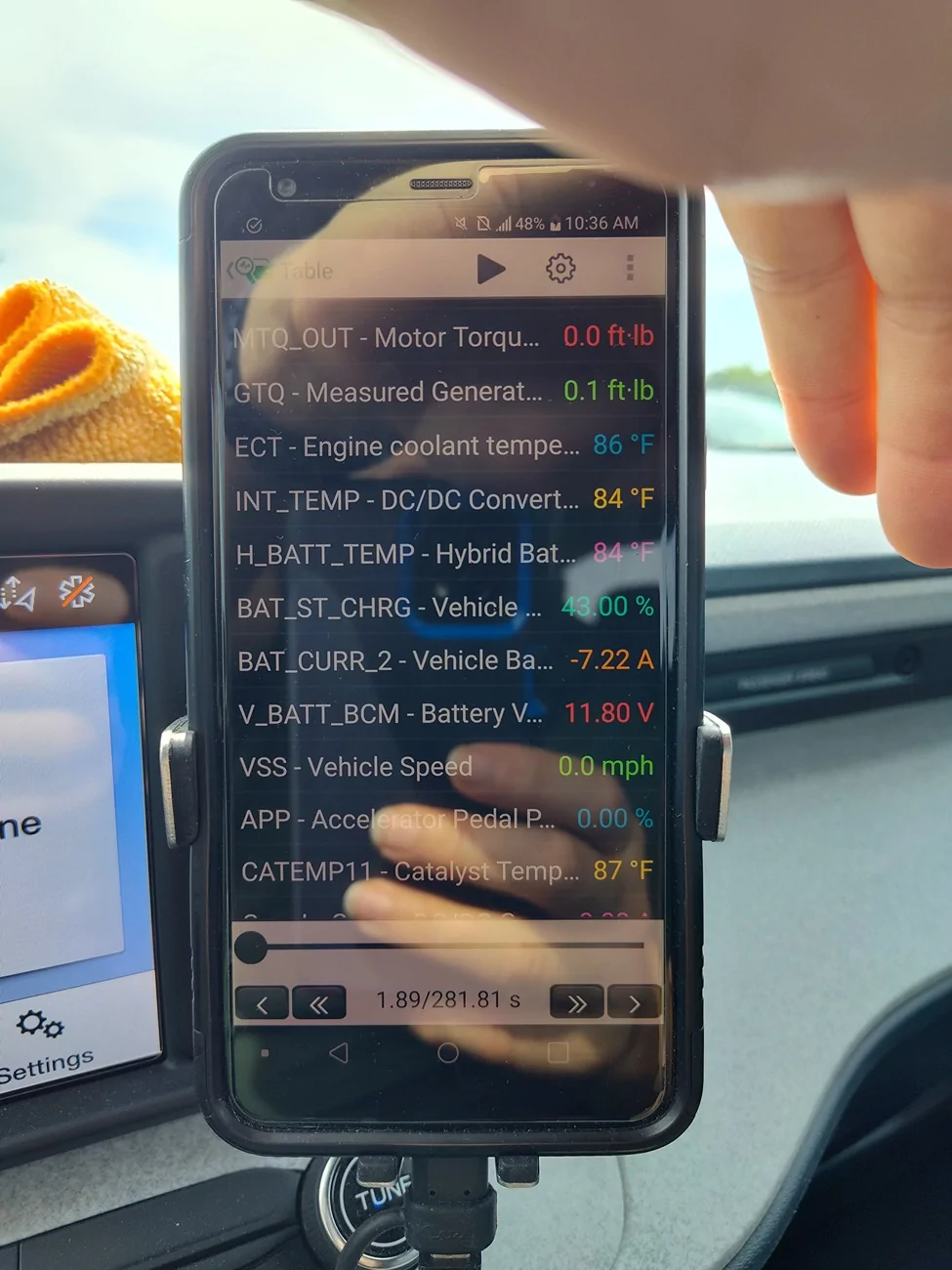

I could see the fail-safe charging level be very different between the hybrid and your EB.
EB with battery in the engine bay - potential overcharging not a problem. Well, not for humans - kill the battery sooner, not great.
Hybrid with battery in the cabin - potential overcharging really not a good thing.
Considering on the hybrid the SLA was allowed to only get to 85% before discharge would occur, and above 80% was only float level charge below 1A anyway - if the system had no sensor reading, and it can exactly control the Amps charging - I'm betting it'll be a bad level.
I mean - it's already bad, I mean worse level!
But - I'm going to test!
I'm hoping the PID's for some of the battery info are not only from that sensor.
But at the least, I can get a reading from the DCDC convertor low voltage circuit which includes the battery charge.
I know where that pretty quickly ends up, so it won't be too hard to tell what happens in the first 5 minutes.
