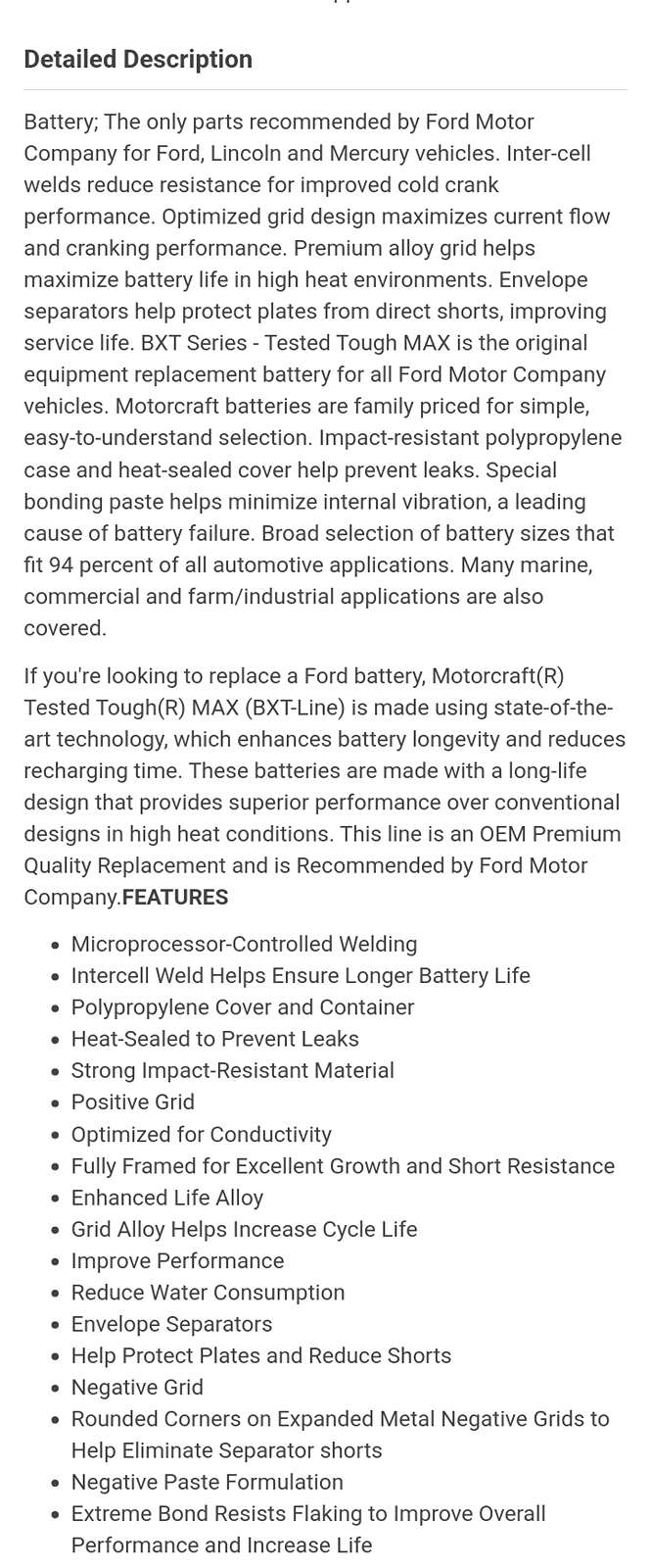

I highly doubt Ford put anything in but their bottom shelf Mastercraft. Here on the forums people have resolved the deep sleep issue by putting in an a better AGM battery.

Description of BXT battery line:
From O'Reilly's website for the battery installed in hybrid maverick! (FWIW)!

Ford's batteries are junk. Also Ford does not have an AGM battery for your hybrid. You need to get a 3rd party AGM battery as mentioned earlier in this thread. I know this would be out of your pocket and I am not sure if a 3rd party AGM battery is available for your to purchase in Puerto Rico...
