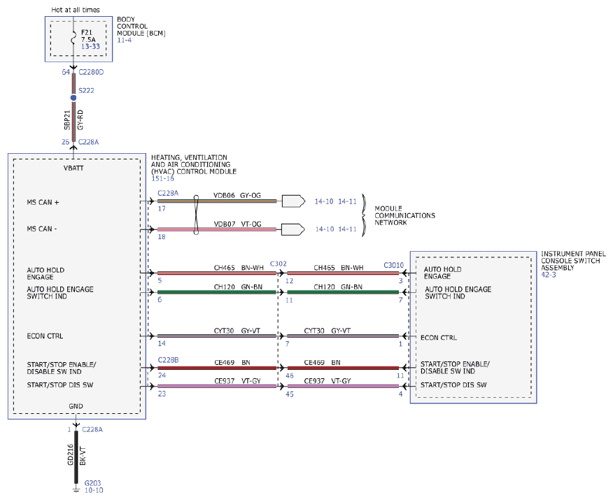

Very interesting that the HVAC module has anything to do with the drive mode selector. I did swap my HVAC module for one with the digital readouts over a month ago and thought everything was working fine.
I hadn't tried to change the drive modes until it rained and I wanted to see if I could tell a difference from Normal. Will have to see if swapping the modules back solves this.
someone posted a similar problem - and fix was a faulty A/C control panel module
not sure if related to your problem but could point Ford mechanic in the right direction
https://www.mavericktruckclub.com/forum/threads/drive-mode-selector-button-unresponsive.19171/

Looks like reading through that other thread that they didn't find a way to change anything in FORScan. I will have to swap back to my original HVAC module if I want to change drive modes as the Bronco Sport module doesn't appear to support that.
