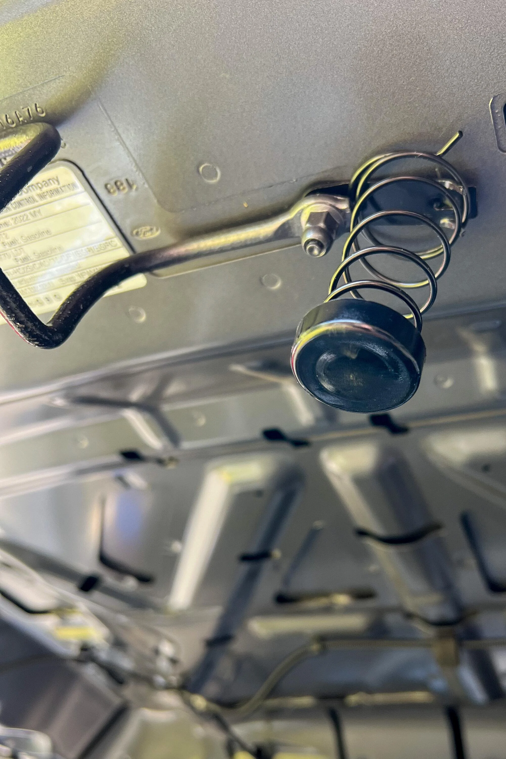

Fyi- after I installed a set of hood struts I adjusted the hood bumpers on each end. It put a little extra tension on the hood but kept it plum with the gaps and still level body surfaces. No issue opening my hood. And in fact after reading about the hood spring post- I may go ahead and get one of those to install. I like the hood struts personally- great to not have a prop rod in the way.

Mine just did it after readjusting hood after struct install. Didn't have anyone to hold hood down while pulling release lever so I pulled the lever completely back and put a piece of wood under it to keep open. Then went to the hood and pressed down slightly then pulled up. It opened. Adjusted the hood stops slightly to see if that helps.

According to the Owners' Manual, to release the hood, pull the lever, allow it to completely retract, hen pull again. On my recently acquired '23 Lariat, the hood unlocks on the first handle pull, but nothing happens on the second pull. Hood pops open, but does not release. Any suggestions?

The cable can detach from the back and just has to be reseated in the release handle. It can happen if you used the hood struts.
