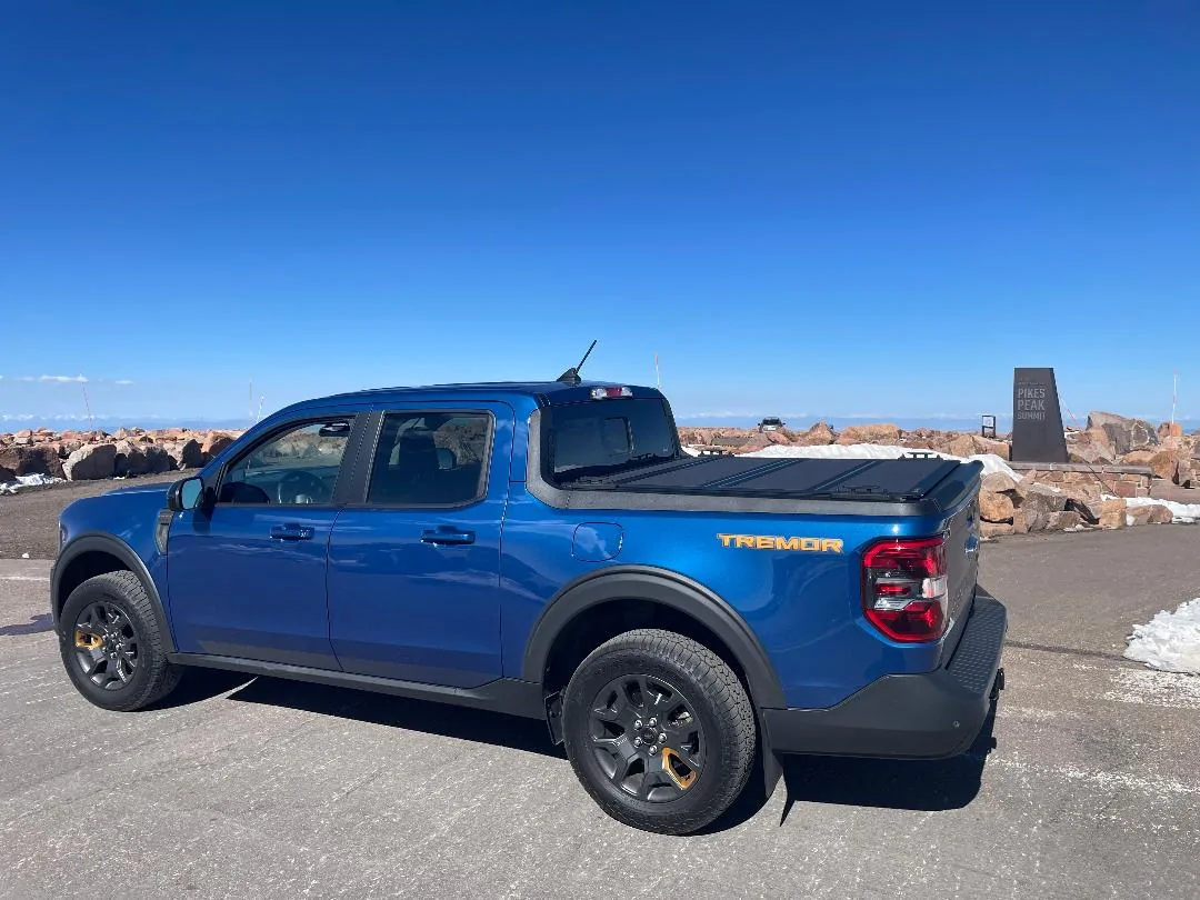

Here in Colorado Springs when visitors drive down from the summit of Pikes Peak there are checkpoints where the park rangers check the brake temperature. If their brakes are too hot they won’t let you continue until they do.
I did that drive in April, very early in the day, and there was no one at the brake check station. I still made a couple of stops to let things cool and let my blood pressure drop,,,,,,
HRG
Pikes Peak is worst case scenario:
Steep, hairpin turns, low speed limits, long duration.
