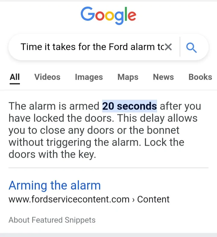

20 sec. has to lapse before the alarm is actually armed. I'm testing it now.
I tried opening the door immediately after setting the alarm and nothing happened.
This video is after the truck sat for a little more than 20 seconds.
So according to Google, only way to set alarm is the fob “key “in door, not buttons on fob or app? Maybe imma goin out in the sleet to check it out. 🙄

No - alarm is only set when Fob lock is used.
Wonder what happens when you arm it, but the slow kid takes longer than 20 seconds to close that last door?
Glenn?
Arming the Anti-Theft Alarm System
The alarm is ready to arm when you switch your vehicle off.
Lock your vehicle with your remote control to arm the alarm.
I left the key fob on the dash to show that I wasn't activating the alarm. (I try to make honest videos.)
I will make another video and post. Showing whether or or not locking the Maverick with the keypad also arms the alarm.
In an earlier post I made a video showing that unlocking the door with the physical key will also set off the alarm.
Glenn?
The alarm arms itself 20 seconds after the last door is closed.
With the tailgate or door open. I can set the alarm with the key fob and keep any of those doors open until the last one closes and then it arms itself.
I hope that makes sense.
Oh good - because the manual doesn't give a time, but it says lock it with the fob to arm it.
And you can close the doors after doing lock all on the fob.
Seems the 25MY differs on trim perhaps. Good grief.
