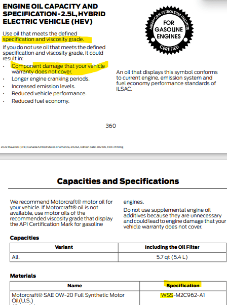

Well did the first oil change today on my hybrid XLT at 2150 miles. Oil looked pretty clean and not dark at all, but wanted to get some quality oil in and also the bigger Motorcraft FL910S filter to replace the smaller stock one. My oil life indicator was at 87% oil life left. Besides a bunch of torx head screws to remove the plastic belly pan, the 15mm drain bolt w/incorporated rubber seal and easy access to the filter made the oil change a breeze. 5.5 qts of oil was perfect after a warmed-up oil level check, it was 3/4 of the way to the full mark.
I ended up using Pennzoil Ultra Platinum 0W20 (their best oil) after watching it perform 2nd to only Amsoil out of nearly every manufacturer (see video link below). The winning Amsoil signature series 0W20 is $120/gallon , I love my Mav but not THAT much. Pennzoil currently has a $25 e-gift card rebate offer on two 5qt bottles. The oil is $33.03 + tax per 5qt bottle, and the Motorcraft FL910S filters are only $3.97 + tax (both on Amazon see links below). So considering the Pennzoil offer, 5.5qts of the oil plus the filter cost me $29.70 total (shipped, after tax, and minus the $25 e-gift card).
