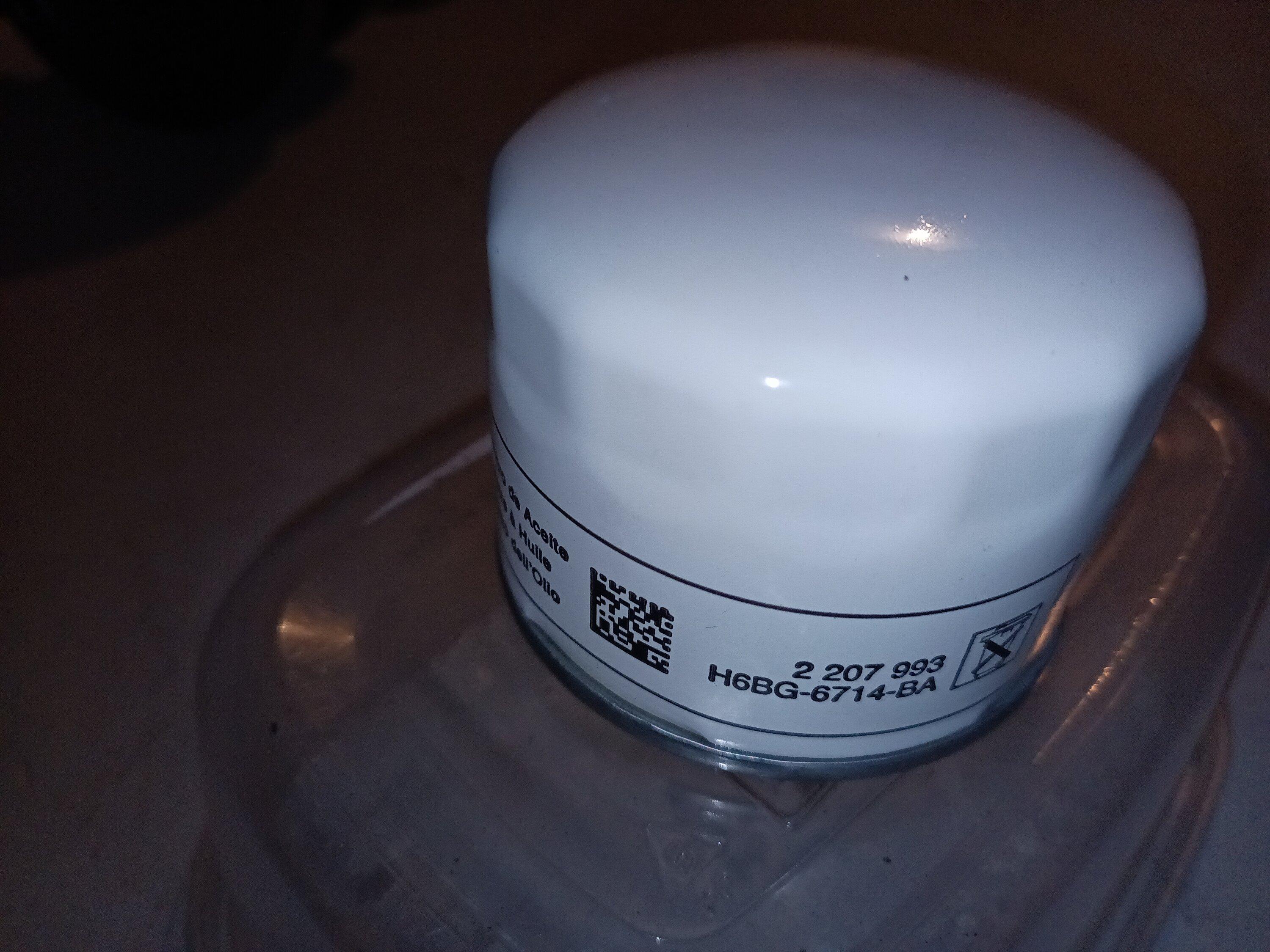

I did a "break-in" oil change today on my 2023 Ford Maverick Hybrid. The factory filter was surprisingly a Ford / German Mann filter with part number H6BG-6714-BA and not a North American Motorcraft filter.

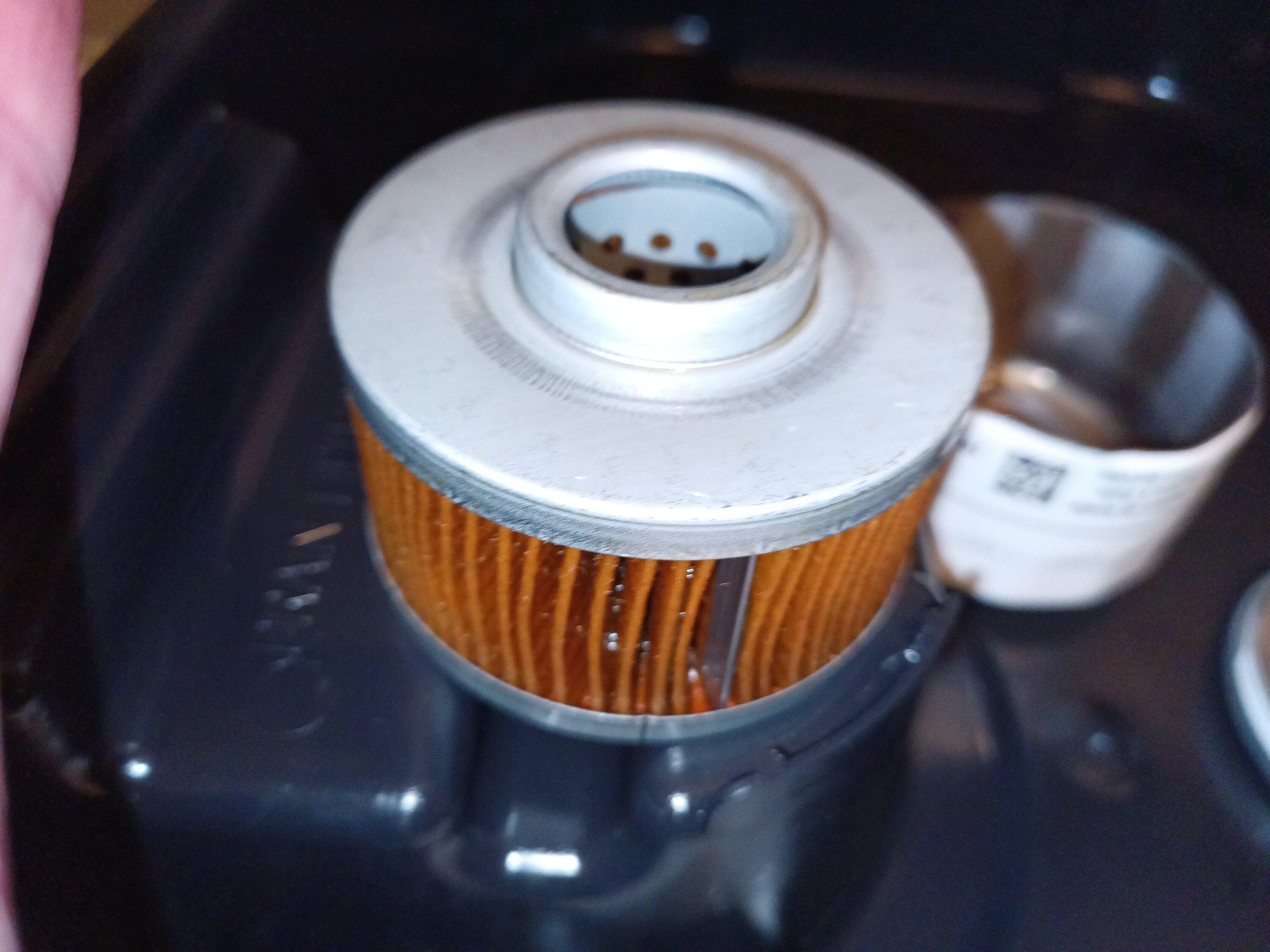

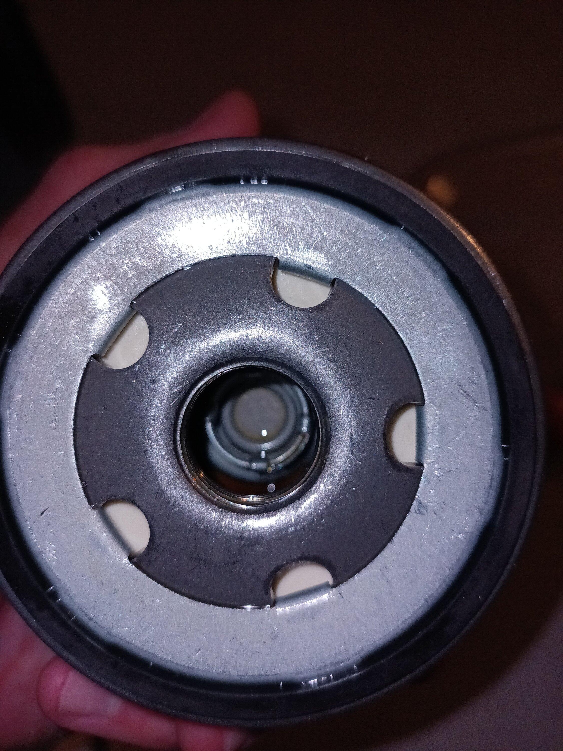

The German made Mann filter has a white silicone anti-drainback valve. I cut it open and the media is an enhanced cellulose with metal crimp. Very small filter but quite well made with a lot of media. Wish I could buy them in the US.
The factory filter was thankfully not painted over and not over tightened. The drain plug was also not over tightened. So the initial oil change was really speedy.
