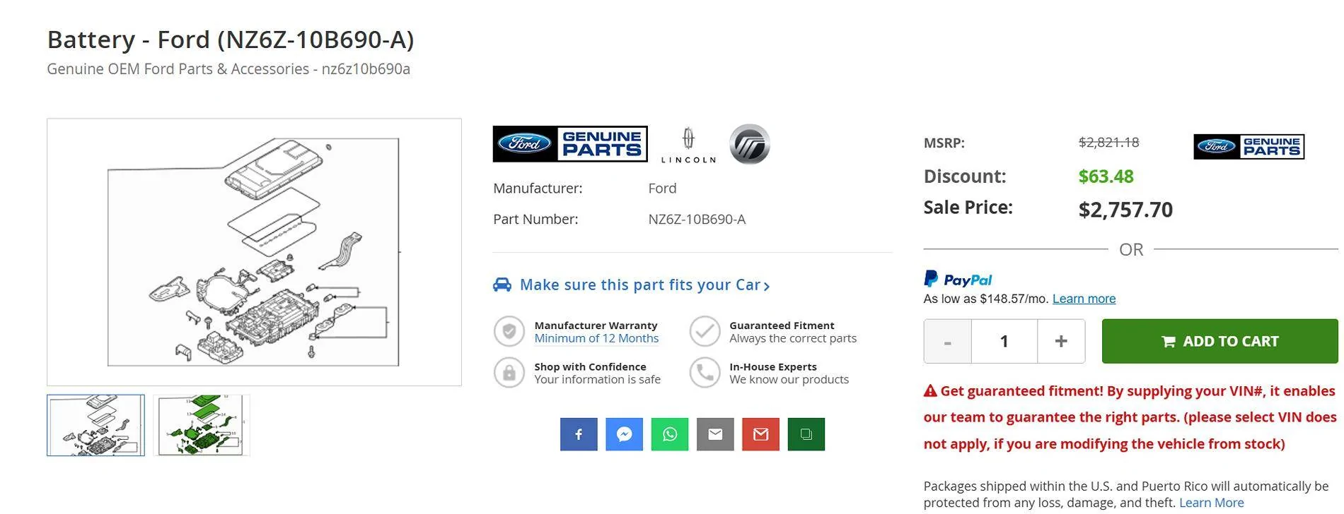

Just looked up the cost ofEV batteries, which are expected to fall to $100 per kWh by 2026. The Maverick battery is 1.1 kWh.
The retailed packaged unit costs are likely 1.25x to 1.5x higher. Also that would be for large packs.
Ie for a 100 kwh pack in a EV, a new battery pack would be roughly $15,000.
The Maverick's pack is around $2700:
Ford Maverick Hybrid Fuel Savings vs Battery Replacement Cost (With Inflation Adjustment) 1742827420701-jl
Hopefully, by the time it's needed, someone will have figured out how to rebuild the 1.1kw battery inside the unit instead of doing a drop in replacement. I have to admit, if you could rebuild it for under $500 that would be a huge benefit for older hybrids.
The current battery is heated/cooled and kept within a reasonable temp range, as well as being used from 30%-70% of its capacity. This will greatly prolong its lifespan - with the durability of the 2.5l ICE these things could go into 15 years of service without needing a new battery.
