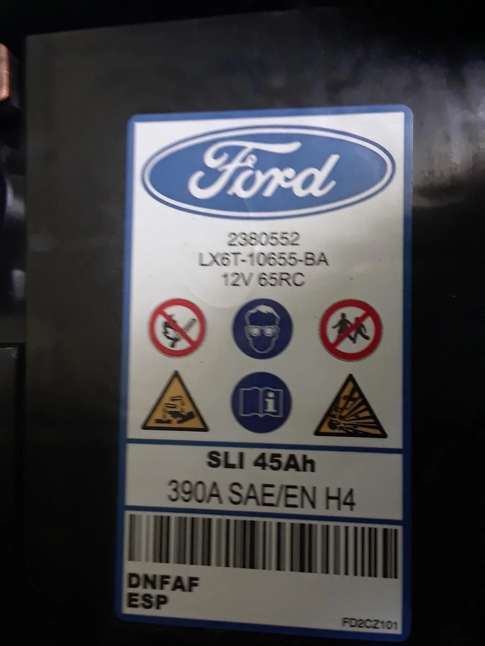

See pic. I have h4 battery. That means size?
Therefore a h5 battery would not fit my space without alterations. Right?

Ford Maverick Hybrid +12V Battery Replacement battery pic
melnycm
Mel
Jul 8, 2024
NS
2023 Mav
thanks for your reposne.

That's not even the current battery used - it's likely only what they had at the time of build.
It's been upgraded perhaps also due to issues with that smaller one.
The space can hold bigger battery than H4, but as comments point out, too big doesn't fit either.
Obviously the space can hold smaller batteries too.
And the battery spec makes clear in the manual - Group 99R (meaning Positive terminal on right), or T4.
This is likely the max size without modifications being required. Length has maybe another 1/2 inch, height maybe 1/4".
If you can find another H4 that has better specs - go for it.
If you can find a better 99R/T4 with better specs, or the same but not Motorcraft - go for it.
When it's time.
As most of the threads on this point out - while the specs may be fine for the simple job this battery needs to perform on a hybrid (like CCA don't matter much) - Ford's Motorcraft built ones seem to do a poor job with quality. (and the truck settings dealing with it recharging aren't helping any in some use cases).
