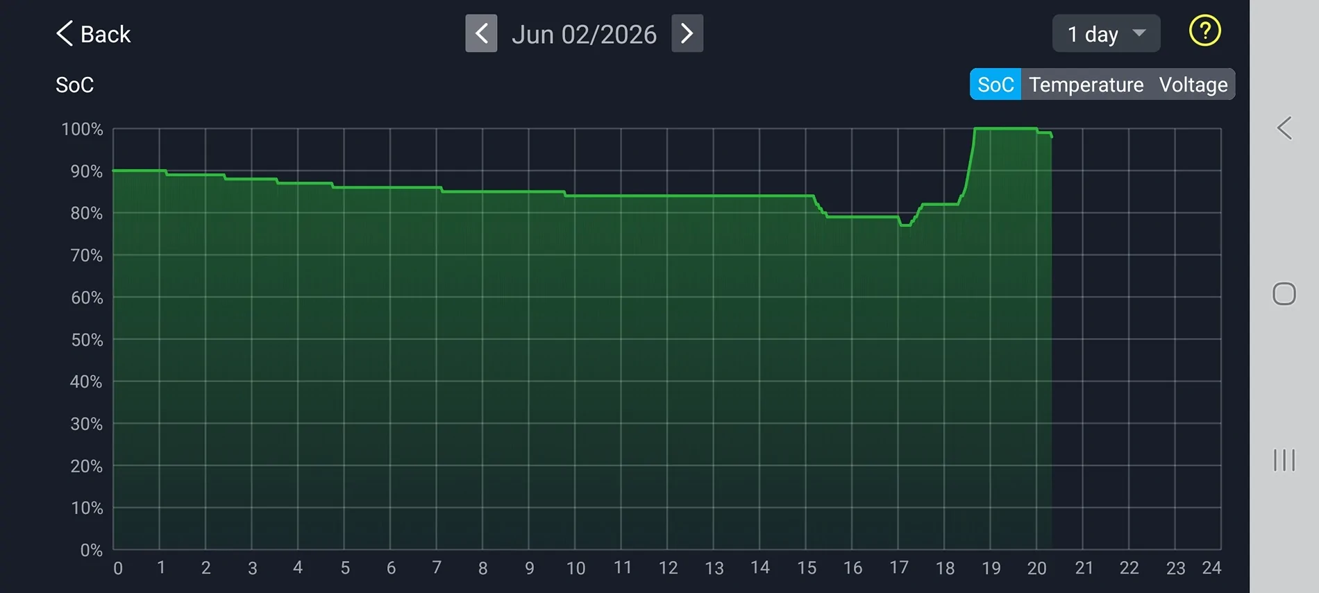

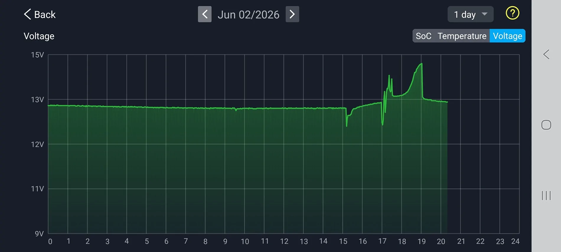

Well, the only "hack" as you describe I got to do when I got home today to my Maverick that is still on the NOCO maintainer was to turn the headlights on and then I notice the maintainer starting to ramp up both voltage and SOC and it has gone to 100% SOC.
I mentioned in a previous post of hooking up my Curt trailer plug tester to simulate a trailer load but discovered the Curt tester is only setup for 7 pin trailer plugs and my Maverik just has the 4 pin trailer plug 2.5K tow rated package so that did not happen.
I am wondering if I hook up the maintainer directly to the battery instead of the jump connection points under the hood if it will natively charge to 100% SOC without truck metering it down like it is now?
As to me starting another thread, that is not going to happen by me. Not that invested to take ownership of another thread on this subject as I thought posting here was appropriate given the similar situation. I did not think I was steering the OP's topic in a dissimilar direction. 🤷‍♂️
The truck's system just aren't involved in external charging since it's not on. They aren't metering anything down. I sure hope you don't have the truck on!
Might read the charger manual to discover those instructions.
You added a load while charging - so the voltage went up - to be expected.
Again - that battery monitor SOC value is based on Voltage.
That's all it can be based on - it's not getting any other reading.
Charging voltage - truck or charger - is over whatever value you told it was the top battery value.
It's going over that while charging - that's 100%.
You can't get an actual SOC figure based on voltage while charging, or discharging - it's incorrect. Actually - you can't even get an accurate voltage reading that means anything regarding the battery health - unless you let it sit for hours.
Best we can get is a morning reading.
The end of a charge cycle is supposed to be lower voltage - read the manual - happens to be lower amps too. May be no amps if in maintainer mode, when you happen to look.
So the fact you came home to a charger that's been on the truck for awhile with fully charged battery, and found that is wasn't putting out charging voltage - is what should happen.
The fact you added a load and the charger increased it's voltage because it saw the battery draining - is what should happen.
So you are making a lot of observations on incorrect figures from the battery monitor that doesn't actually tell you anything about the truck charging system when you have it turned off and using an external charger.

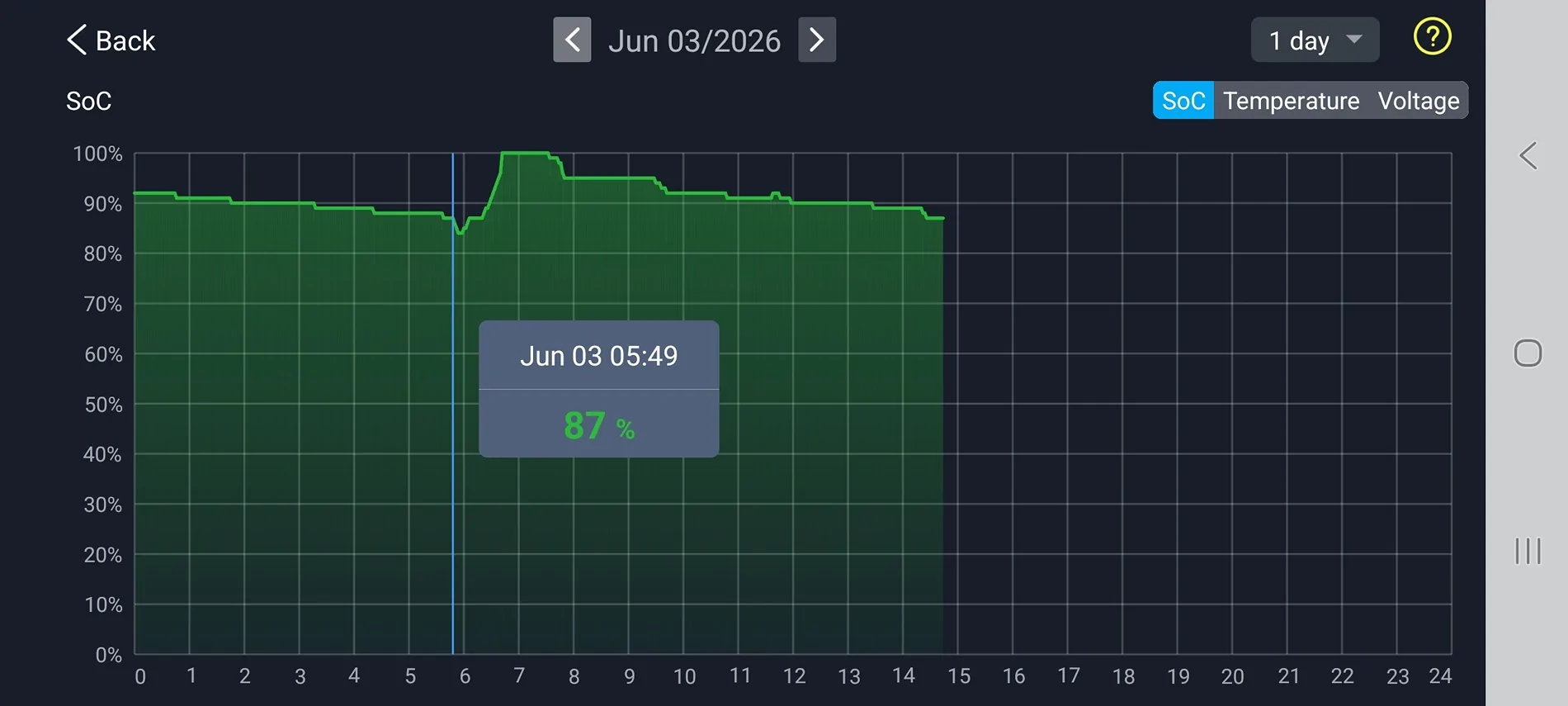

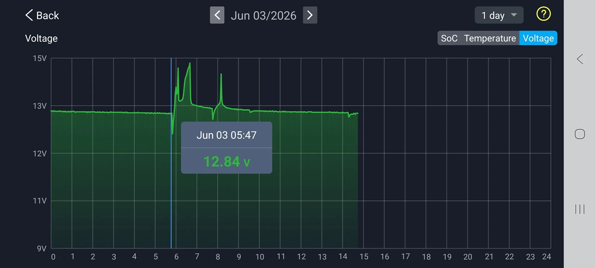

Well, I am done chasing my tail on this and @HeyBales is right on my maintainer just reacting to the loading and unloading.
I left for work this morning and checked on the Maverick that was still sitting with the maintainer hooked up to the jump points under the hood and noticed on the ANCEL app that the stated charge was around 87% and had ramped down from 100% from the previous days experiment of just turning on the headlights and the maintainer ramping up from that.
I moved the maintainer leads at that time from under the hood to directly to the battery posts themselves and left for work. Doing some other things I got a temp 3 days Ford Service info subscription and logged into and it showed the telematics from the vehicle had reported at the same time I moved the maintainer leads to the battery that the vehicle was reporting 89% battery health. With a difference of only 2% from my ANCEL monitor device and app, that at least shows it to be reasonably accurate info it is logging.
Got home this afternoon and checked the ANCEL monitor device log and it showed a now to be expected ramp up to 100% briefly because I disconnected/reconnect the NOCO maintainer lead and then slowly ramp back down to a shown 87% @ 12.84VDC and has been roughly maintaining that so far the rest of the afternoon.

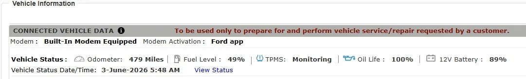

In digging around, there seems to be some variance in what resting voltage constitutes a 100% SOC voltage for a AGM battery? Seems anything from 12.80 to 13.00 VDC is considered a 100% SOC. Given what I am seeing, I am not going to pick the fly shit out of the pepper of what the vehicle is reporting or my ANCEL monitor is as the resting voltage seems to be in spec although on the low end of what is acceptable.

Your catching other big drops after a drive though will be entirely useful with those graphs.
Actually - during a drive if you see charging voltage go to 12.8 - then you know the point of this thread is happening.
Discharge.
And whatever SOC% your Ancel shows right then - is 92% in the Ford BMS.
