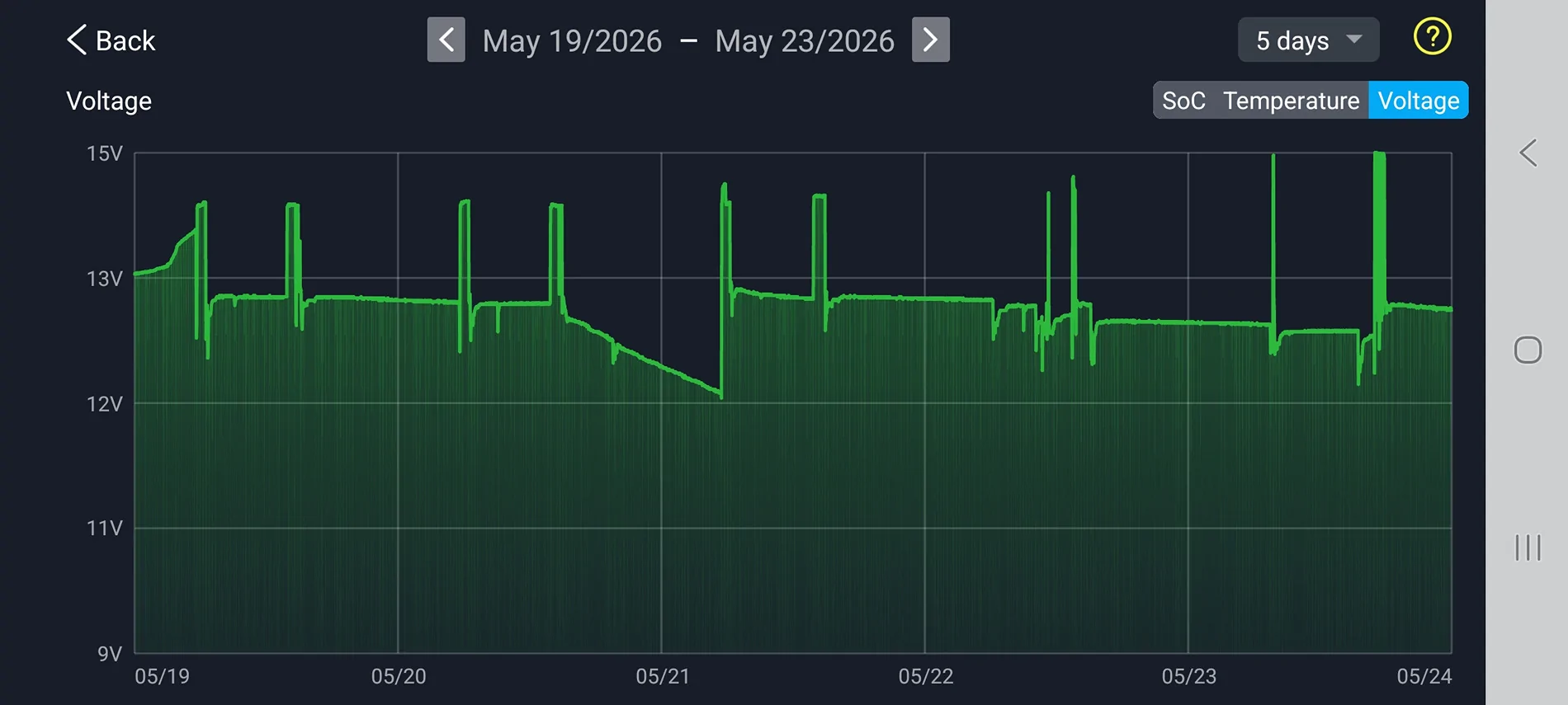

@HeyBales, Sorry for resurrecting this post from page 13 of this thread, but I have a theory that I would like to have you consider!
I don't have the tools, time or patience to pursue it, but you always seem game! 😁
My theory pertains to this statement of your's:
"Sorry if this is coming off harsh - but I keep seeing this disconnect between 2 different problems.
And I'm always posting about someone checking on the ACCM update when they report a drain condition.
But this thread is the first time something has been found to force higher charging to keep a battery from getting undercharged and slowly go bad.
It's not doing that because there was a parasitic drain, just the normal micro-drain."
I agree! Two completely separate and battery damaging parasitic drains!
My theory (which I can in no way prove or defend):
These two parasitic drain happen independently and at different times.
One of these, the conventional parasitic drain comes upon vehicle shutdown and drains the battery! Ecoboost and/or hybrid - makes no difference.
The other parasitic drain, the one that happens as soon as the (mostly? hybrids) vehicle is turned on - causing the DC to DC converter to kick into action!
This parasitic draw is huge! Enough to drop my 2025XL's 70mph gas mileage from the 36 -37mpg I am currently seeing, down to the 30mpg I was getting before the trailer module update!
The trailer update has fixed this huge parasitic draw! Just like the ingenious "headlights on, wipers on, parking lights on, rear seat 120V outlet usage, and hitch brake light on" hack has been shown to circumvented this same parasitic draw!
The TMU came too soon for me to test whether the hitch light etc. would have increased my highway mpg, in addition to normalizing my 12V battery charging!
I hope someone who hasn't had the TMU yet can test that.
How can a parasitic huge drain reduce gas mileage?
Easy, the motor generator has to work at essentially 100% output (for it's given engine speed?) to satisfy the parasitic electrical drain.
Why doesn't the battery get charged?
Likely, the vehicle's electrical systems' "need" has first dibs on the electrical power supplied by the DC to DC converter, so the battery gets starved...Until higher speeds and longer drives allow the motor generator to finally supply enough electrical supply to satisfy both vehicle needs and battery charging!
That's it!
I'll entertain questions, but it is unlikely that I will be to answer any of them! What we need (I think) is a hybrid vehicle electrical design engineer.

My post is just a theory to be be considered since I don't have the ability to investigate it myself.
As far as the parasitic drag I believe I am seeing, it is a huge parasitic drag, not the small milliamp drags associated with conventional electronic components.
The tow/haul mode idea is interesting, but I can't really evaluate that effectively either.
Along with the improvement I have seen in battery/charging since the trailer module update, I have also noticed that the Electric mode is more eager to spontaneously take over than it was pre-update. Not a huge difference, but certainly noticable (FWIW).
As to the (instantaneous or not?) mileage numbers that I have reported on my, pre and post update, gas mileage reports: those numbers are cumulative results as shown on my average economy display on the on the drivers display.
The comparison isn't perfect as I had to base the "pre-update" highway number on what I have seen over the last 11 months pre-update.
I wish I would have known to do a "pre" mileage test, but I never associated a trailer update with a possible jump in mpg's.
So it is true, this is only a theory with absolutely no verifiable data! I will continue to watch my maverick hybrid's battery situation to see where it goes from here!
My hope is that some curious hybrid owners will try to confirm my suspicion that the trailer module update has normalized or maybe fixed the 12V battery charging problems we are seeing, and that their highway mpg's have increased since the update.
I am also hopeful that the TM update will help MY22-24 when it becomes available.
Good luck to all!

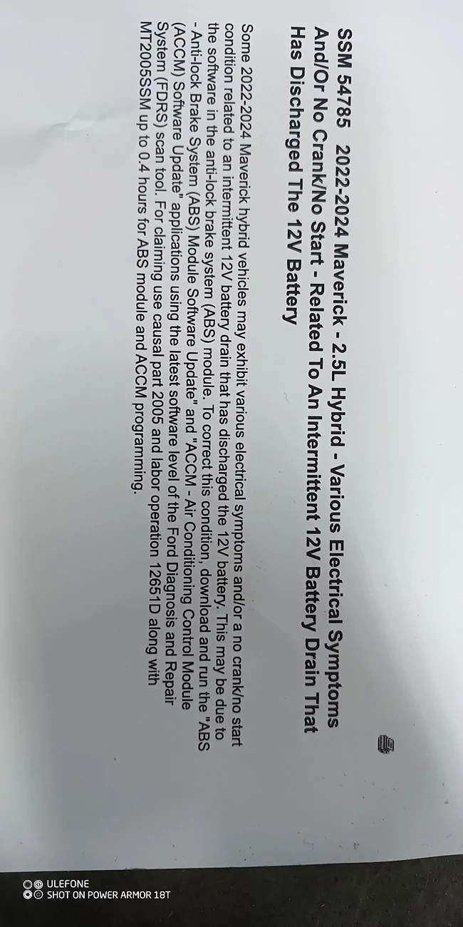

PLEASE get the ABS and ACCM updates done and share with us if it worked short and long term. I don't know if anyone has had the most recent updates performed to see if they actually work. Right now we're debating what we think will or won't work
Talked to service writer and he said he knew of no updates that you mentioned that would help. How do I know if I have those updates. Are they over the air, recalls or SSM's
He said drive it more and turn off auto updates. From his comments nothing is really being done by corporate and left to the dealerships.

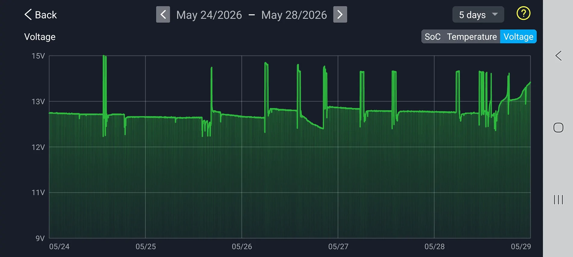

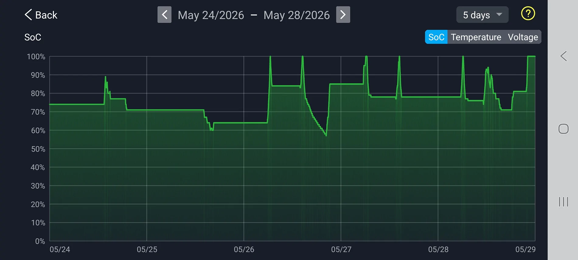

Thanks for drilling down on this and am glad I found this thread.
I bought my 2026 Maverick XL AWD Hybrid (2-26 build date) a couple of weeks ago and recently put it on a NOCO Genius 5 trickle charger the last couple of days and was wondering why it would not keep a SOC past 86% over time? I changed lead positions of the charger to a different ground and it briefly popped up to 100% SOC and now has settled down in the mid 80's% SOC again.
Plan is tonight plug in a Curt Trailer Plug tester that simulates a trailer and see if that tricks the charge profile to go to 100% SOC and maintains? If that does the trick, will leave that on as a work around to when or if the software gets changed on this charging system.

So that SOC% is not the Ford's system reading, correct, but an external charger/volt reader where you tell it the battery info?
If no battery info was supplied - it's just using standard table for Voltage = SOC%.
Just be aware that most the posts in this thread are talking about Ford's own calculated SOC%, read straight from their system via scanner.
So your reading won't necessarily match.
In fact - if you aren't providing battery details, and it's not reading amps along with Voltage - that battery monitor can't really give a SOC% while it's being charged or discharged - just not accurate or possible.
Pre running voltage is great though - gives an indication of what direction the battery is going.
If you are talking about plugging in that hitch tester, and then setting up the Noco - wrong idea on the methods given in this thread.
BMS system has no control over an external charger, and truck better not be paying attention to what's in the hitch plug when it's off - otherwise you got a problem.
Those methods given are when the truck is running.
It's for getting the truck's own BMS to charge higher than the 92% SOC.
Your battery monitor seeing 14.x volts while running probably is why it shows 100% SOC.
So where your voltage monitor could come in to play - is when it shows 12.8 V while you are driving at some point.
And you do NOT have headlights on, fan on 6, hitch light plugged in.
That means you reached Ford 92% SOC, and the BMS is willing to stop charging.
Now put one of those on - and you should see Volts go back to 14.x.
Now that you have charged the battery - let that 9 hr Relearn happen Safetyguy mentions.
And you will likely see that 12.8V while driving.
And don't worry about the SOC% in that battery monitor - it won't match probably.
Just morning resting volts.

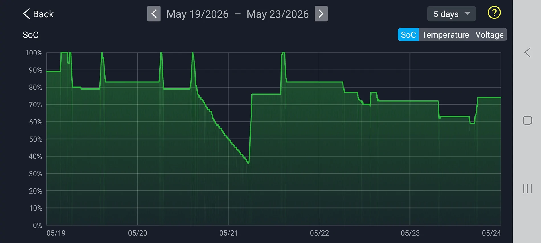

No, no yet. Just found this thread this morning while at work. Probably will play with it a bit later tonight when off work.
What lead me here was looking at my battery monitor graphs for the last couple of weeks and was surprised of how little the vehicle charges to 100% SOC. Left work one day on 5/21 and surprise to see the battery SOC drop to 35% just sitting at work for 8 hours. There was no indication it was in any battery saver mode and started up with no issue.
Until this thread, I was perplexed on why it would not charge to or near 100% SOC.
I use a ANCEL BM200 batter monitor device that hooks directly to the 12VDC battery. It is setup with the battery type and voltage parameters.
The graphs in my first post is from the last 2.5 days with it sitting just on the NOCO maintainer. Remaining graphs are from days prior when I was driving the vehicle.
Regarding your images - be curious to see the Voltage side of it.
That will be better info than SOC due to what I said in last post.
ETA: Knew that was likely the Ancel, many have it. SOC% not as useful as Volts.
Regarding those 2 big dips.
Evening or middle of night?
Early morning or normal morning for you?
Recall doing something in truck with doors open if not middle of the night?
You have OTA updates enabled?
Do you have a set time, or default anytime?
See any updates on those days of the dip?
How is your ATT signal in your area?

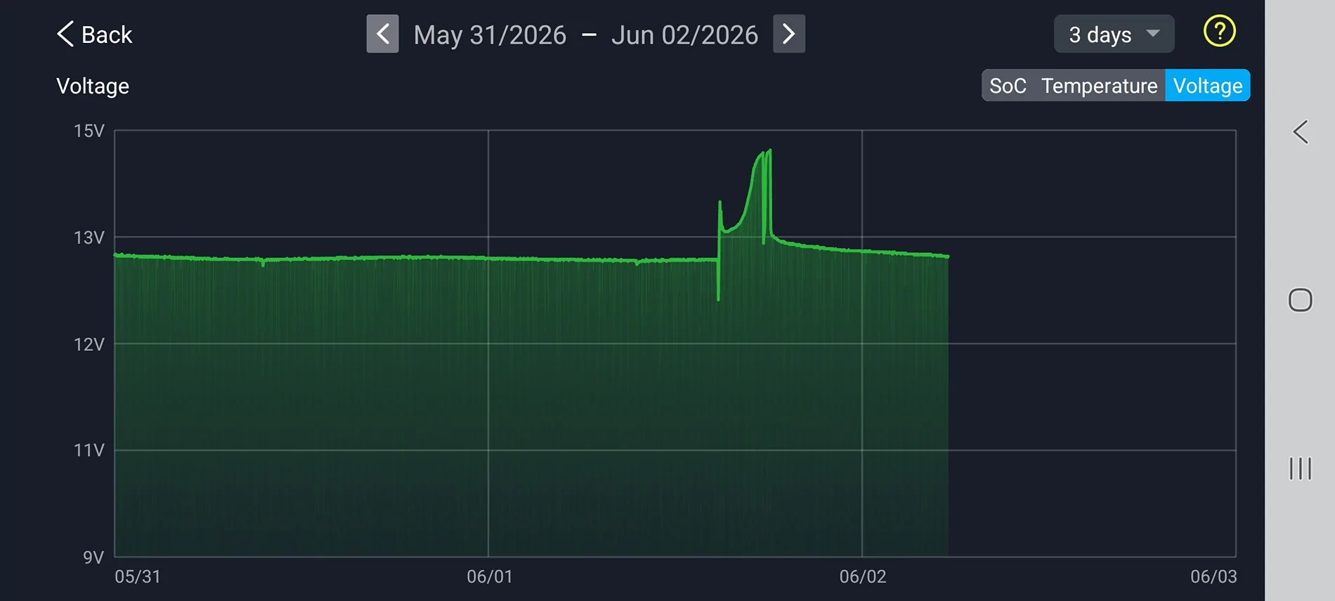

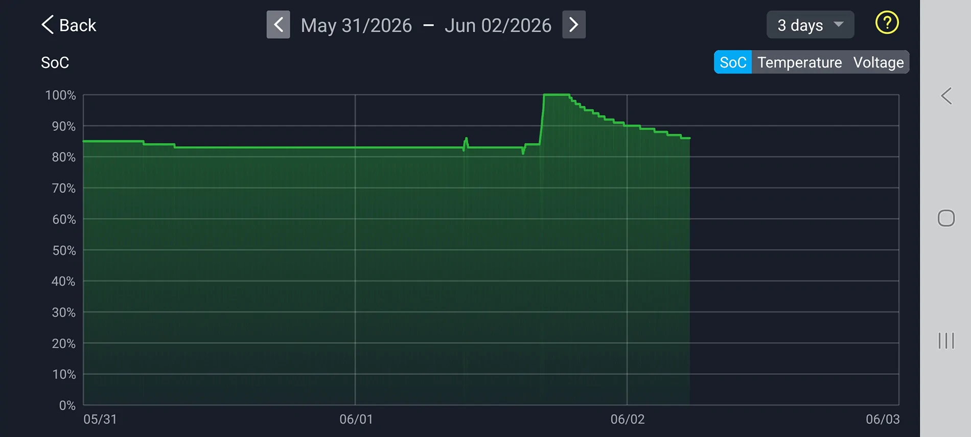

Dip was Saturday night into Sunday morning.
OTA enabled and set for 1 am. Did not check for updates but am familiar with the process as I also own a Bronco Sport.
Cell signal can be spotty but 60% of the time, works every time. Have also setup to use the house wifi which is a stronger signal
The service advisor/techs are LAZY. All they have to do is pay attention. If it's a 2025 the TSB is 26-2170. If it's a 2022-2024 it's an SSM . That number is SSM 54785. All they had to do was either
A. Pay attention to the daily bulletins They were issued on April 16th and April 28.
B. Enter the VIN , enter the symptom under battery or no/slow start . Then this bulletin number and some older bulletins would have shown up . Go back ASAP (sometimes the same number changes) and give them the number I gave you based on your model year.
Better yet, show this to them . Please don't let them know where you got it.
