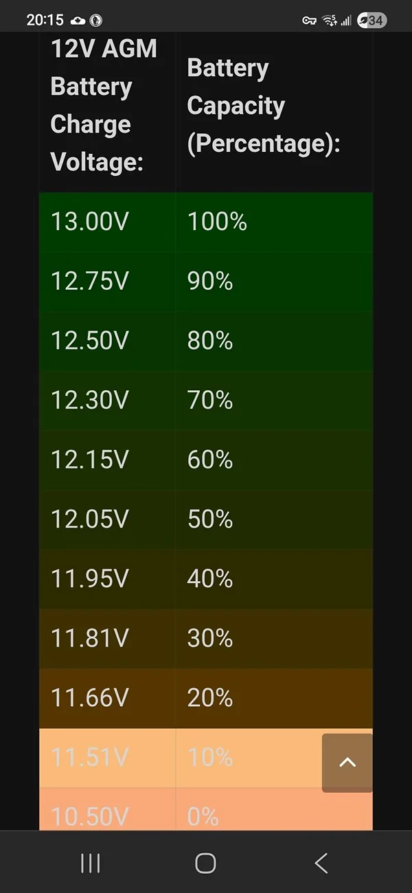

Good day
(I get the same 14.3 volts indicated on my voltmeter while driving...what changes here is the amperage level, which we can not see as easily).
But, I do see my charge level the next day when I check my battery with my voltage tester...I pop my hood when I get home so I can check the charge level at the boost points with out waking the truck up again.
I have a tail led light in my Hitch receiver and it is plugged into my 4 pin trailer socket. My battery is always above 12.8 volts every morning after I have driven the day before....no more over and under charging my battery!
@Mavster Mechanic has been monitoring his 12 volt electrical charge state and has concluded that whenever you drive, either:
1-Turn on your headlights,
2-Turn on your park lights, or
3-plug in a tail ight into your trailer power receptacle (either one if you have a tow pkg).
These three things seem to turn a swith on in the truck so that it charges your 12 volt battery properly!
It is my thought that everyone should also try to get their truck to do a battery relearn to know what a fully charged battery is by carrying out a full battery recharge with a smart charge (at least 4-5 amps).
Not a quick surface charge, but a proper full charge and then disconnect the charger, lock the truck up and leave it for 9 hours...may take several tries to get the truck to do a relearn, but is worth it.
Combine that with one of the three items mentioned above, it may help you with your seriously undercharged battery!
I hope this helps, it works for me.
Andy
Edit to add agm charge chart
