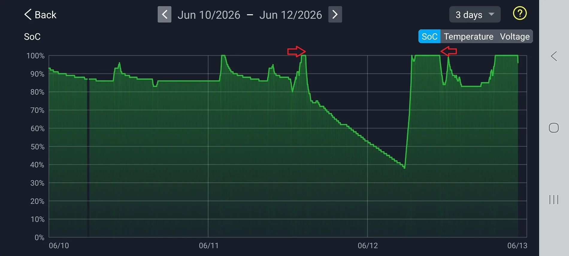

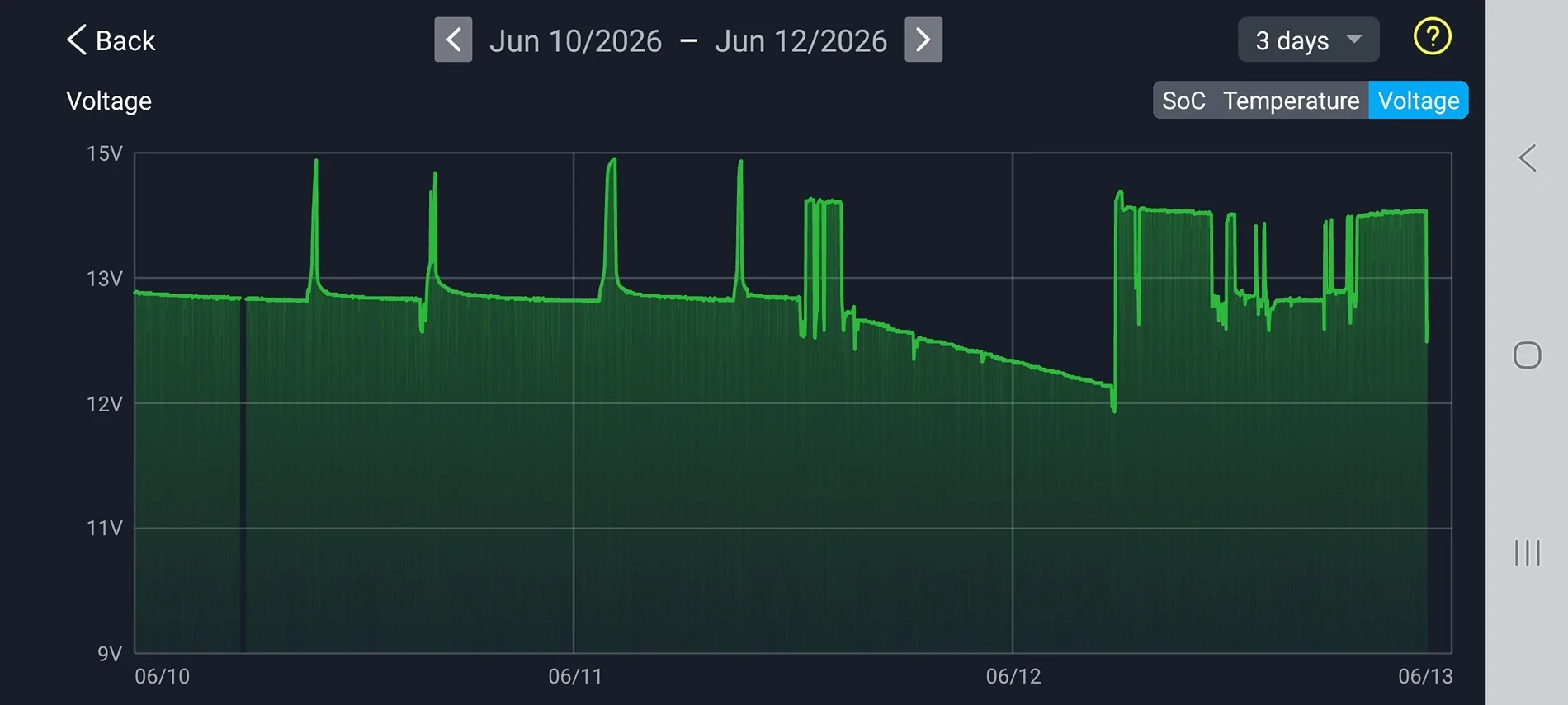

Good day @Hootbro
Hmmm, interesting. My thoughts run to possible causes of your drop in battery voltage.
First thought I have is that the trailer may have had an electrical issue, but I would think once you turn power off on your truck, that circuit should not be "awake"? I leave my hitch light in and have not ever noticed a similar depletion.
2nd thought is isolation. Can you plug on another trailer (or light that plugs in to your trailer plug)? Reason being, we are trying to see if the event is repeatable....or was it a faulty trailer...
It looks like you had the trailer plugged in for several days, but only discharged over one night?
If true, then was it coincidence that you happened to have a occasional deep parasitic draw down of the battery?
I am only looking at your provided charts so I may have interpreted incorrectly.
So my next question is, have you had all the module updates that @Darryl has been pounding the drum over, trying to get done if an instance like this happens and your battery is suddenly depleted?
You have the monitor, so that makes this very interesting to me.
Did you see the trailer lights on in the night after you shut down, when they shouldn't be, by any chance? You would have said it, but just covering all the possibilities. If so, then there is a problem in the truck that the trailer circuit is still energized. I know my trailer plug light is never illuminated once I shut down.
Again, it is my belief that once the truck is turned off that the trailer circuit would be open, as we don't want an attached trailer with an electrical fault to kill the start battery!
Anyways, interesting stuff. I hope we can figure out what happened in your instance, and have yourself a good day!
Andy
Edit to add...when troubleshooting an issue, I was taught to try to break the system in halves. In this case, that would be the trailer plug in your truck...if you plug in another trailer, (or voltage meter) and you get the same issue, it is the truck that is responsible.
If the problem disappears, it is most likely the trailer responsible.
And if it an occasional excessive parasitic drain, definitely get the module updates done ASAP.

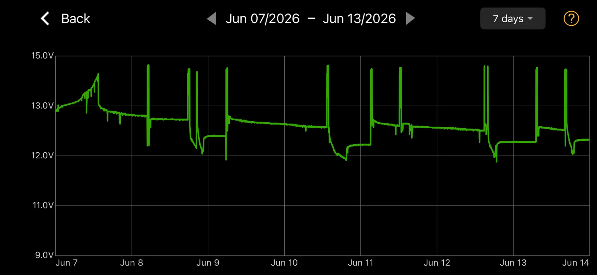

Nothing was discernable to me that it would have a electrical issue. Trailer was relatively new looking and pass all light checks when hooked up and nothing status on the dash that there was anything to indicate a light problem.
I have nothing else at the moment to plug in and try to repeat the situation. Does pique my interest to possibly getting or making a dummy load to hook to the 4 pin. Do not have 4K package so no 7 pin connector, just the 4 pin.
Trailer was only plugged in for less than 24 hours at the two red points on the graph. It sat shut off from 3:00PM on Friday until I started it at 5:30AM on Saturday and that is marked at the low point of the graph and then drove it and delivered what I was hauling and turned it in at 1:00 PM on Saturday.
My truck has a 2/27/2026 build date and would assume it has the latest coverage until that point for updates. I did briefly a week ago had a Ford Service subscription and it showed no available updates other than something for ABS.
Only lights that stayed on were the normal exterior marker lights that stay on a few seconds after shutting off and exiting the vehicle. Nothing was noticeable staying on after that.
I would normally think that also but after looking at the schematics for the trailer system, it is not as analog as other vehicles in the past and goes into the Trailer Tow Module, battery junction box and a blackhole of whatever circuitry controls them.
Trailed was only plugged in for less than 24 hours at the two red points on the graph. It sat shut off from 3:00PM on Friday until I started it at 5:30AM on Saturday and that is marked at the low point of the graph and then drove it and delivered what I was hauling and turned it in at 1:00 PM on Saturday.
Thank you for all your clear answers, even though it does have me scratching my head.
I have the tow pkg, but my Hitch light is plugged into my 4 pin trailer plug.
I know I have had one in the past, and it is a simple 4 pin trailer plug tester. Inexpensive, cheaper even then a simple trailer plug in Hitch light to see if plugging anything at all into your trailer plug initiates a 12 volt power drain.
Yours is a 2026 and 4 pin only, so possible a different trailer plug gremlin is raising its head, but let's keep things simple as possible by trying out a simple trailer plug light or similar, and see what your monitor tells you!
I know I probably lent my 4 pin tester out to someone in need, and promptly forgot that I had done that...par for the course, but next time I am at Canadian Tire I will be looking for a replacement lite checker, as now I am missing it for test purposes!
I hope we hear back from you if you try any tests or tow again (or just plug a stray trailer into your truck for test purposes), as this is very interesting and I am always interested in trying to find out what it is and fix these tricky issues.
(Final thought, if it a new gremlin related to battery drain, it is a good time to try and figure out if there is an issue, and get Ford to sort it as you have that monitor to validate your concerns...warranty is the best way to not waste your own money on something).

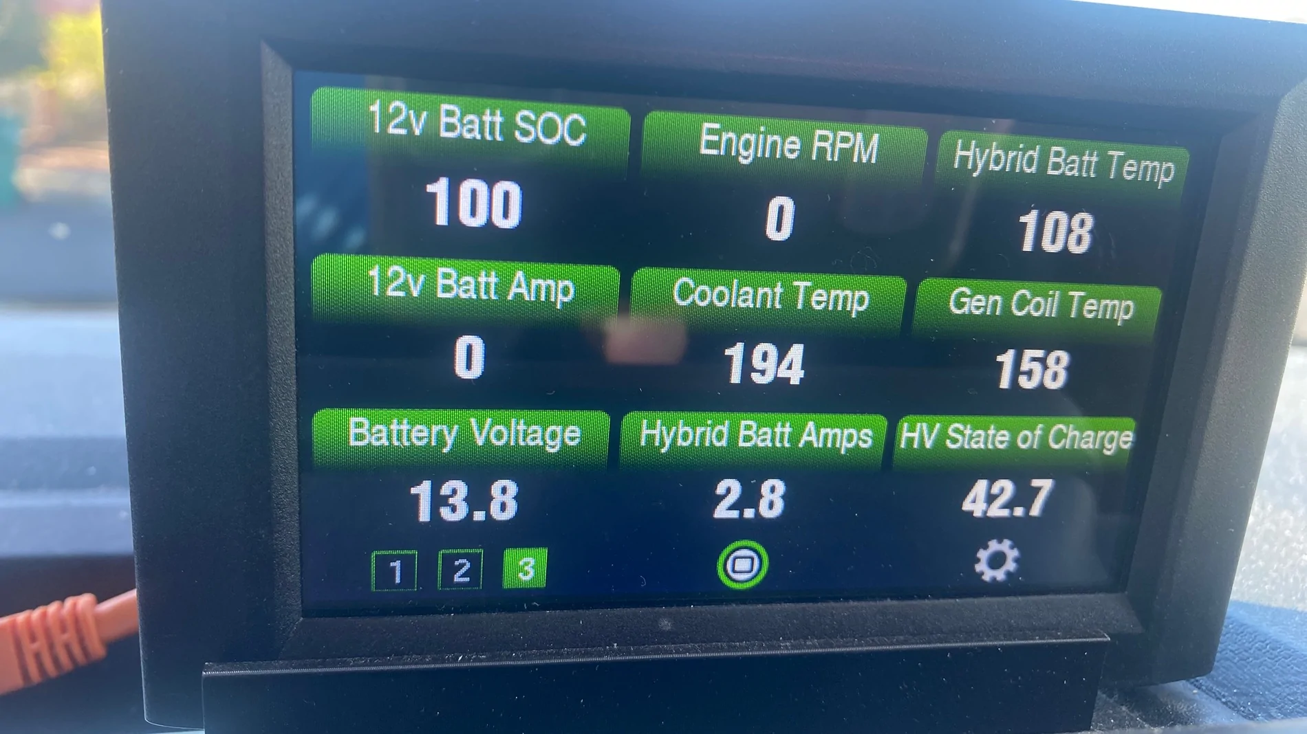

I'm getting some massive drawdowns after parking in my garage randomly. Not all the time, but it does happen. When I park I always turn off HVAC controls before turning off the vehicle. F11 is in and ATT service is excellent here.
You can see it on June 10th, 12th, and 13th. Without these massive drawdowns the battery would be great. My warranty runs out in Sept and apparently Ford will charge shop time to apply a fix (terrible customer service) so hopefully they figure it out before then.
Pull fuse 11 and repeat.
Post what happens or doesn't happen.
