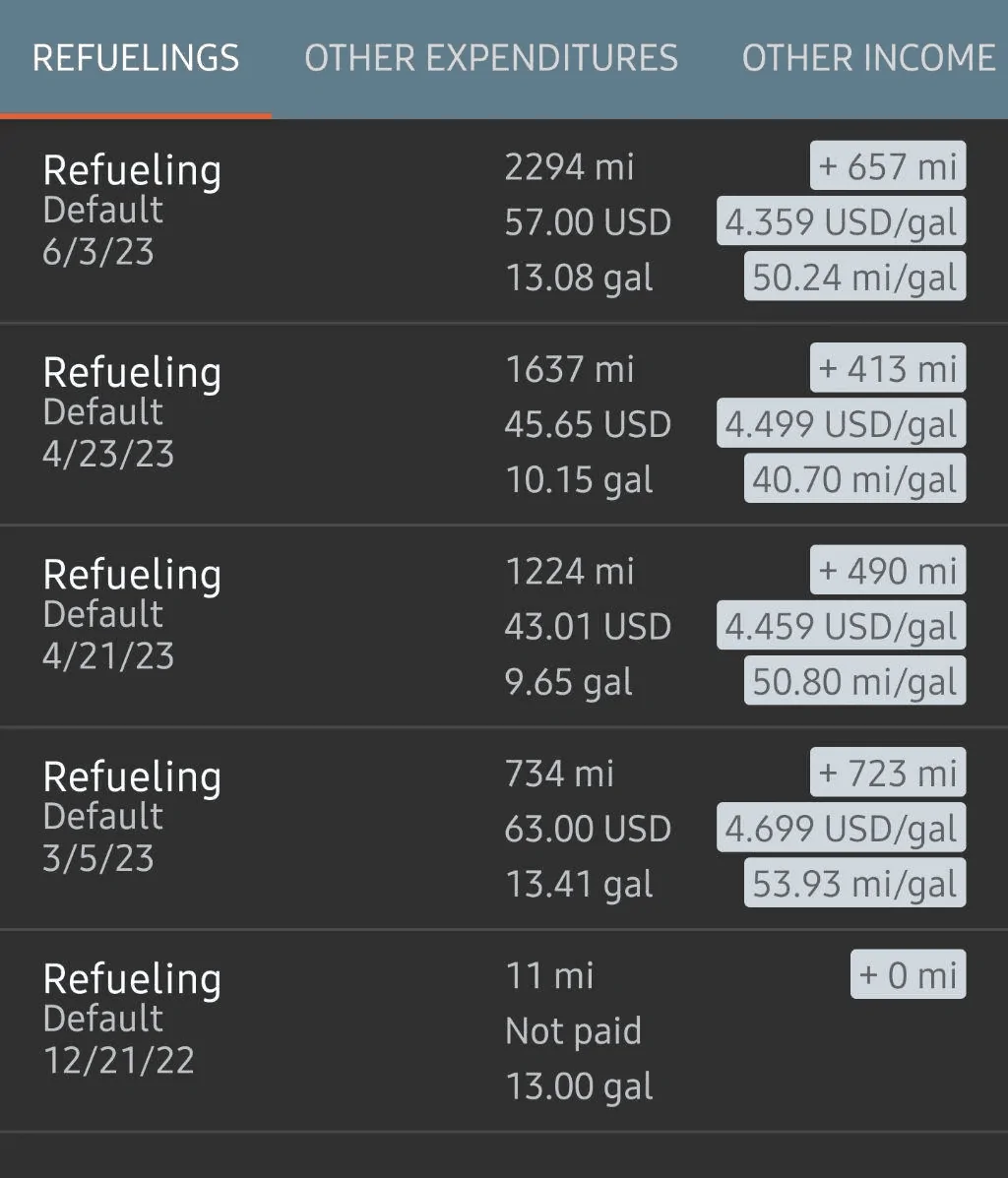

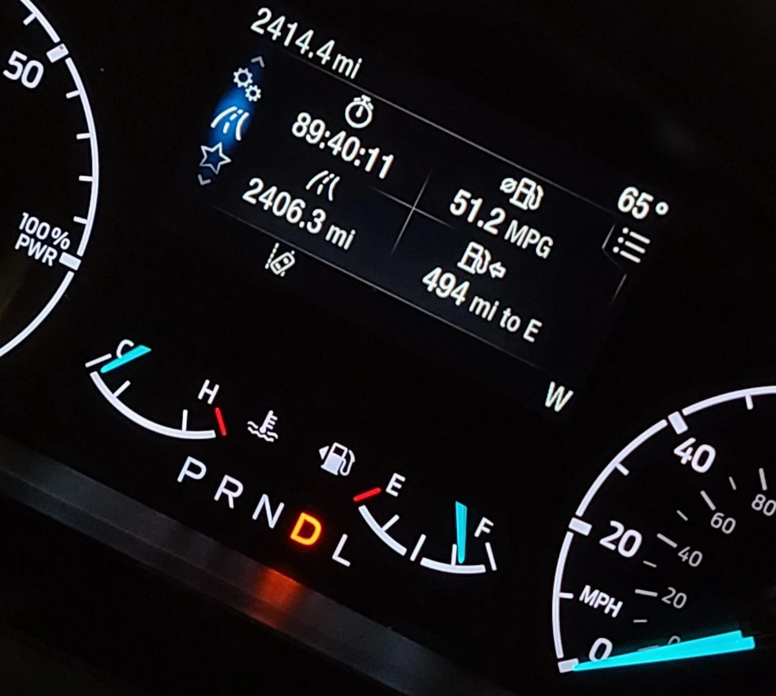

Overview
This document details the strategies I have utilized to average ~51 mpg in a 2023 Ford Maverick XL Hybrid over the past ~2400 miles of mixed city and highway driving around Southern California.

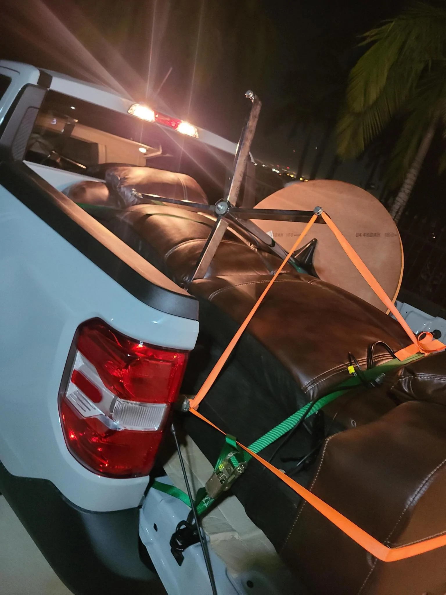

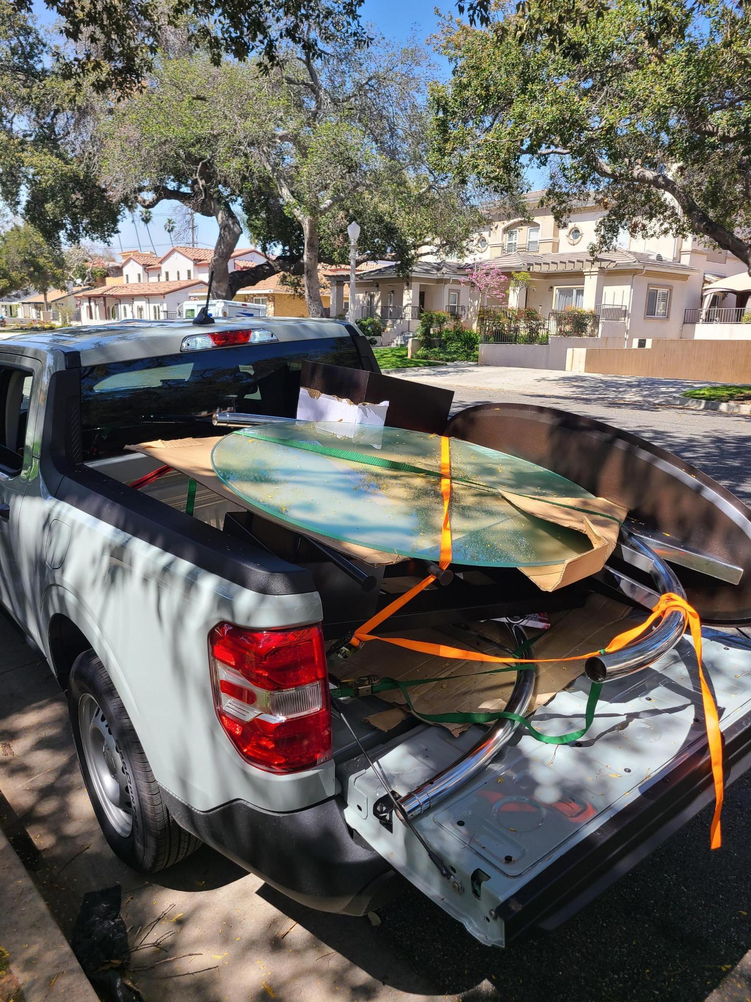

Truck Stuff
To be clear - this is real-world mileage for a normal efficiency-and-safety-minded owner doing normal life stuff with no special equipment. In these 2400 miles I've moved two apartments worth of furniture and belongings, hauled bikes more times than not, drove to my friend's wedding in the mountains, gone camping with three passengers and a full bed, etc.
