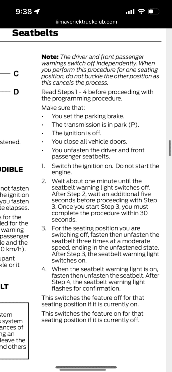

I've tried every one of these ridiculous combinations and NOTHING works. I have a few issues that I need looking at the first oil change, I'm just going to tell the dealer to turn the damn thing off. I must have at least an hour invested in this nonsense an hour of my life I will never get back.
