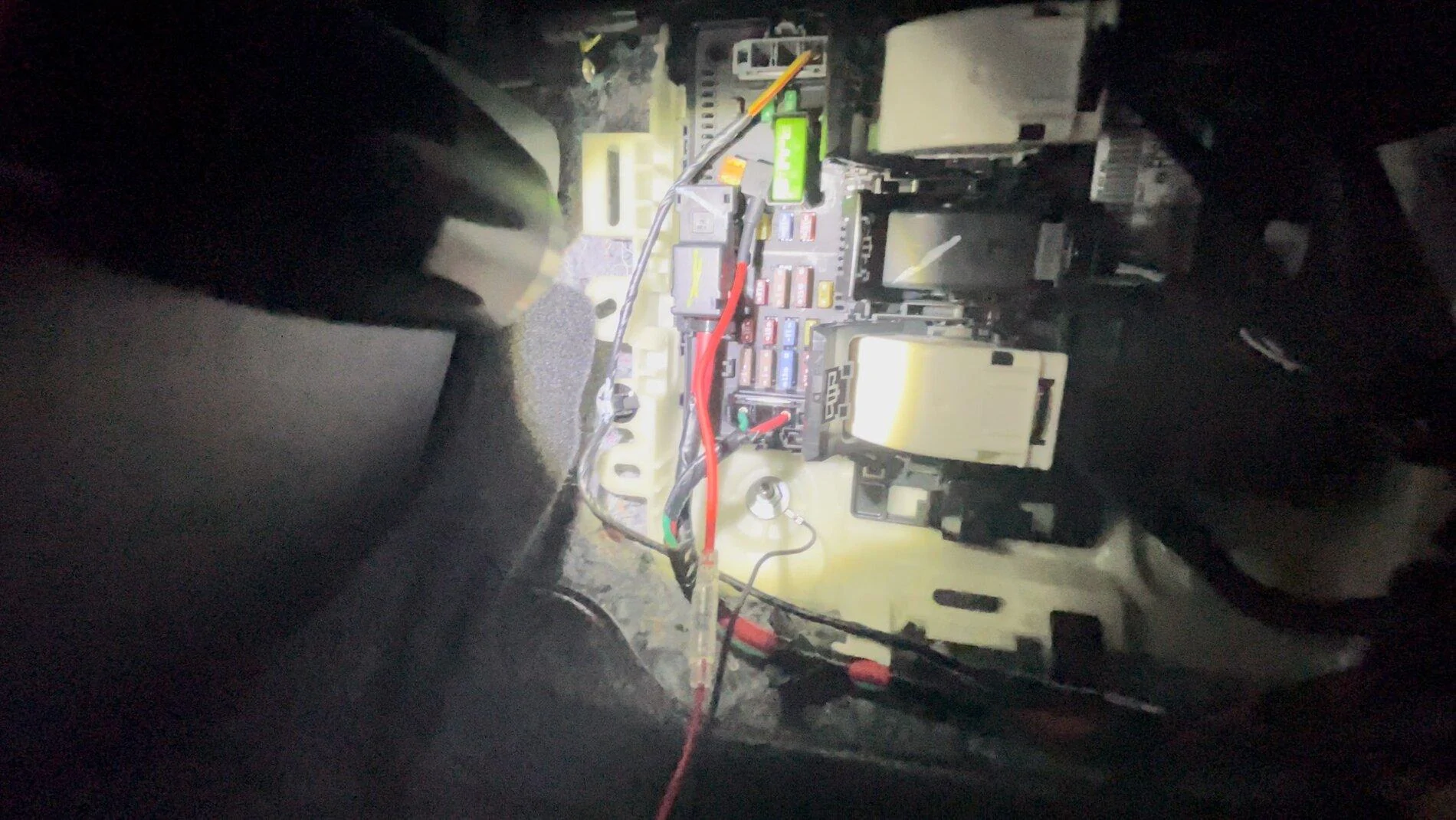

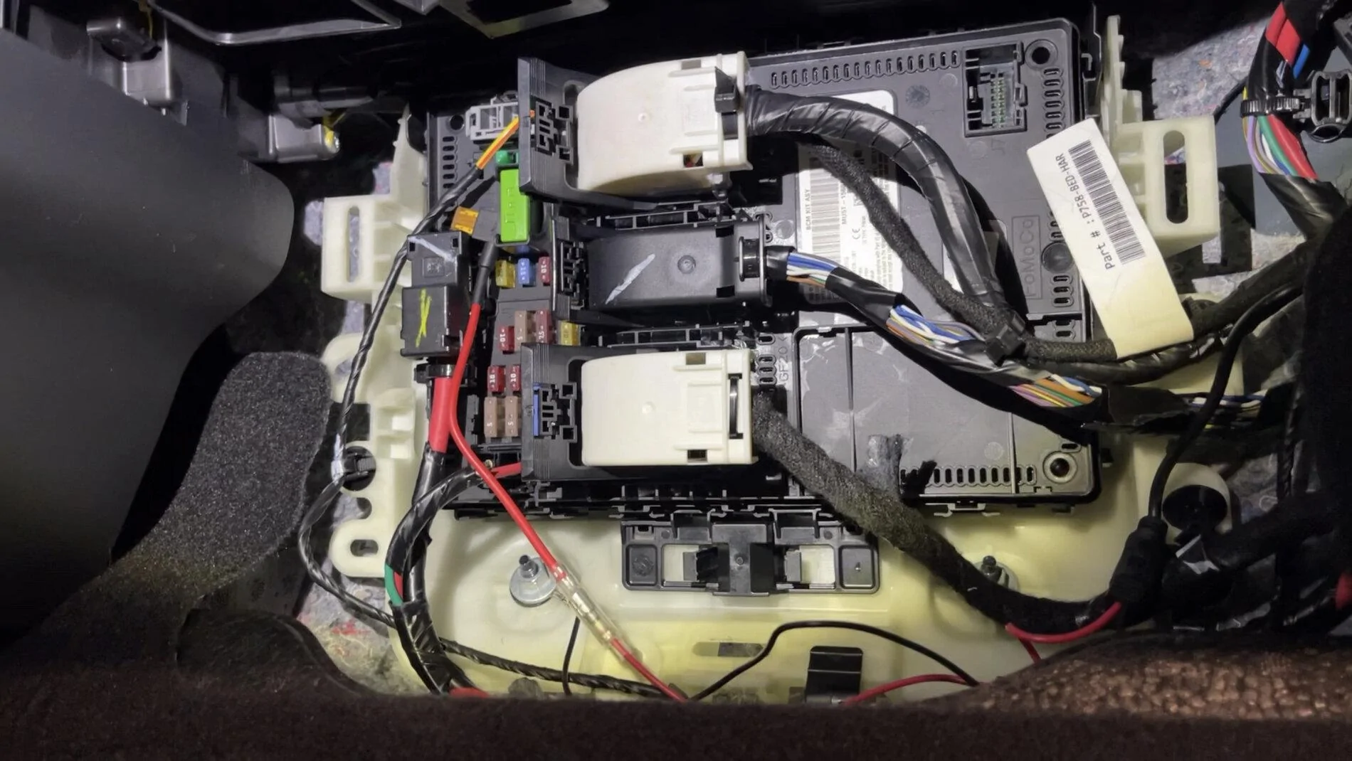

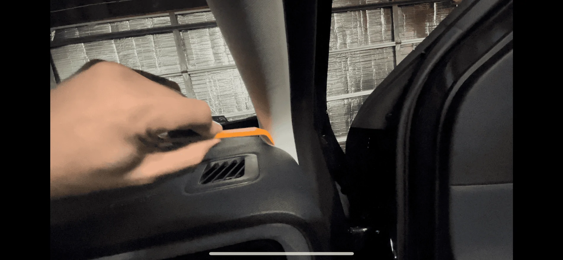

Whether you are looking to install a dash cam or radar detector, I've found this to be the "cleanest" install. Hope this helps for anyone looking to do the same.
Option A- Will show an easy solution to run power directly to the battery.
Option B- Will utilize the accessory power.
The fuse relay that I used was #6. This is the same fuse used for the DC Inverter, Sun Roof, and Rear Power Window.
