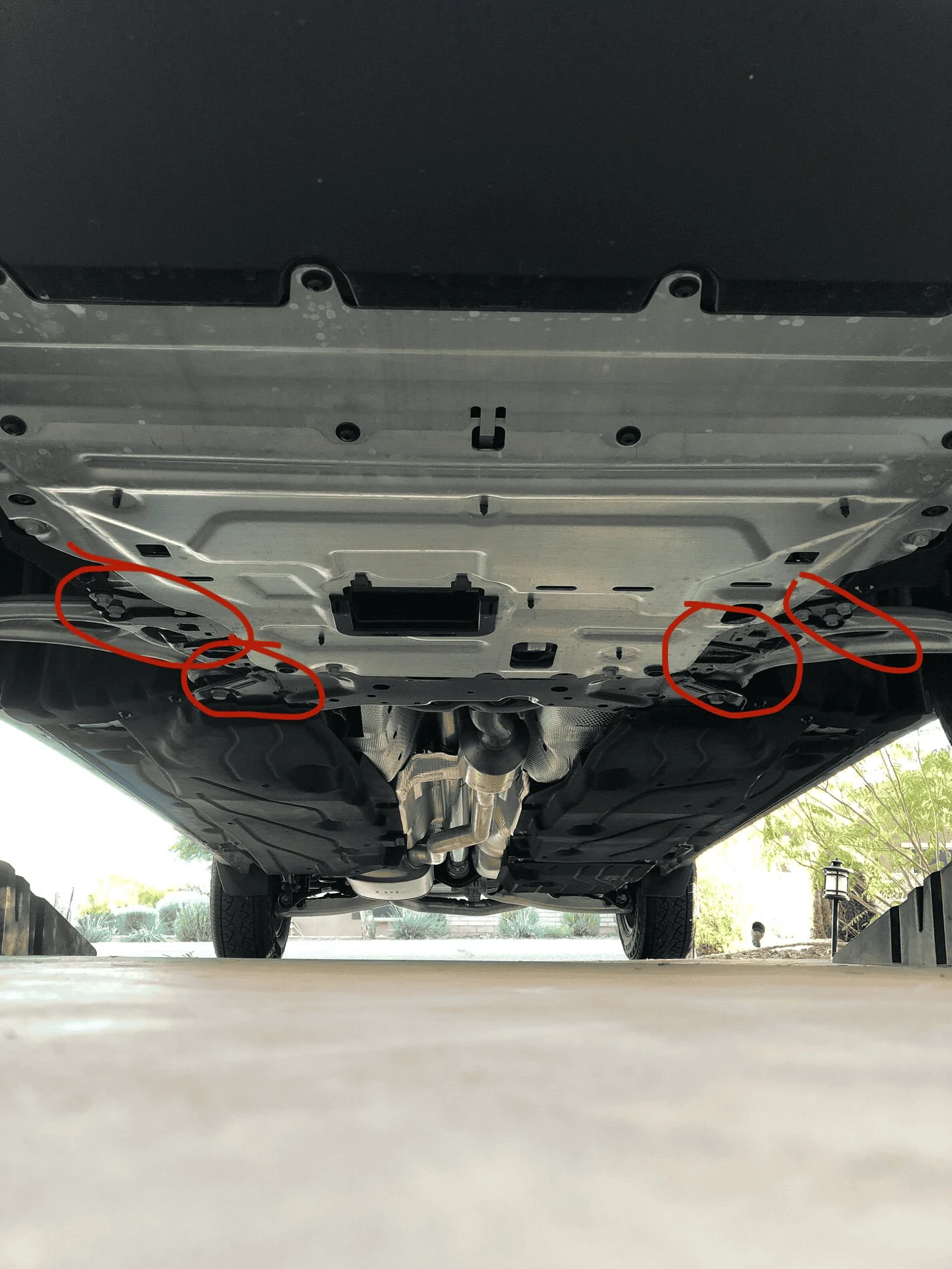

I just lifted my truck up to change out the stock tires. I used the red circled locations (earlier in the post) to jack the front with a floor jack, No problems whatsoever!. The rear, I put the floor jack under the silver arms near the rear hub (can see them is the same photo as the red circles) also had no trouble with that location. The OP could raise the vehicle from those locations and put the jack stands under the pinch welds. There is a small arrow on the black plastic showing the location on the pinch weld to place the jack or jackstand. I hope that was clear enough.
Ford Maverick how to jack truck to put it on jack stands. 1686079371650

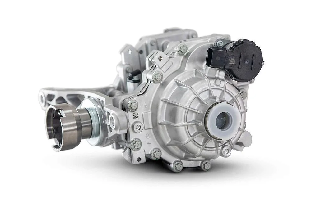

Personally l would never lift using the differential pumpkin because many are made of stamp steel instead of cast metal now days . use slotted rubber puck on hydraulic jack using pinch welds .
That don't look stamped to me...
Ford Maverick how to jack truck to put it on jack stands. ford-bronco-sport-maverick-dana-twin-clutch-rear-drive-unit
:p That's cause no one makes a differential housing out of sheet metal. The standard diff covers, sure, but you don't lift anyhting by the cover anyways. No one makes a carrier case out of anything that would flex from just a jack as it's fail under load long before lifting it could do any damage.
