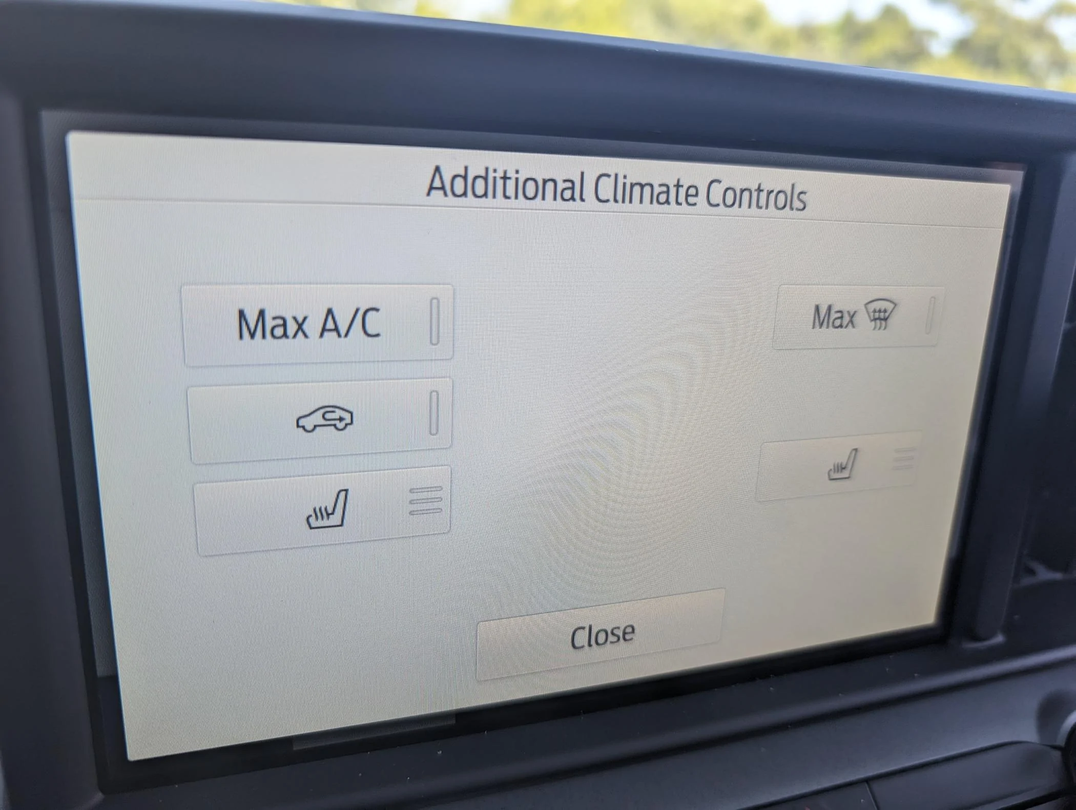

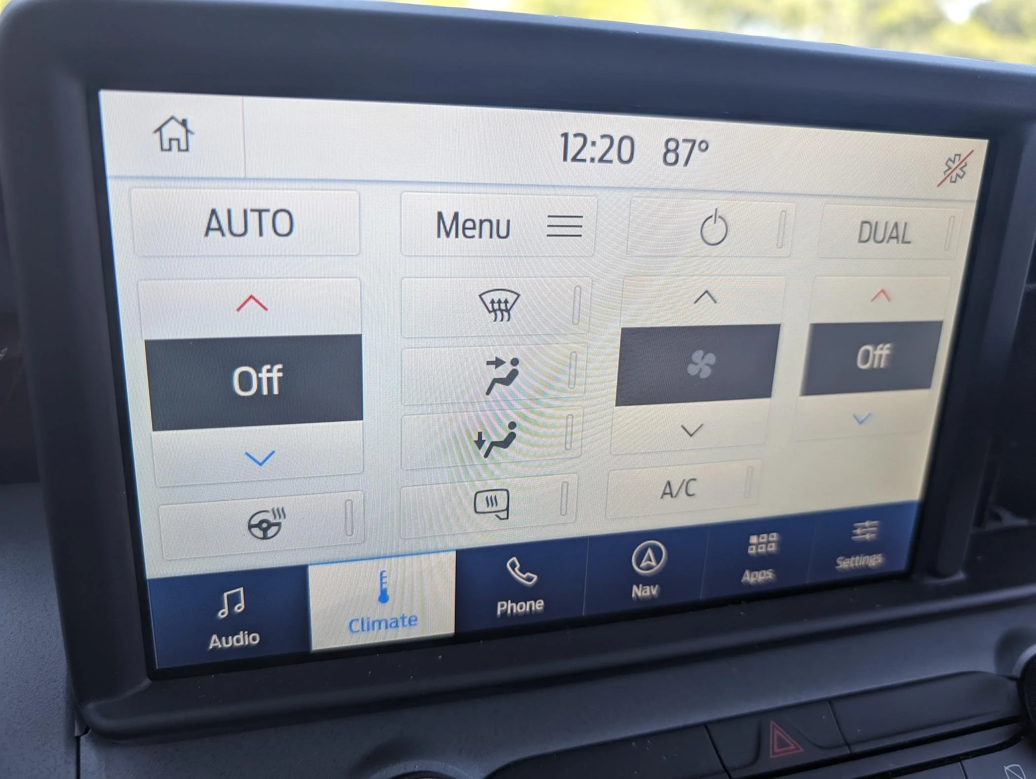

This should enable full featured climate tab on touchscreen.
I did not create this procedure, I am only documenting other's work.
As always, you should back up module and only try this at your own risk.
Apparently this only works to program while vehicle is running. Most modifications in Forscan use vehicle in acc mode, this one requires running.
In APIM Module
Enable:
Climate Overlay - Dual
Climate Overlay - Max AC
Climate Overlay - Max Defrost
Climate Overlay - Mode
Climate Overlay - Power
Climate Overlay - Recirculation
Climate Auto Seats
Heated Steering Wheel Icon
Seat Button Icon - change to 'Heated Seats'
Write and restart.
I have all those enabled, vehicle running, and I do not get an extra tab. Of all the FORScan both on my MAV and F150. This is the only thing that's not working.
