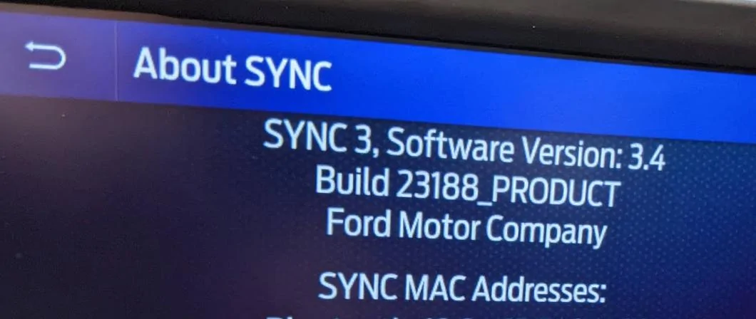

I'm pretty sure I have the latest Sync 3 firmware at least. The files I have on my USB stick are from late November.
Downloaded again and maybe see if I can get it to update again.
Ford Maverick Forscan Ideas for Dummies (Things You Can Do Using Easy Mode) imag
Reran an update and the system said it updated, but still on Sync 3 3.4 Build 23188_Product afterwards and Forscan still showing the weird screen.
Tried the latest build @Old_Norm linked and still seeing the same thing...

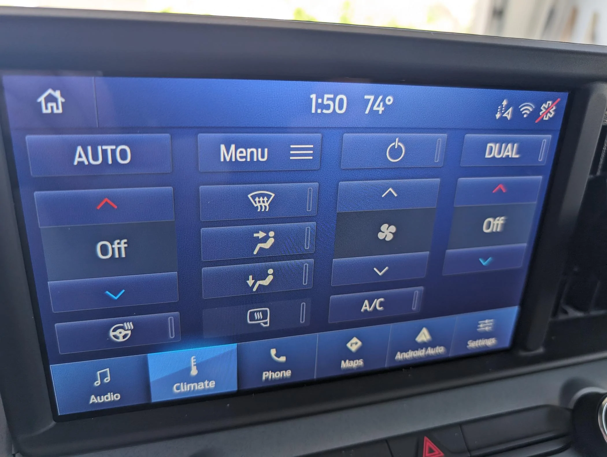

What all did you change in forscan?
This should enable full featured climate tab on touchscreen.
I did not create this procedure, I am only documenting other's work.
As always, you should back up module and only try this at your own risk.
Apparently this only works to program while vehicle is running. Most modifications in Forscan use vehicle in acc mode, this one requires running.
In APIM Module
Enable:
Climate Overlay - Dual
Climate Overlay - Max AC
Climate Overlay - Max Defrost
Climate Overlay - Mode
Climate Overlay - Power
Climate Overlay - Recirculation
Climate Auto Seats
Heated Steering Wheel Icon
Seat Button Icon - change to 'Heated Seats'
Write and restart.
