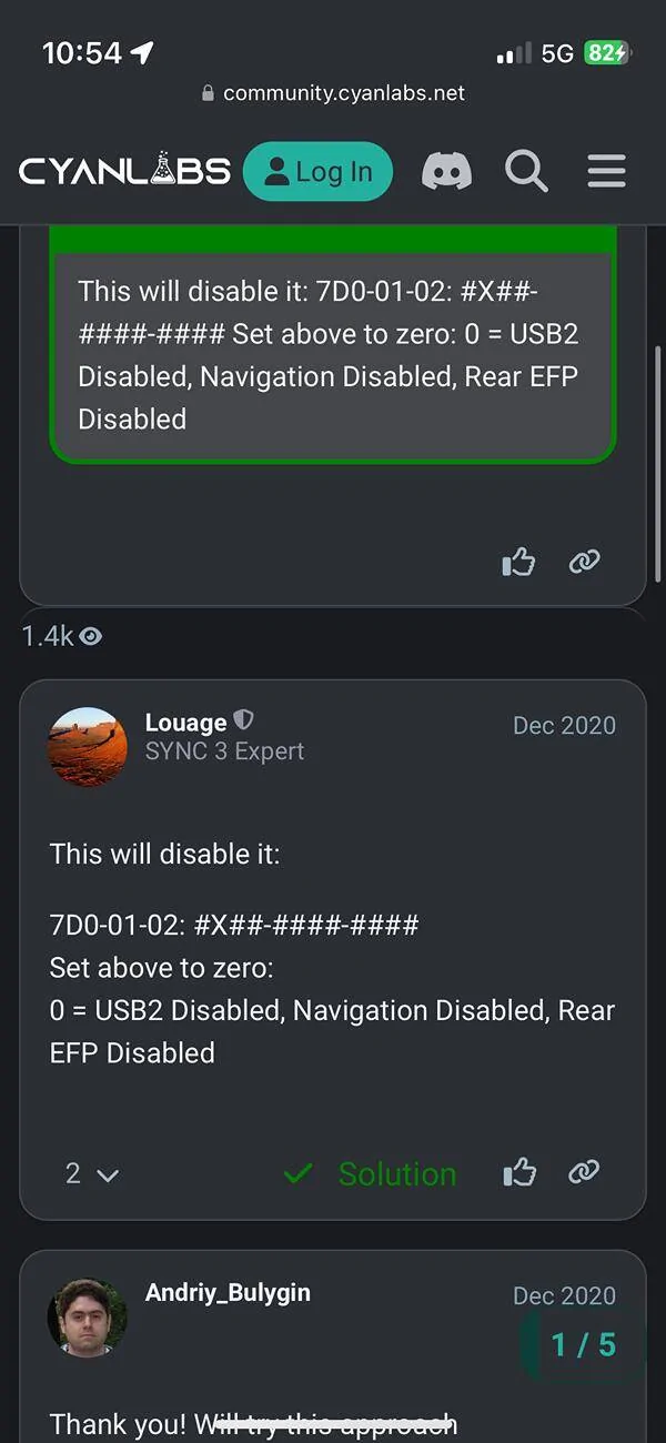

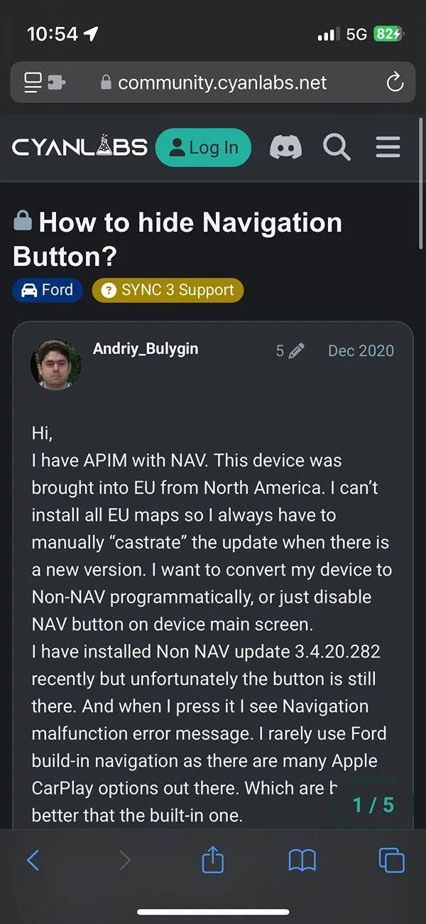

I ask because in my 17 sync 3 Mustang premium, I had the navigation tab on there; and I disabled the nav option in forscan, and it removed the entire option/button away from the screen, which was perfect because I only use iPhone maps.
I know 25 is new, so people prob havnt done it. But is it possible on 22-24 models? It was one option disabled if I recall, can prob find where it was located module if I search mustang forums
There was no issues, no anything otherwise other than it now disappeared from the screen
Google first hit shows other people doing same old sync 3.
