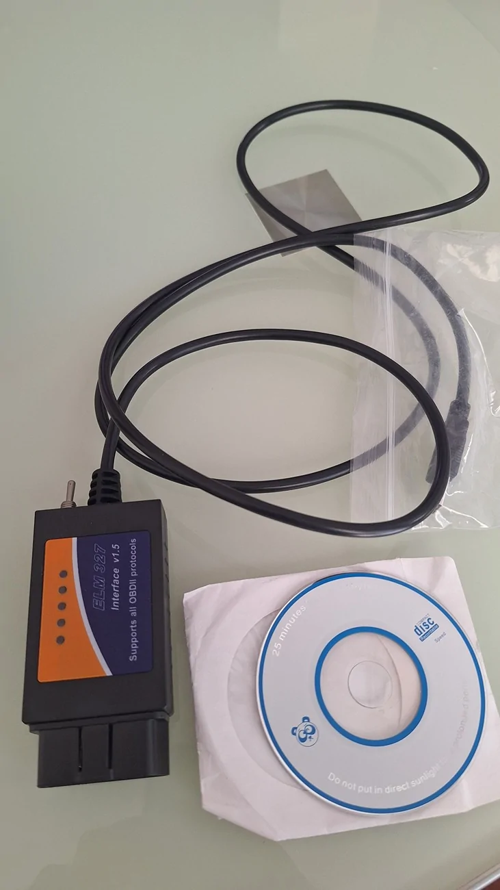

So I went to San Antonio
While I was there I ordered the OBDII port conector...
#yay
Where can I start with ForScan

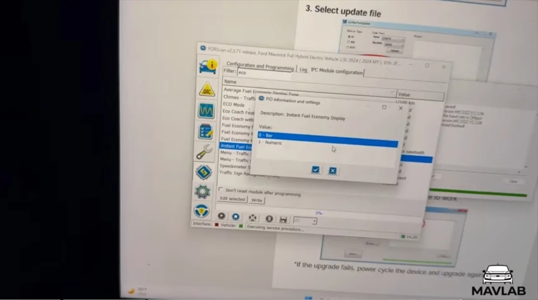

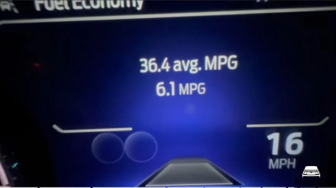

I'll share one I found on YouTube:
IPC Module Configuration
Instant Fuel Economy Display
0 - Bar (factory setting)
1 - Numeric
Now you can see actual fuel economy data while steady state driving at various speeds or drafting various vehicles using the different distance settings on ACC.
