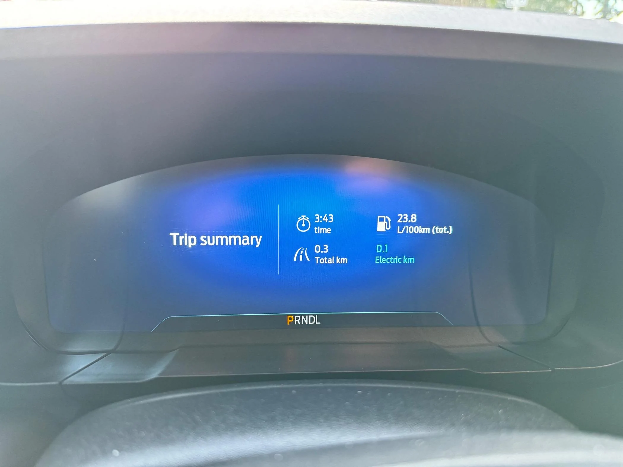

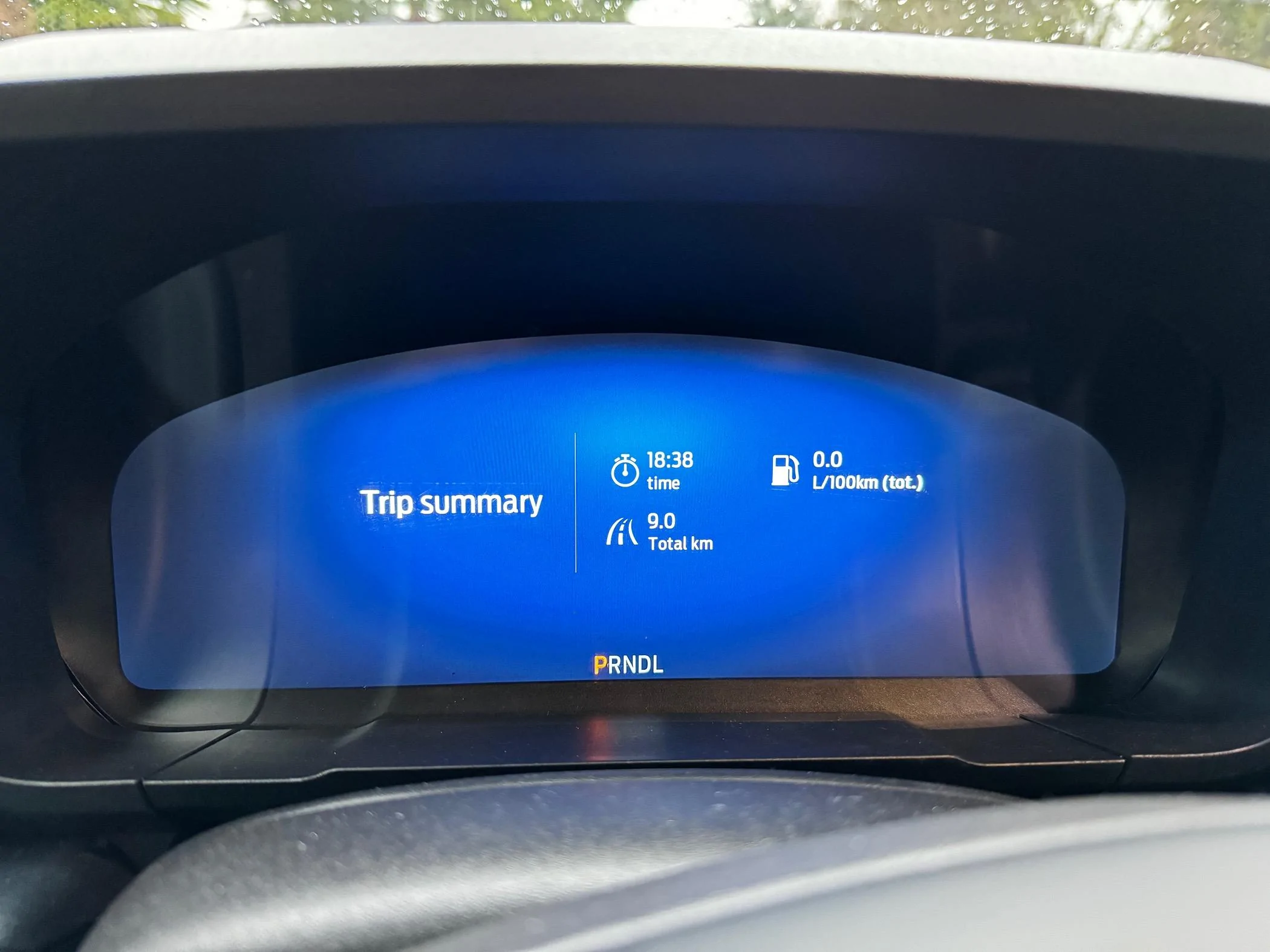

Thanks for everyone’s work on this. I was able to get tsr, eco coach and the ST splash screen working on my 23 XLT lux.
with the eco coach screen it says I get 0.0 mpg when I’m done driving. Is there a way to get actual numbers there?

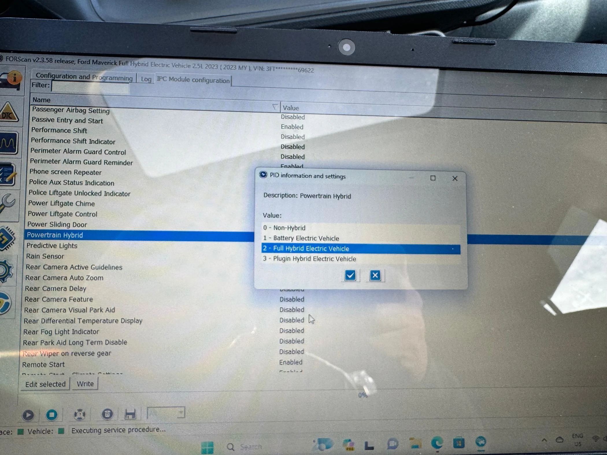

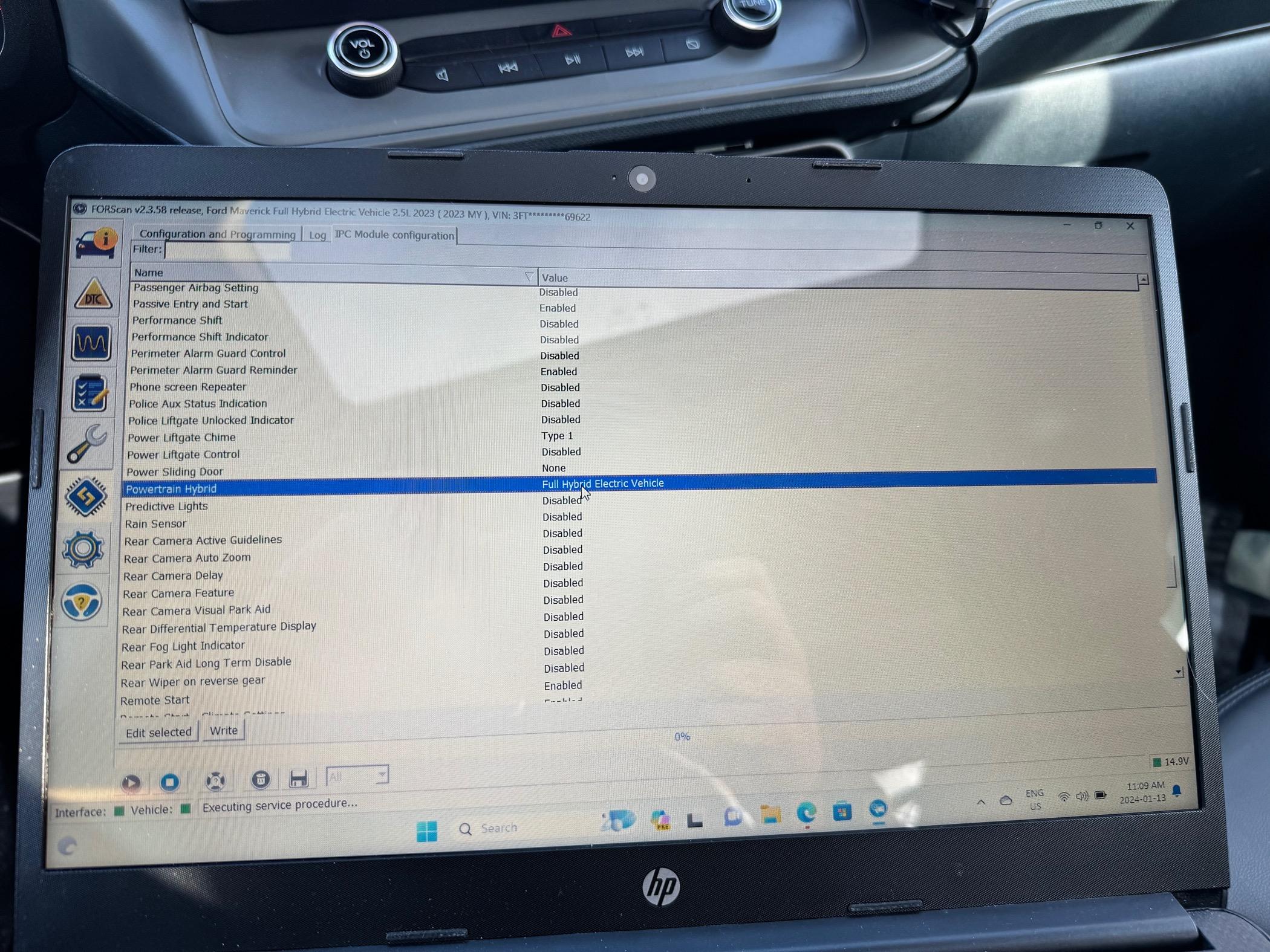

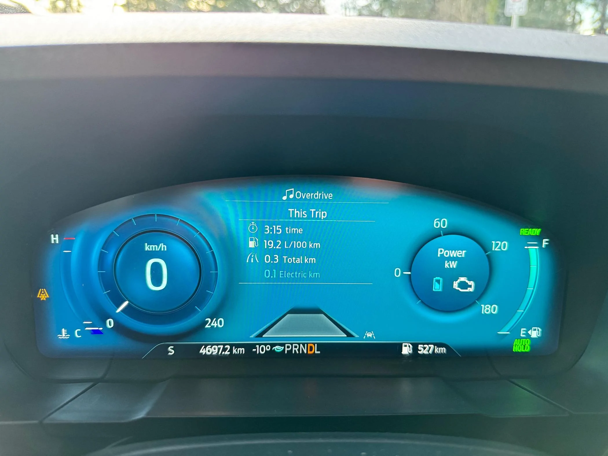

Not sure if this is what you meant but , I had to change my vehicles IPC Powertrain Hybrid setting from non hybrid to full hybrid electric vehicle for it to report the correct information including ThisTrip and in the summary.

My MY24 hybrid was already set at FULL ELECTRIC HYBRID so this did not fix my 0 MPG issue. Next I will try the suggested "see if eco coach works without enabling "eco coach with efficient drive mode"
