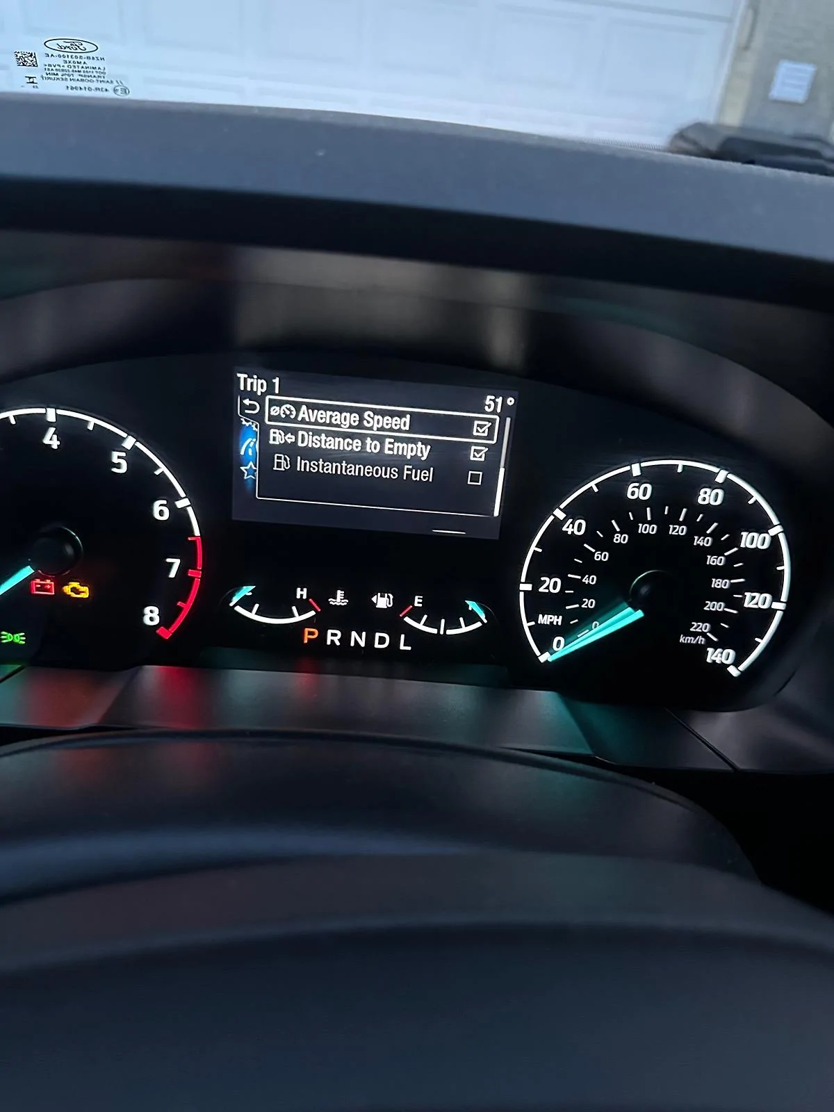

Hey @Toinky I have another easy mode change you can add if you want!
Average Speed Display
IPC
Enable Average Speed Display
With this enabled, now you need to enable it on the Maverick's dash. Go into the Instrument Cluster's trip menu under configure view and click ok on Average Speed (Trip Menu can only track 4 things at a time). Not sure how useful this is but now you can track your Average Speed in trip 1 or trip 2!

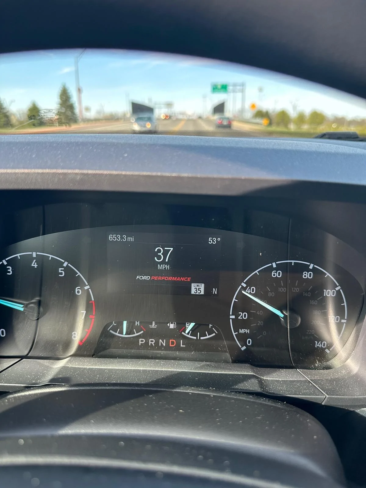

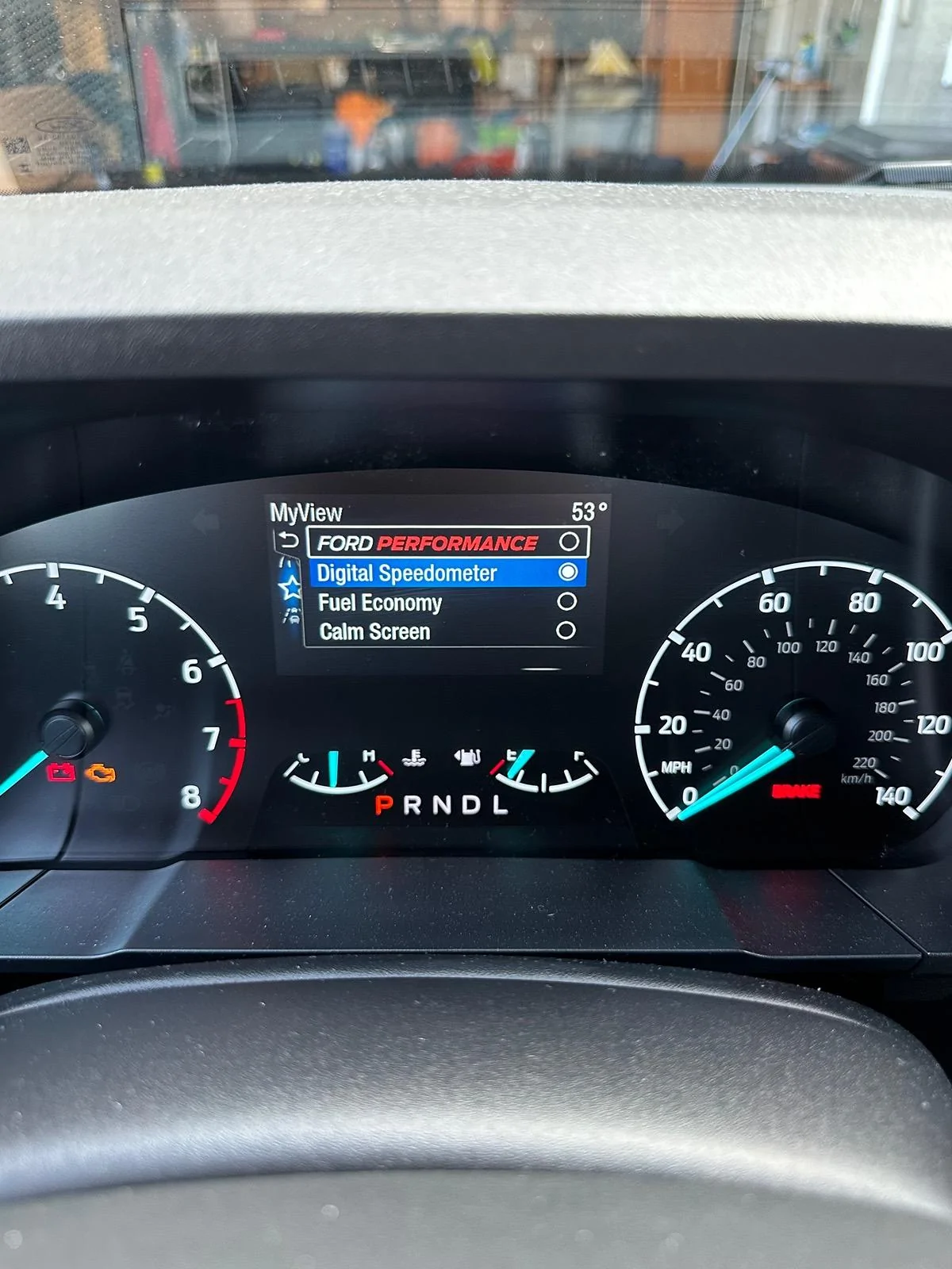

Here is a link to a thread I made for this CODING FIND

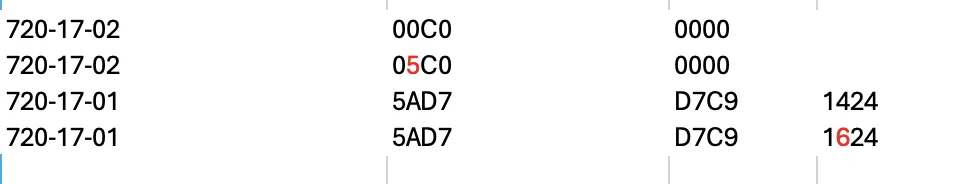

I just found a coding to enable the Ford Performance MYVIEW digital speedo on the 4 inch instrument cluster. I also found a coding to make it your default MYVIEW screen so you don't have to keep switching back to it every time you go for a drive. ONLY WORKS FOR 4 INCH CLUSTER!
ENABLE FORD PERFORMANCE MYVIEW
1. Open IPC AS BUILT
2. Go to 720-17-02
3. Replace the second digit with a "5" as shown here
x5xx-xxxx
4. Write the changes and let Forscan correct the checksum
MAKE FORD PERFORMANCE MYVIEW DEFAULT
2. Go to 720-17-01
3. Replace the tenth digit with a "6" as shown here
xxxx-xxxx-x6xx
Here are some pictures of this screen and a picture of my original coding compared to the new coding!
IPC
I added it to the original post. Thanks!
