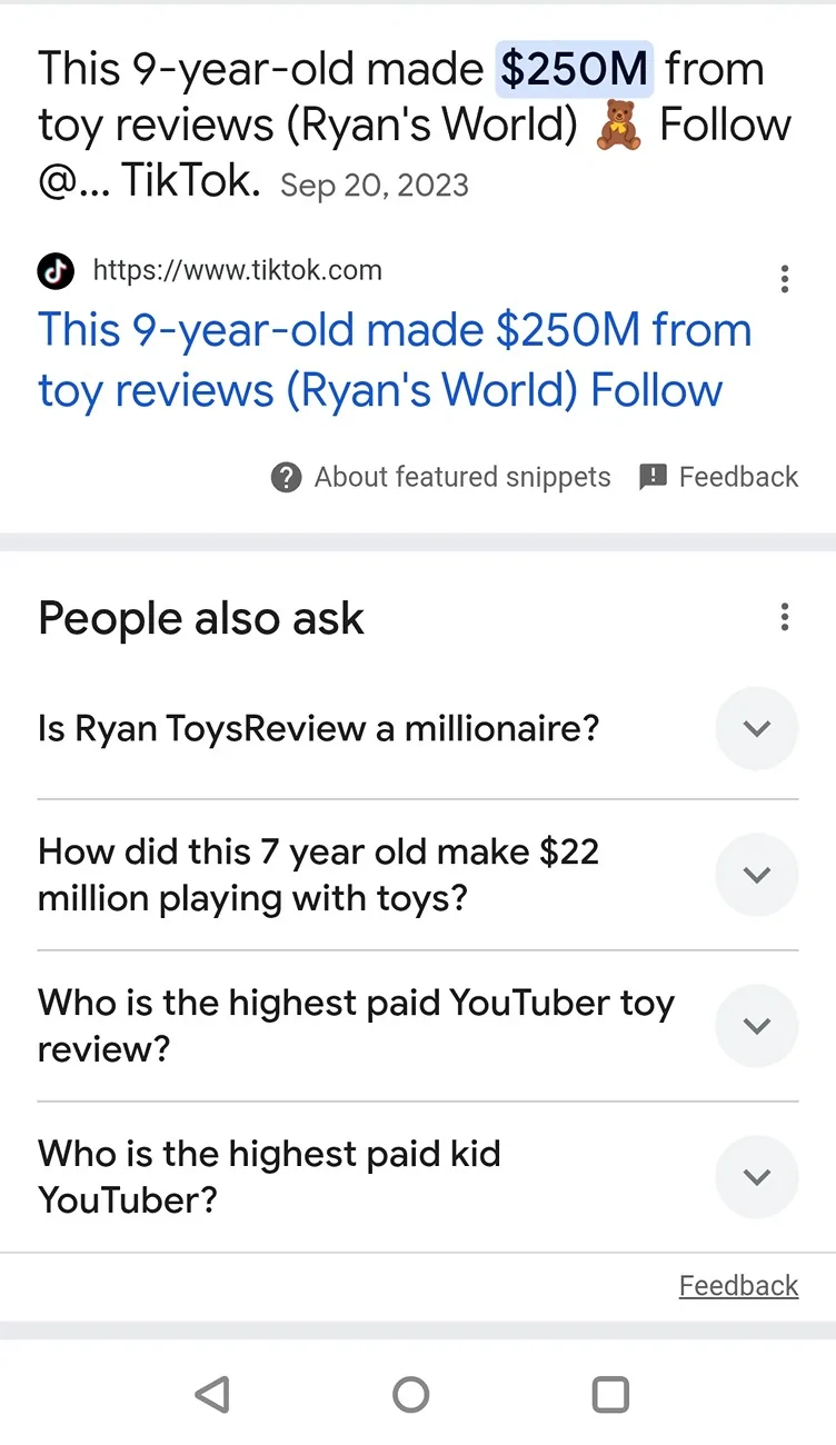

Every young man is doing social media now "influencers"
They don't wanna to work anymore
What is the incentive?
With several monetized social media channels. "Content creators"
A male can make $18,000 a month. A female more.
Here's an extreme case. 👇👇
Ford Maverick Ecoboost runs 5 seconds and shuts down - rodents chewed through wires Screenshot_2025-09-18-20-25-51-45_40deb401b9ffe8e1df2f1cc5ba480b12
